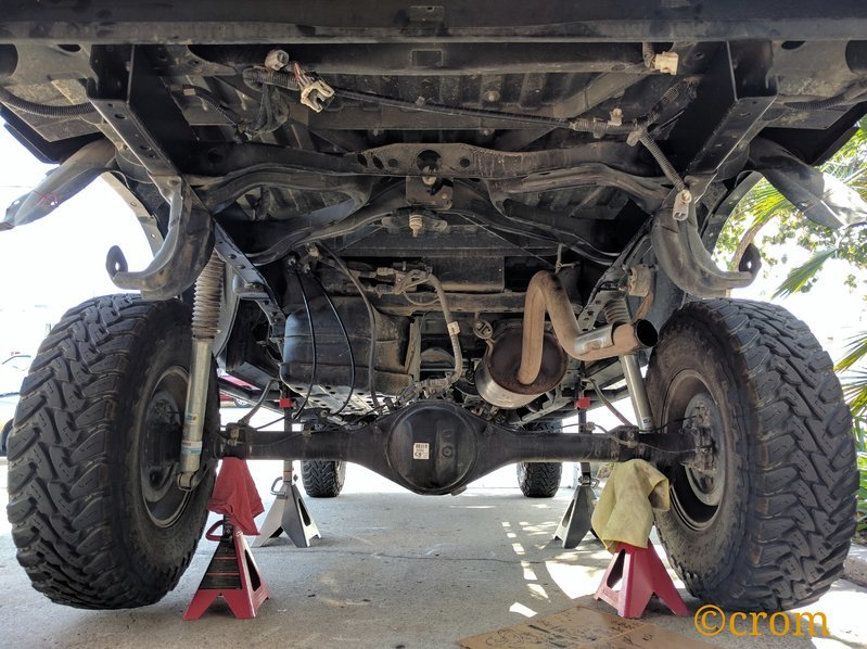

    Rear frame plates have been installed; rear is boxed in.
    Frame plates add strength, stiffen the frame, and help stop torsional twisting.
    I am an opportunist, and having the rear end exposed, I again tapped Jeff @jeffz0rz , Owner and Operator of JTA Metal Works in El Cajon for help.
    He offers CNC cut frame plates for 2nd gen trucks. Here is the discussion thread on it.
    Here is the description:
    I needed to retain the stock spare tire carrier cross member, and the bed had to stay on the for the work. I meticulously cleaned the frame, and removed my air-line, and all the frame wiring harness clips in advance, to get everything out of Jeff's way.
    Jeff divided the plates into 3rds and burned them in. Jeff did a great job welding and painting. Any over-spray paint you seen in the photos is mine.
    I'm very pleased with Jeff's work. :thumbsup:
