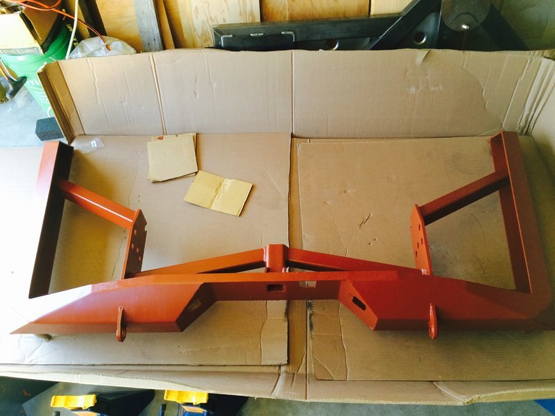

    I asked for options that were all asked for before by other customers. I solicited a lot of feedback from past customers, all who were very helpful and will be given full credit in a future post. That will happen after everything i ordered has been painted, installed, checked for fitment and proper operation and all other outstanding issues fully resolved.
    The options I asked for on bumper was light cutouts, shorten sides of bumper by 2.5". On the gate I asked for the tire carrier to be canted forward, HD lockable latch, fold down aluminum table, dual can holders, hi lift mounts.
    Yesterday I posted the weight for each item in another thread. I'll import that in here in the future.
    It's a gamble. We're playing with geometry. One way to do it right (measure), and many ways to go wrong. Pain in the ass to reconfigure too.
    I gambled...hoping to dive under there and measure this weekend.

    Follow up questions Nick:
    Why shorten the bumper? And why cant the tire carrier forward?

    Additional clearance is just a precaution in case I ever move to 35 inch tires.
    Cant it's just a preference, it looks better to me.
    I ended up ordering the gate because the whole bumper is built around the spindle, and you can't add it after the fact unless you're a fabricator or pay a whole hell of a lot more money. I ordered an extra spindle cage, in the event that I pull the gate off I can protect the spindle. So in a way, I can configure the truck for each individual trip, sometimes I might want the gate on, and sometimes not.
    There is a weight penalty for having the gate, it is heavy and also having the spare tire hanging off like that is going to change the Dynamics of the truck. that's the only thing I'm really concerned about. I guess I'll know pretty soon.

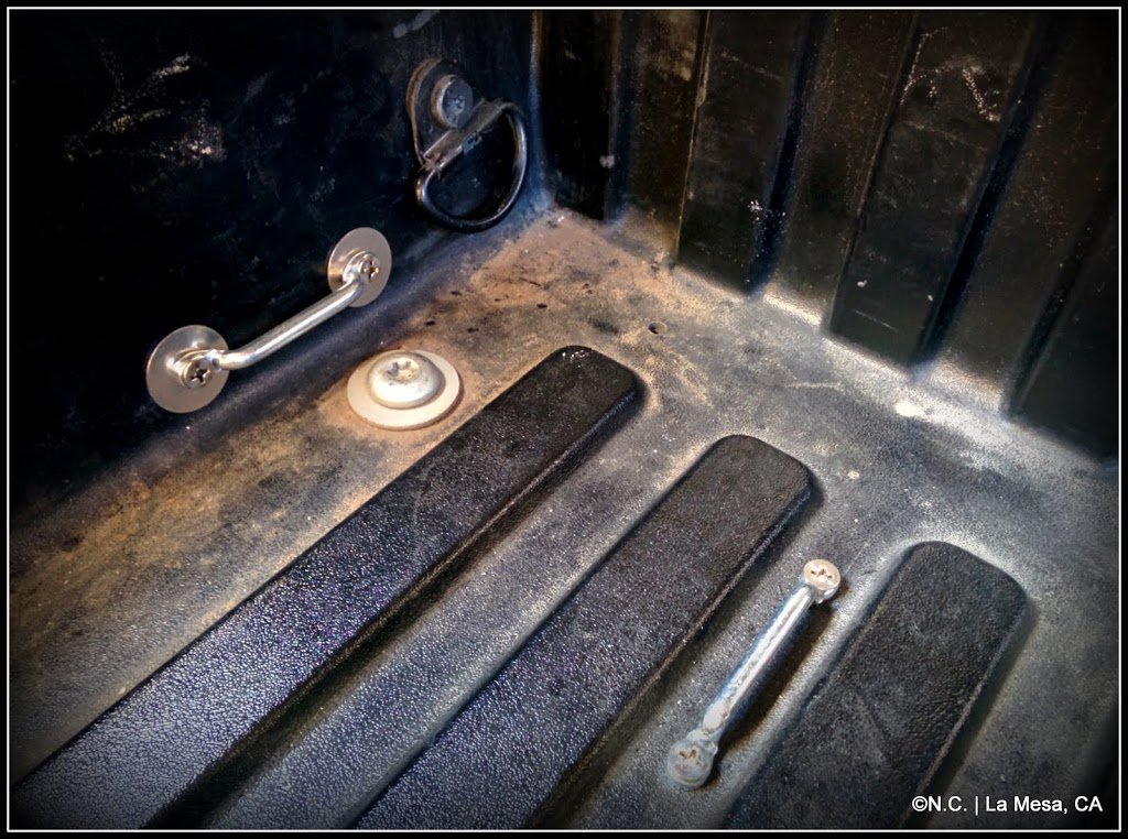

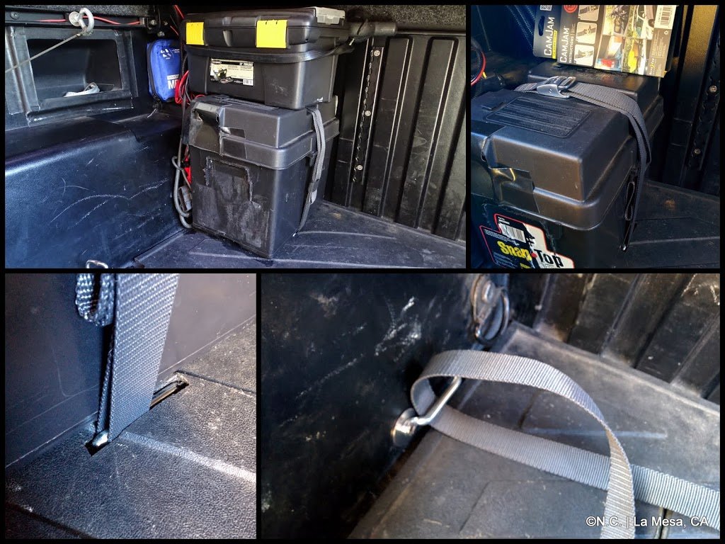

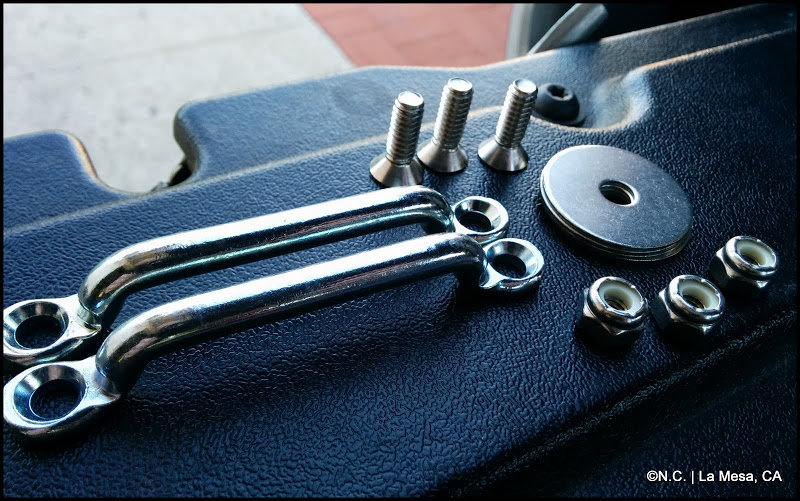

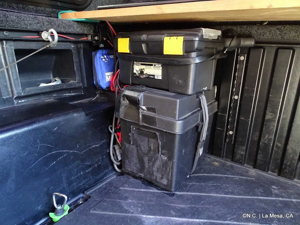

    I was just looking into doing this! Just the washers on the backside/underside? Still going strong?

    Thanks a lot guys. The shop I used was Able Sandblasting and Power Coating in El Cajon. They are a smaller shop, I think I counted 5 employees when I was there for pickup. They did a good job on the PC and two of them helped me mount the bumper in the parking lot! I was so grateful. It was two day turn around time too.
    Yes. All the fasteners are still tight, and battery is still very secure. It's in the photo you quoted, I'm using a product called Cam-Jam for the battery hold down. It was not expensive and features a working load limit of 700 lbs. and break strength of 2,100 lbs :) Works really well.
    Only improvement I could recommend is to use hardened fasteners, like 10.9 metric, or grade 8. I don't know what the stainless is rated for that i used.
