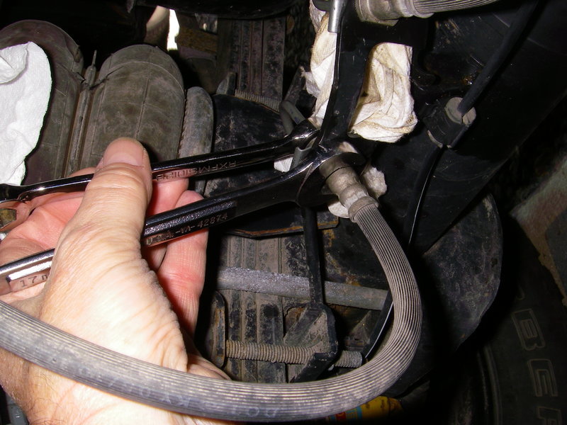

    I'd like to thank the Crom Club for their input:
    Did this for three straight days, 3X per day.
    3/8" still won't fit. Damn flare nut must be 9.8 mm. LOL.
    Tried this. Not enough room in the upper frame rail area.
    Tried this as well. I didn't want to crank too hard and round off the flare nuts.
    I didn't wan't to break anything because of my wheeling trip tomorrow. After the trip, I'll likely go all out and do all kinds of crazy shit to deal with this. Hardlines be damned!!!

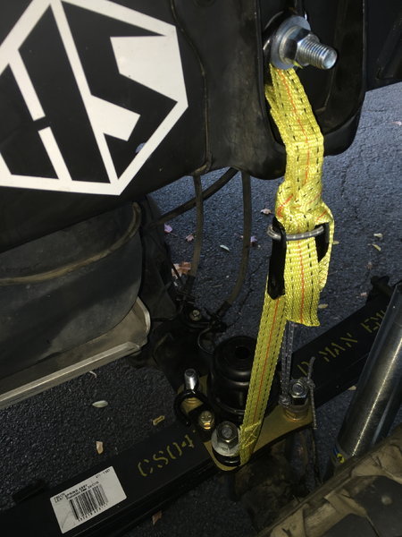

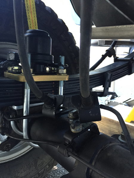

    Did this. Unbolted the brake line bracket and added about 1.25 inches of washers. Also bent the bracket tabs to gain more extendable soft line length and reduce/improve the angle at full extension. Previous angle was 90 degrees. With this emergency "mod" I think I gained a total of 2" with the OEM brake lines.
    Also did this using Cam buckle straps. Both ends had heavy duty hook "eyes." I bolted one end to the frame and the other end to the leaf ubolt. The bungee is to keep the cam buckle from bouncing around and hitting the frame and getting caught between the bump stop and frame. I think it will work pretty good as a limiting strap if I do say so myself :)
    At full extension:
    At rest, with bungee retention/anti-rattle device.

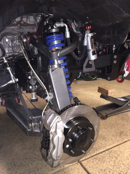

    I'm starting to think this will be my route. I'm having a hate/hate relationship with my brake lines right now.When you get a chance @Evenflow , maybe I catch up with you on how to do this and sourcing of the parts?

    I applaud the DIY effort but that strap is going to break buddy. That is a single ply strap and if you look at real limit straps they are made of a much stronger material and generally 4 plys thick...and they still stretch. Straps should be 4 ply and double shear mounted on both ends.

    ^ I agree.
    @Subway4X4 Search Amazon for "Axle strap" less than $10 each (not real limit straps, but would work for your immediate trip)
