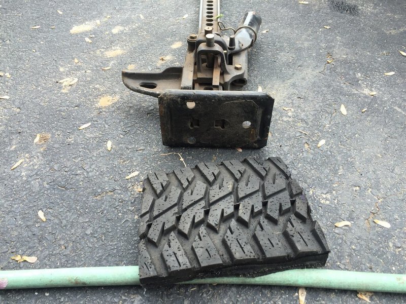

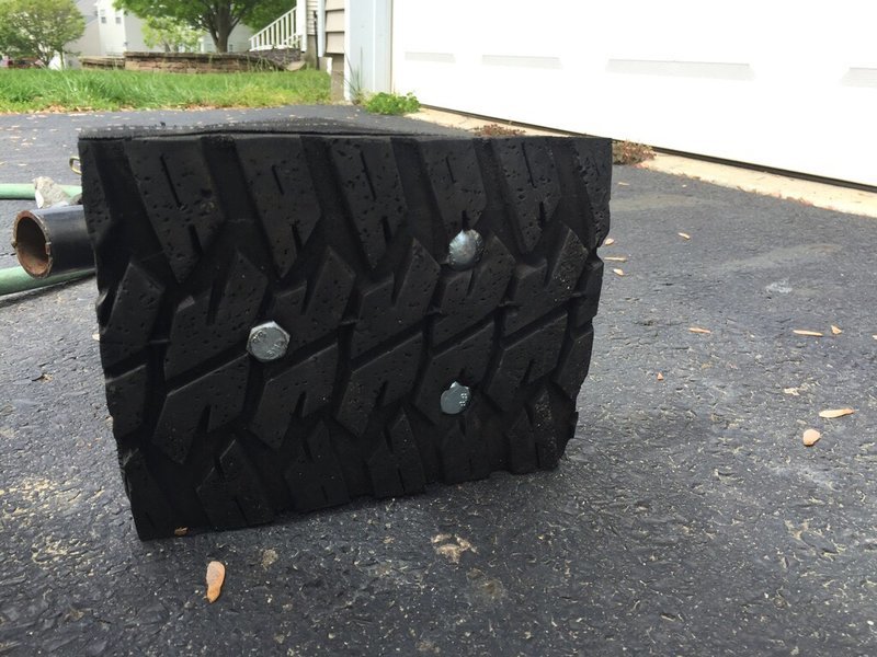

    I used a scrap piece of my MT tire to do this:
    Got those pictures as well as the idea from @geekhouse23 . Gives the base more grip on smooth surfaces (concrete, asphalt, etc.). Feels really solid on my sloped driveway. I cut mine a little closer to the jack base because I felt the extra material wasn't doing anything. I have yet to use it in dirt, but I'd imagine it isn't any worse than the stock steel base of the jack. After all, your truck sits on 4 tires while offroad and doesn't really slip too much. If you need one of these let me know. I might have some tire left to cut one out.

    Have you used the tire-base off pavement yet?

    That's actually a pretty good idea.

    I would be grateful to receive a piece of your old MT tire, same size as the foot base please, any size really I can cut it to fit if it saves you time. lol :D
    As far as grip goes, I think it's a great idea. Thanks for the pics.
    Honestly, the vulcanized rubber seems to make the most sense. On any surface I can think of, sans ice, it should perform the best, I would think. I want to try it now. :)
    x2!
    In the past I had considered
    If I need flotation, I have a 10" x 10" piece of 3/4" pressure treated plywood with a hole in it that I pass a carriage bolt through and a wing nut for the hi-lift foot. I think next time I'm out in the sand, I'll try it and see how it holds up.

    If you have one more piece of the tire I'm 2nd in line. That's a great idea. I have the OR base for dirt haven't needed it yet but its the right tool for soft surfaces.
