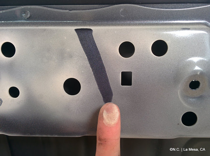

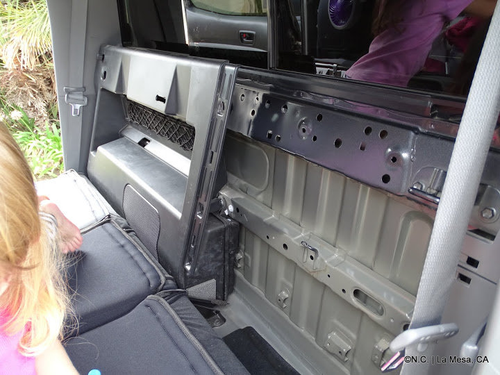

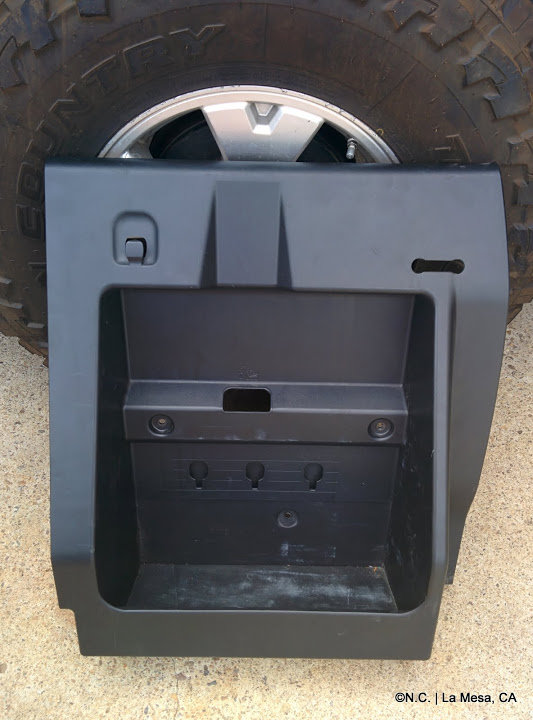

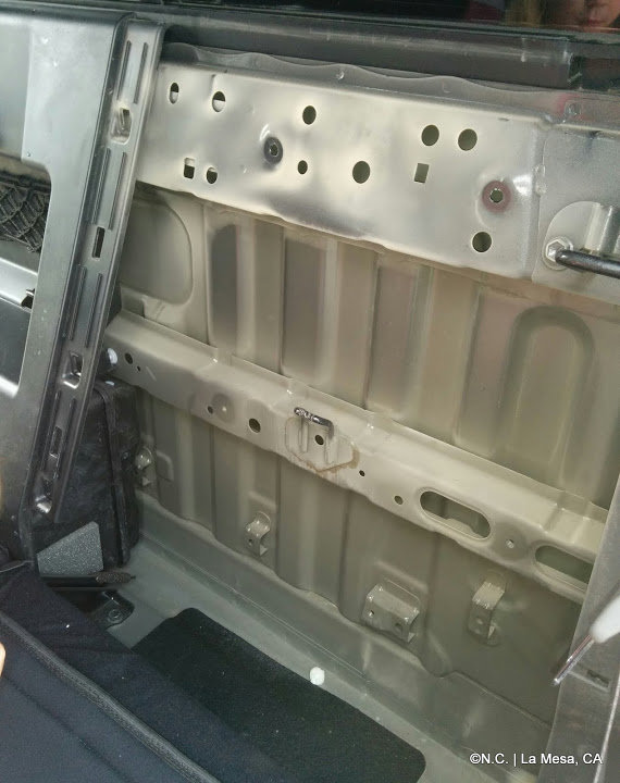

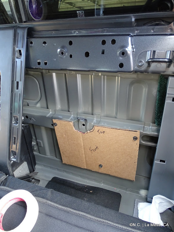

    I need a kick ass air compressor to work with the new 33" tires.
    So today the kids and I yanked out this plastic bin behind the drivers side, rear passenger seat. Three (3) 10mm bolts, and then pull the bin straight out, a bunch of plastic clips holds it in and they pop loose.
    What surprised me was the amount of lunar dust in the cab.
    Micro dust!
    There is a vent which I was unable to find because it's on the passenger side rear of the cab. I tried to get to it, but was blocked by the sub wofer plastic bin which was blocked by the rear seat back.
    I was curious if I might be able to add some kind of filter. I was somewhat limited on time as this wasn't supposed to be a 'project'. I told the wife I was just going to look at something. :D Anyways this was just a distraction...
    The reason for all this was because I want to put an air compressor behind this seat and taking the plastic bin out creates more space to operate with.
    I made a little cardboard template that I can use to later transfer the hole pattern to a piece of aluminum sheet, which I can mount a compressor to.

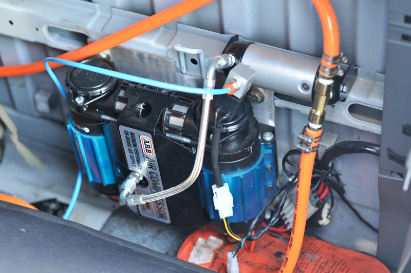

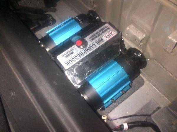

    Look familiar?
    I got the idea from MrGrimm.
    It's possible too to just bolt it to the floor like @CVYota did here:
    As far as air compressors, at the top of my list is the ARB dual, and the Air-Zenith OB2. I'm not planning on running a tank at this time, but might in the future.

    VIAIR makes great stuff, my current compressor is made by them. But all their product offerings in the same class are out performed by the two listed above.
    I need fast performance for this, and I'm willing to pay for it. Wife thinks stopping for 25 minutes to put air back in tires is dumb... And happy wife, happy life, etc. etc. You know the story. :D

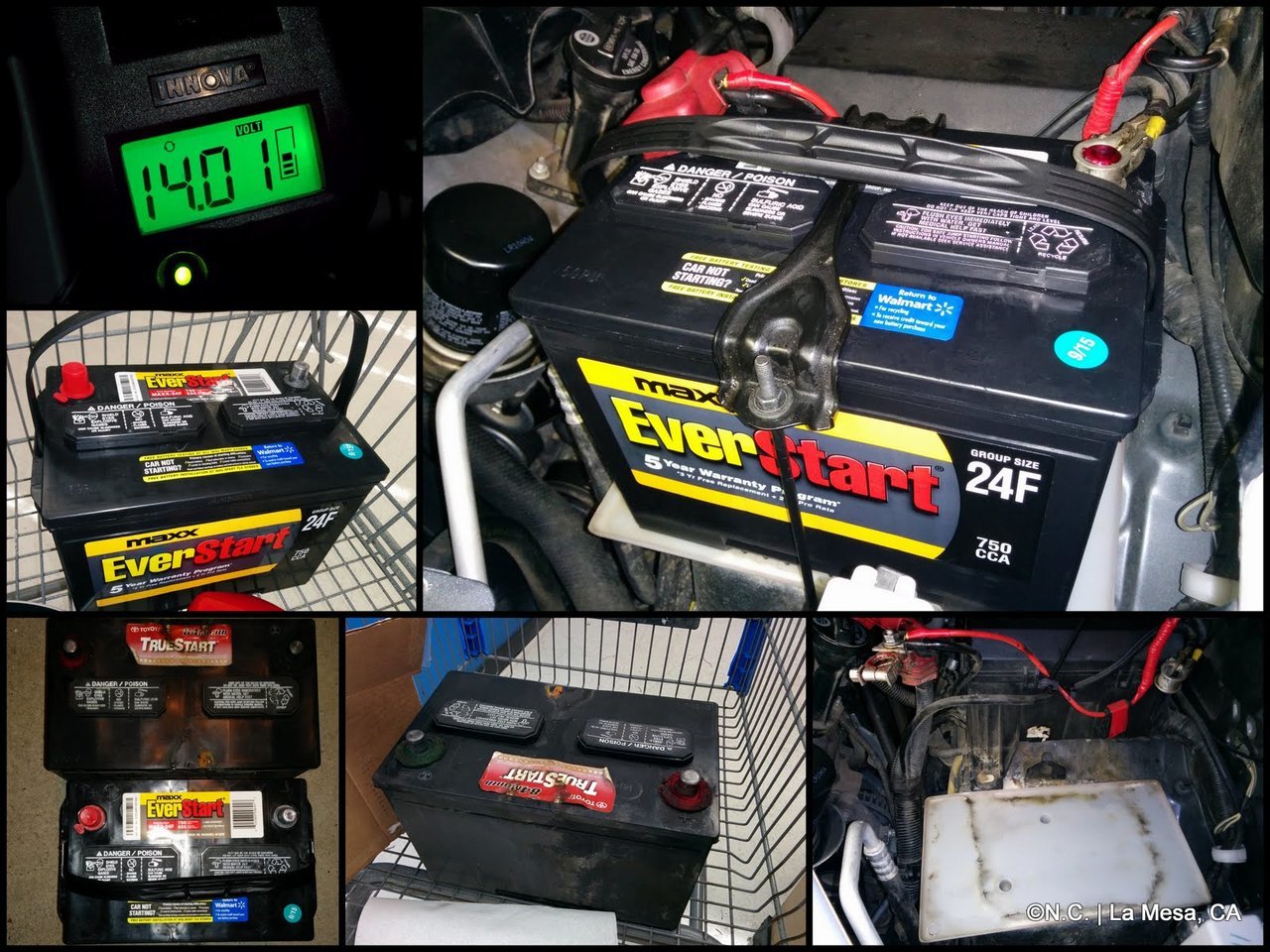

    New Maxx EverStart Battery
    So I got 1,605 days (or 4 years, 4 months, 21 days) out of the stock Tacoma battery which was new to me in 2011 after a warranty replacement of the '09 battery. It completely gave up the ghost after work today, no advanced notice! I got partial crank and then nothing. I called my employer who dispatched someone with a booster pack and I was on the road in about 10 minutes. But my dash lights were flickering and the alternator was going nuts. I kept the engine going for 20 minutes and made it home 3 miles. After I shut the truck off I metered the battery voltage and it was 12.25. Dead! Replaced it with a new EverStart Maxx. The new battery weighs 43lbs. The old one was 50lb even.
    Anyways, I'm so glad this happened to me in the city and not some far away place. I had a calendar event for May 2016 to proactively replace the battery at (5) years age, but death came sooner. :D
    Before I called my employer I tried to self jump using my aux battery and some battery jumper cables. It turns out the cables I have are weak 10-gauge, for cars! I never really paid too much attention to them as I was always jumping other folks vehicles. Nevertheless, it did not work, so lesson learned. I'm going to get some 6-gauge or better jumper cables for the future.

    I'd say you're lucky. And if I ever do a dual battery setup, I'll be sure to remember your story and do a test jump start from the second battery.
