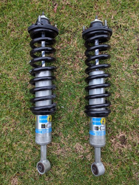

    Gonna smoke these Bilstein 6112's next!
    Bilstein told me that the 6112's are 40% more firm on rebound and 20% softer on compression vs. a 5100 paired with stock coil. I conclude that they are valved differently.
    BILSTEIN B8 6112
    Manufacturer Par no. 46-241627
    Designed for the serious off-road adventure seeker, the all-new B8 6112 kit is the ultimate suspension solution. The B8 6112 kit optimizes off-road and on-road capabilities with a 60mm digressive piston for increased damping control. This kit features an adjustable spring seat which allows vehicle leveling, larger tires, and increased ground clearance. Kit includes (2) front 60mm shocks, (2) spring seats and (2) springs.
    Features and Benefits:
    • Large 60mm monotube for increased oil capacity, cooling, and long-term durability
    • 60mm digressive piston for improved ride comfort and control over rough terrain
    • Custom engineered cold wound linear springs for enhanced vehicle control
    • Monotube design for consistent, fade-free performance
    • Application specific for maximum performance
    • Reuses OEM top mount and rubber isolator
    • Made in the USA
    • Kit includes (2) front 60mm shocks, (2) spring seats and (2) springs
    That's a much better idea, lol. :D
    My apologies. Have not had time to peruse the other award threads.
    You can count on it. Just got the pass side assembled.
    Definitely harder to assemble with the loose washers. Pry bar was helpful.

  4. Dec 21, 2016 at 5:39 PM

  6. Dec 21, 2016 at 5:56 PM

    Wow those look great. Some kits require more back spacing on the wheels to fit their spindle reinforcement kits. I know you have more offset?(or less BS?) with your 4runner wheels, would gusseting like this work with stock wheels?

    Thank you.
    The 4runner have less BS, 4.5". The stock TRD off-road wheels are 5.25". So 4runner wheels stick out .75" more, which I needed to solve a mirad of tire fitment issues.
    The truck shop spindle design has been around a long time, but not well known among overlanders. It's offered by a specialty shop here in San Diego. You might be able to ship your spindles in, don't know, you'll have to ask. Talk to James if you call.
    The design retains sway bar, and can run stock wheels AFAIK. Best feature IMO, is super strong. All the benefits and no shortcomings when compared to other aftermarket spindle gussets. In my opinion it's the next best thing to a fully fabricated spindle. Maybe it's even better, since it retains factory spec part. Right now I'm super glad to have them.
    I like Dakar. They take weight well. They were nice and flexy when I had the overload pulled. That might work well for you.
    The stock leaf pack was sad. I ran them for 55K miles, and they were shot out. I'd bottom out over speed bumps every day hated it.
    Love the Dakar's, especially now since they are silent.
    Thanks. See notes above.

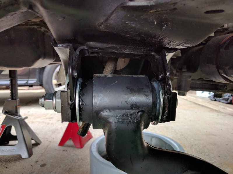

    Got pass side all done except brake pads. Had to do some minor custom alterations to the wheel speed sensor bracket and brake line bracket. Also had to modify dust shield a little bit. Came together real nice.
    Got started on driver's side assembly. Got LCA in and the new axle in, diff filled, no leaks.
    Ran out of time today.

    Nice twist, safety wire pliers?
    Crom[QUOTED][OP] and ChadsPride like this.

    Thanks. It was a needle nose vice grip special. :D
