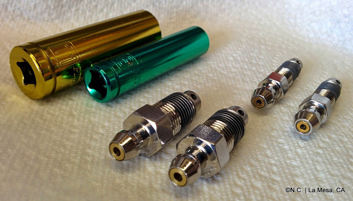

    After bleeding it did you fill it to a 1/4 inch below the fill hole?

    I don't think so, as I recall tried to remove all air possible. But please check instructions! :)

    Removing all the air makes sense. They mention to leave it a 1/4" low under the bleeding instructions, but when changing the fluid and putting in new - to fill it to the fill hole. Thanks. And appreciate the HF link.
