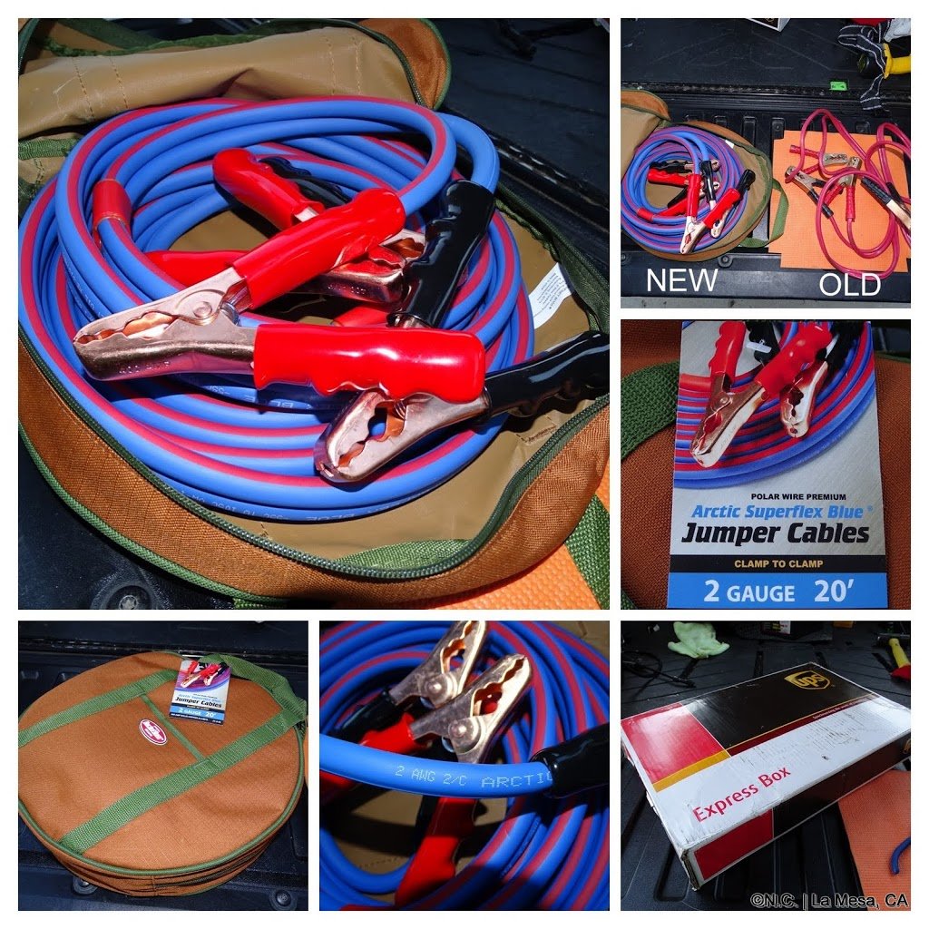

    So brown delivered me a box. It came from Alaska and its 13.5 lbs. of Made in USA awesomeness. The last jumper cables I'll ever buy. Came in a nice ripstop bucket boss bag.
    Polarwire premium Arctic Superflex Blue jumper cables, Item #: JC-2-20.
    They are constructed with 2 AWG, pure stranded copper, rated at 400 amp continuous use, with solid copper field serviceable clamps. They are 20' long.
    They were $192 shipped to my door from Alaska.
    From their marketing page:
    • Considerably more copper than standard auto jumper cables
    • Ideal for all auto, fleet, and service applications
    • Arctic Superflex Blue® Jumper Cables are pliable and easy to handle even in extreme cold weather
    • Rated for -55°C to 105°C temperatures
    • Highly abrasion resistant cable jacket withstands oil, gasoline, saltwater, acids, chemicals, and sunlight
    • Built with UL/CSA listed components and processes
    • 400 AMP continuous duty rated solid copper clamps
    • Heat shrink sealed cable ends for corrosion protection and strain relief
    • Extruded polarity stripe
    • 2 gauge Jumper Cables are sized for heavy equipment—trucks, tractors, light planes—and most commercial applications
    • Manufactured exclusively by Polar Wire Products
    Product Link

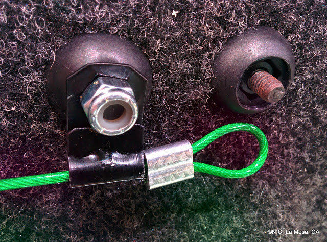

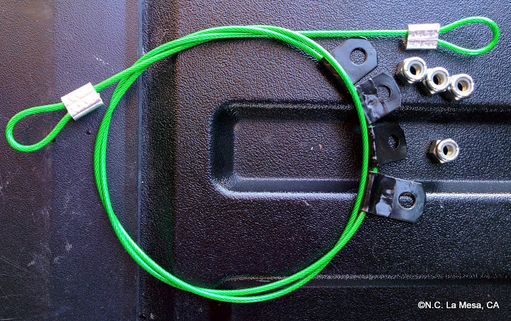

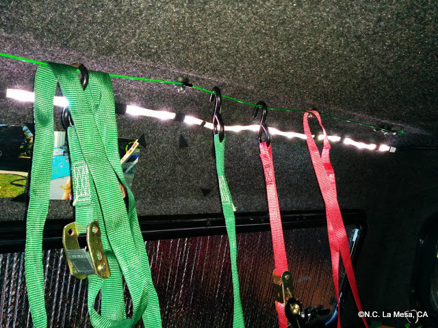

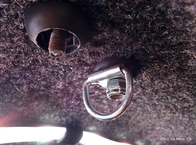

    Very nice build. How did you mount the studs onto the carpet to hold this? I have carpet in my shell as well and been trying to figure out the best way possible. Thanks in advanced.
  19. Oct 7, 2015 at 6:45 PM
    #319
    Crom
    Crom [OP] Super-Deluxe Member
    Jun 22, 2009
    #18782
    9,654
    Nick
    San Diego, CA
    2009 4x4 DCSB Camp Supreme
    Millions
    Thanks.
    The studs are actually bolts that are installed from the outside and are holding the Yakima roof rack track on.
    You can easily drill thru the fiberglass and add your own hardware. For instructions find my link to installing a roof vent on the shell. I did a full writeup on that in another thread. It's linked on the first post of build.

    Ohhh that makes sense lol. I have tracks on the way so I'm all set. Thanks! :)
