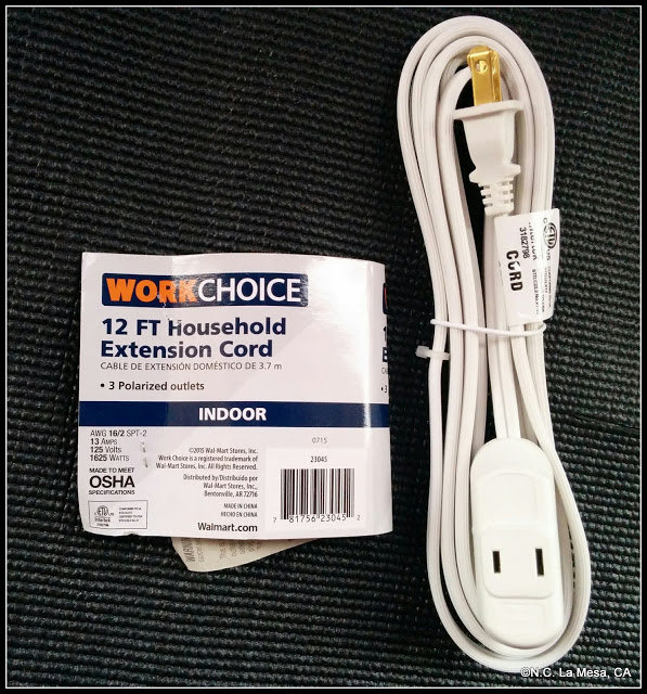

    Also, If you need wiring for in the cab, I recommend skipping auto parts store, and going to your favorite home store, and buying some extension cords, cut the ends off and you got yourself some quality 2-conductor 16AWG copper. :thumbsup:
    This one pictured below is rated to 1,625 Watts! :eek: :)
    Another option to run cable along the frame to the aft end of the truck or other exterior locations- pick up 14awg extension cords at the big box store - like Husky @HD. Decent heavy duty sheathing and an extra conductor for whatever.
