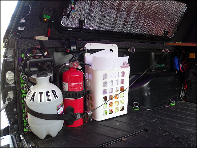

    :) Since that experience in the Volcanic Tablelands, I keep my tire care kit right next to the air hose which are both stored in the white bin in this pic.
    The plastic bin needed to be reinforced with strips of duck tape, after several trips, but it's still doing work holding my stuff. :)
