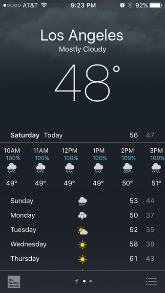

    Tomorrow is supposed to be epic rain storm. We got hammered Friday. I came home from work and dug a 40' long trench do divert standing water from my backyard to front yard where it could run out to street. So fun! :rolleyes:

    No kidding. Just checked.
    Guess I'm getting wet.
