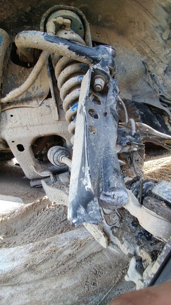

    Yeah sorry about the carnage. Glad you got helped out I understand @Spencer was the architect of the TRD Driftwood sled. :hattip: to him.
    The cost was $250 if you bring your spindles to them. Talk to James. He quoted me 24 hour turn around, and he delivered on his promise.

    I did not actually know the answer until today. They are in fact identical. If you look at the shackle, there are numbers engraved into the shackle, the numbers vary from year to year, but they are all meaningless as far as I can. They appear to be internal manufacturing codes and can be disregarded.

    I spoke to Adam at 4xinnovations today. Here is what I learned.
    The shackle uses a custom bushing. He described as a 2" bushing with the leading edge trimmed off. I'm not sure I understood what he was saying. I was like, can't I get a 40mm bushing from energy suspension and run that, and he was like no. The 40mm size is what Toyota OEM and Dakar use.
    He said he has never had a customer wear out the poly bushing, he said he sells replacements for $8 but not on the website.
    The grease fitting is not pictured on their website, and he would not provide me with any additoinal photos beyond the web. He did explain that the grease fitting was on the inside of the shackle as pictured (with shackle flip), so for us with stock inverted shackles, the grease fitting *should* be where I choose to drill and tap on the outside.
    The 4xinnovations are made from 1/4" thick plate, so they are much stronger than stock. For those of us running standard inverted shackles, I think stock ones are plenty strong. However, if running in shackle flip, the upgraded strength would be highly desirable!
    At $94 for the set, that's a friggin deal! The Toytoa stock ones new are $75 each! Modifing OEM ones only costs time and it's a f***ing pain in the ass.
    @scocar Buy these and give them a whirl :D http://www.4xinnovations.com/05-15-Tacoma-HD-Replacement-Shackle_p_148.html

    Whoa, wait, can those 4x shackles be used without a flip kit? I.e., on the OEM hanger in the OEM configuration? Their description and photos aren't clear on this, but it looks like they might work.
    EDIT: I think you have effectively stated that, now that I went back and re-read the entire post. :homer:

    Yes. That's my understanding. Call them and talk to Adam, he said he designed the shackle, also the guy who answered the phone. :)

    That was the handiwork of Jeff at JTA Metalworks. @jeffz0rz
    Back in October when I was having my frame plates burned on I offered him as bonus work to remove the bushing from the shackle. I had already burned out one with a torch and at that time I did not own a jigsaw, so I could not follow @Sandman614 's work to remove the pressed shell. See quote below.
    I could have used a hacksaw but that would have royally sucked even more. Plus Jeff has a 20-ton press and other tools in his shop. :D
    He was successful in removing the outer shell of the one I. Worked on and I took that one home. I left the other with him to work on. I finally picked that up today and today he did the drill and tap for me.
    Jeff said that removal of the OE bushing was a gargantuan pain in the butt! lol I told him he had the dubious title of being perhaps only one of two people to have done it! lol

    Wow. That does look like a PITA, but you know I'm a dumb ape with a lot of tools so I may attempt it still.
    It'll probably wait till I have a spare set to play with so I'm not on jackstands for too long. Time to put the word out for a used set. I already have a set of lower control arms to do the poly upgrade to those. Building a new truck like good old Johnny did:

    Could you please explain your thinking/reasoning here?
    The shackle will see the same load independent of hanging orientation. The only difference will be the direction of load.

    Sure. Short answer is buckling
    Long answer:
    I don't think it's the same, and it gets into the heart of engineering on the matter.
    First this:
    And this from an anonymous engineer who calls himself ass_slayer69 :rofl:
    I've seen an empty soda can support adult human weight. Poke the side and it buckles and collapses catastrophically. Take an undamaged can and try to pull it apart, extremely difficult.
    Same goes for plastic straws, metal wires etc. Very difficult to pull apart yet easy to crush.
    Toyota designed the second gen shackle for tension load, not for compression. Just my opinion, but I think using suspension components improperly can have disastrous results. If I was going to shackle flip, I won't ever, but let's say I did I for the moment, I would want the absolute strongest solid one I could buy.
