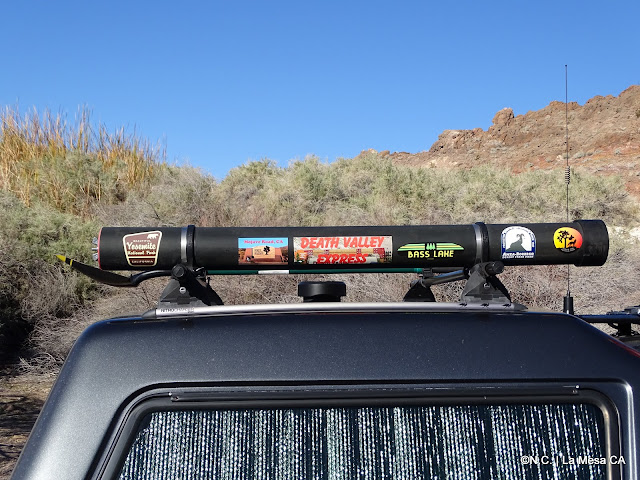

    Here is the new ABS pipe hardware, minus tarp straps.
    New hardware
    Here is the old below, Notice I aim missing a large worm clamp. The clamp had sheared off in two places. The only bit that remained was trapped under the smaller hose clamp! After careful inspection, the larger still-intact hose clamp had also begun to shear as well! Glad I do these inspections. :)
    When I installed this thing four years ago, I always wondered how long it would last. The violence from off-road vibrations, certainly takes their toll in the form of fatigue cycles. Fortunately, the tarp straps do well to help control vibration and act as a secondary or primary retention mechanism, depending on how you look at it. When reinstalling the new tarp straps, I subtracted one hook from the strap and used the remaining hook and passed it through the vacant hole on opposite end to hold it down. This simplifies things, and gives better retention. Interestingly enough, the original tarp straps, exposed to four (4) years of sun, were not cracked or torn. They were about 2" longer than when originally installed, but otherwise in decent shape.
    Old Hardware, note broken clamp
    The ABS pipe which holds tent poles
