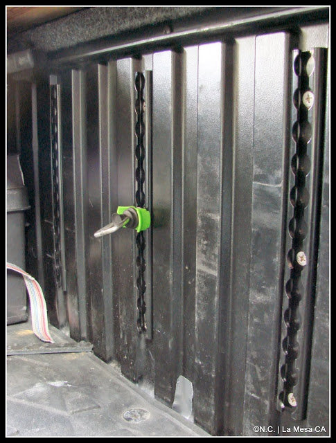

    Most Super Awesome Tool (MSAT) :rolleyes: :stirthepot:
    I decided to one-up myself while working on the Tacoma. I wanted to bolt up some new L-Track on forward section of the bed to optimally secure my cargo since I've changed how I load the truck. In the past when doing this, I've used rivet nuts for plastics for that part of the composite bed. To date, I've never had one fail and they have held a lot of weight. However I wanted to try and do one better. I wanted to use fender washers and nylock nuts like I've done for the bed floor installs.
    Nylock nuts epoxied to fender washers vs. Rivet nut for plastics
    To make this work, I first glued the washers to the Nylock nuts. I used household superglue or 2-part epoxy. Both worked equally well.
    Then I built the most super awesome tool (MSAT) :rolleyes: You can't go buy the MSAT, you have to assemble it in your lab. I mean garage. Aluminum flat bar 3/4" x 1/8" x 36", duct tape, and 11 mm wrench. :eek:
    Assembled glued fastener, Built
    MSAT, ratchet with extension and Phillips bit
    Open end of box wrench and miracle product "duck tape" holds fastener to wrench. :)
    Using the 36" long handled MSAT with taped on fastener, and reaching from the side of the truck, I was able to easily reach between the bed and cab and find the protruding 1/4"-20 x 3/4" flat head machine screws. Because I have a shell, I had to reach through the window to access the bed with the 1/4" drive ratchet and extension. All in all, it was a simple job of tightening everything up. The tool allowed me to do the job solo. :bananadance:
    It worked better than I could have possibly imaged. The aluminum bar is rigid and long and great for helping torque faster, yet flexible enough to bend into place.
    MSAT also works great for reaching in between gas tank and composite bed floor. :)
    Example: my old L-Track bits bolted to forward section of composite bed.
