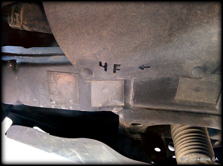

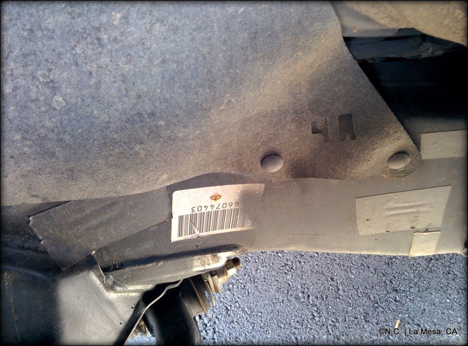

    So in the older trucks, Toyota shipped them with big holes in the frame. This is a trap for salt, water, dirt, and road grime to corrode out the frame. This is the front section of the boxed frame. I was going to install frame plugs, but the dealer wanted $5 each for a plug. I laughed my way out of the parts shop and came up with my own solution. Medium duty dark gray duck tape. Installed in Nov. 2014, It's been 11 months and they've been great.
    Seal them all up except for the holes on the bottom side of the frame.
    There is a big ~2.5" hole at the body mount perch, you need a flash light to see it, even in day light, I still have to seal that one up...

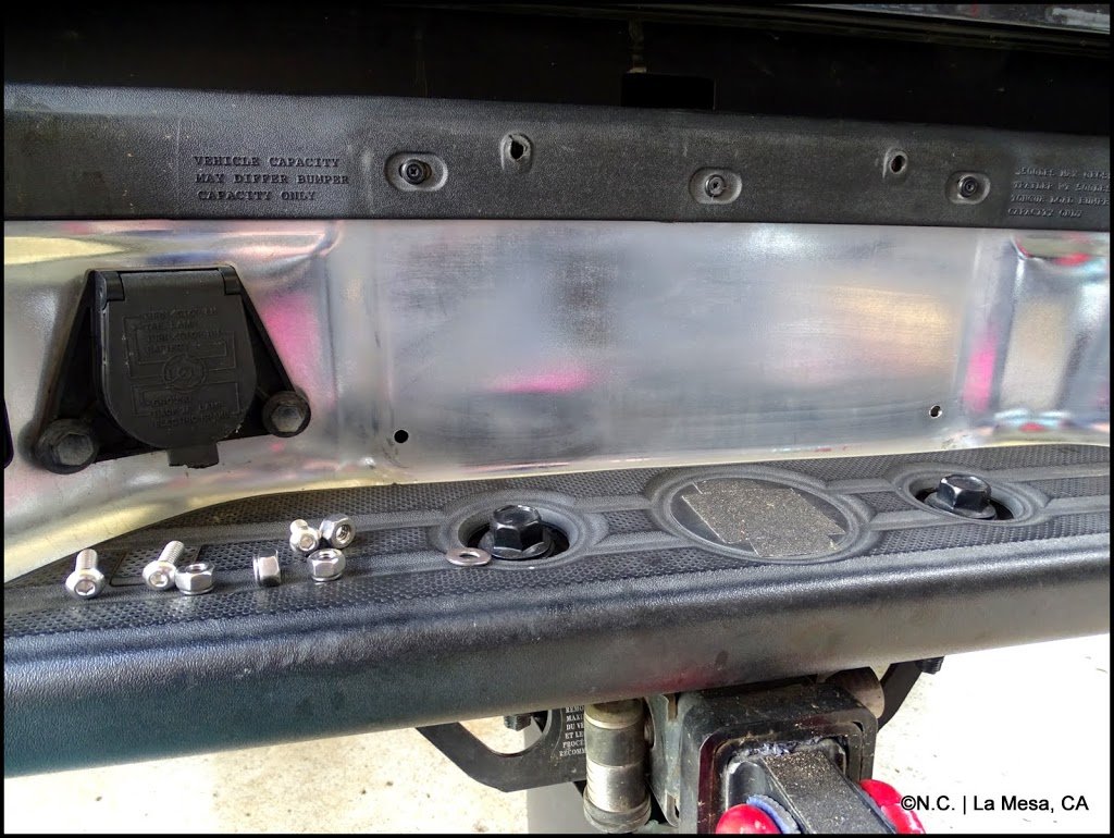

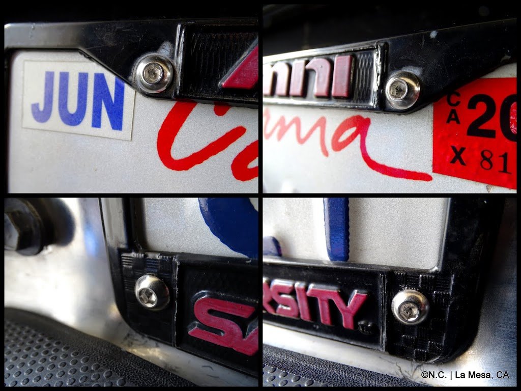

    I finally got around to securing my license plate against casual theft. In the great state of california :rolleyes:, victims of plate theft can expect to pay the state $40 total to get things right. :( To avoid that potential headache, I decided to take a proactive step.
    To prove how easy it is to steal a plate from a stock vehicle, I provided a Phillips screwdriver to my just-turned-5-year old daughter, and instructed her to remove the (2) screws holding it in place. It took her a few minutes, and the plate fell into her hands. She was very proud of her work. :D
    I replaced the stock ones with some stainless 1/4-20 x 3/4-Inch Button Socket Cap Screws. I drilled some new holes in bottom of bumper. I used stainless Nylock nuts on the back. The plate and plate holder are super tight now :), and will serve as a decent theft deterrent.
