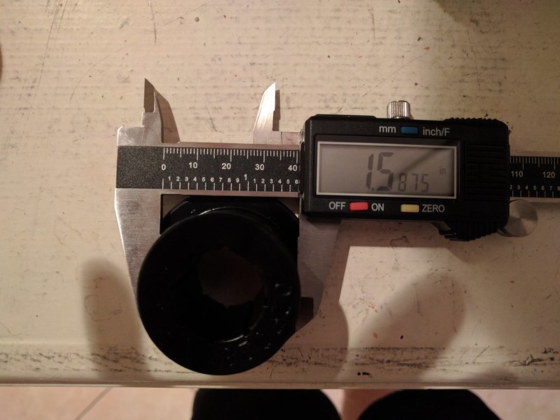

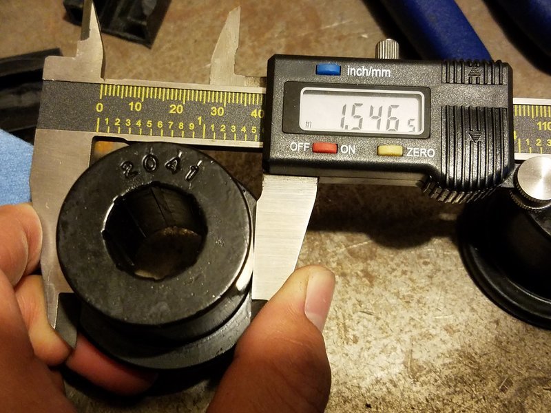

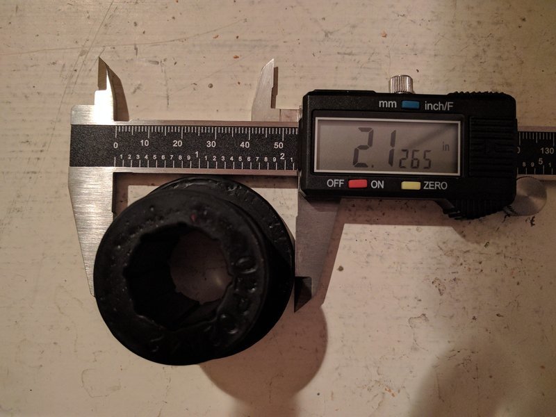

    The leaf eye bushing is measured to be the following. As for the shackle bushing I'm not sure because I went with 4xinnovations stock replacement shackle kit.

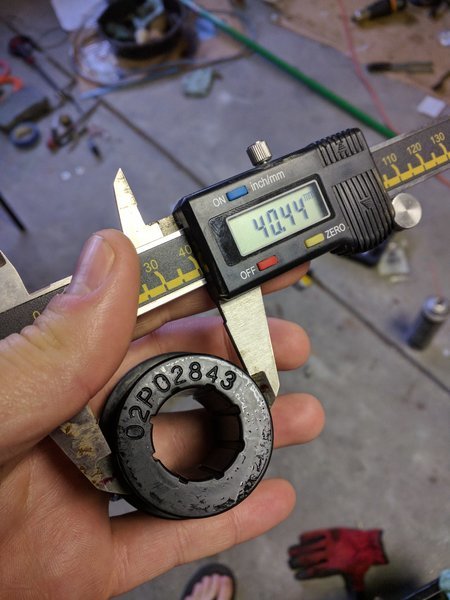

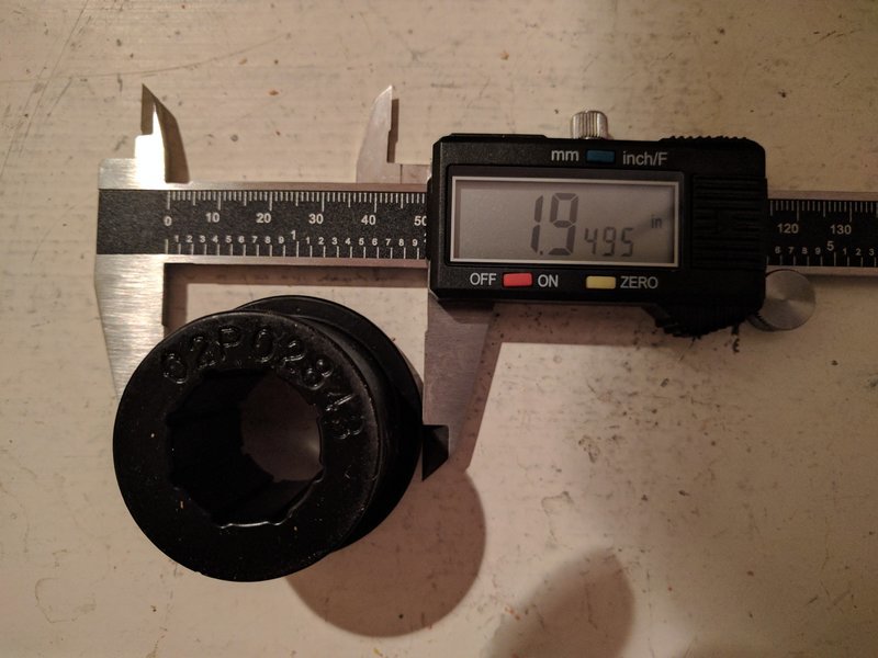

    ES shackle-frame bushing OD (mm).

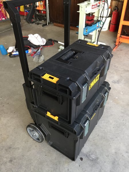

    btw I ended up going with Dewalts system bc it is dust/water proof. Took it on a trip to Death Valley last month (hella dusty) and everything inside stayed clean!

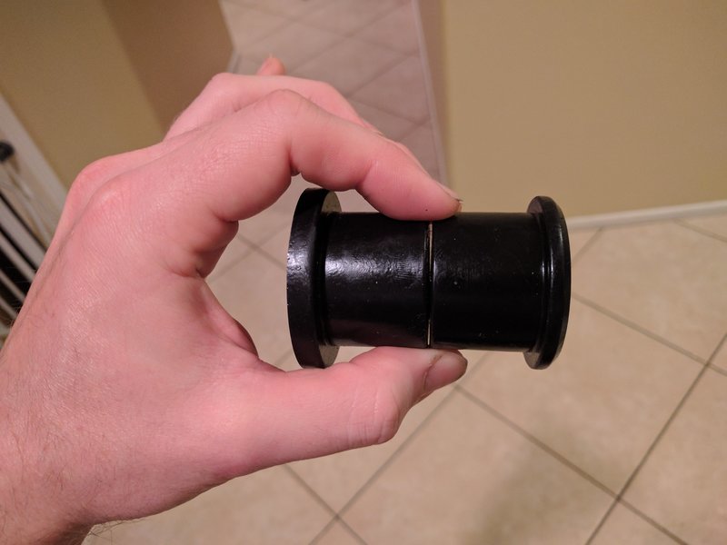

    Can you measure the leaf eye bushing size too? ES doesn't sell just the shackle-frame bushing, only the full kit and I already have the ones from wheelers. If they are all the same size I can just order another wheelers set.

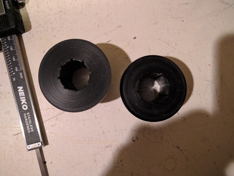

    If you haven't already ordered anything there appears to be 2 different bushings in the 82116G kit. But the difference is in the shoulder(or flange OD). I haven't taken a look to figure out which ones go where.

    I've got the bushings from Wheelers already. Two sets. I ordered the OEM shackle to frame bushings yesterday.

    I posted which one is the shackle-frame bushing a few posts back.

    Mine is not dust/ waterproof.
