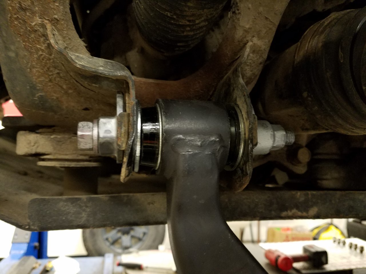

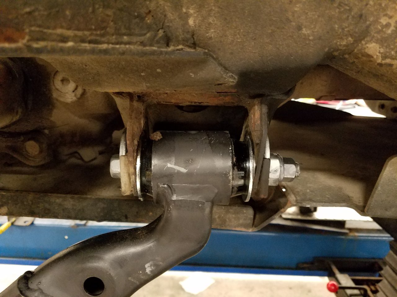

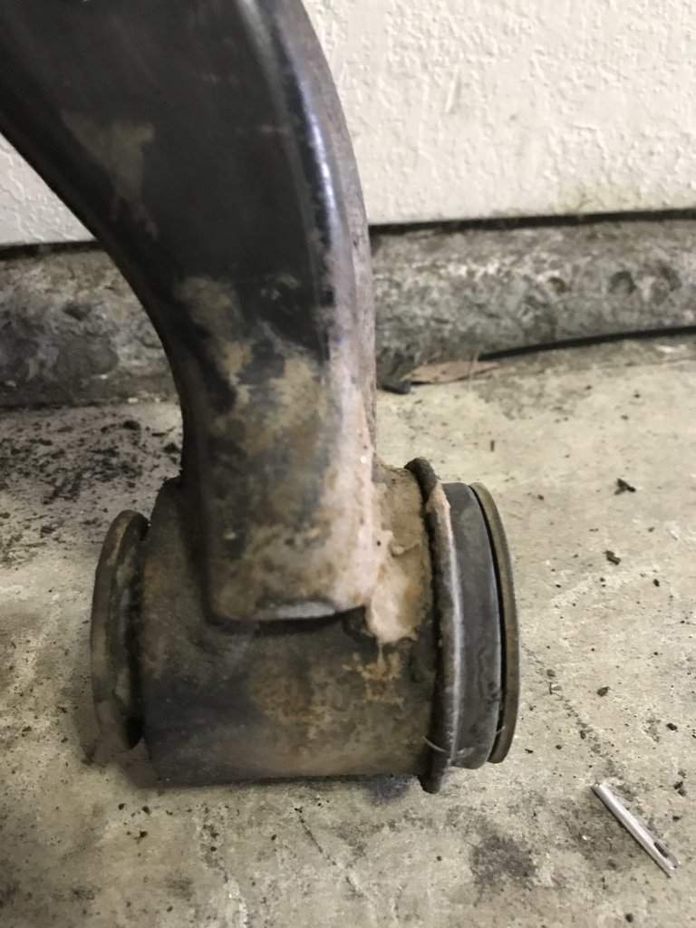

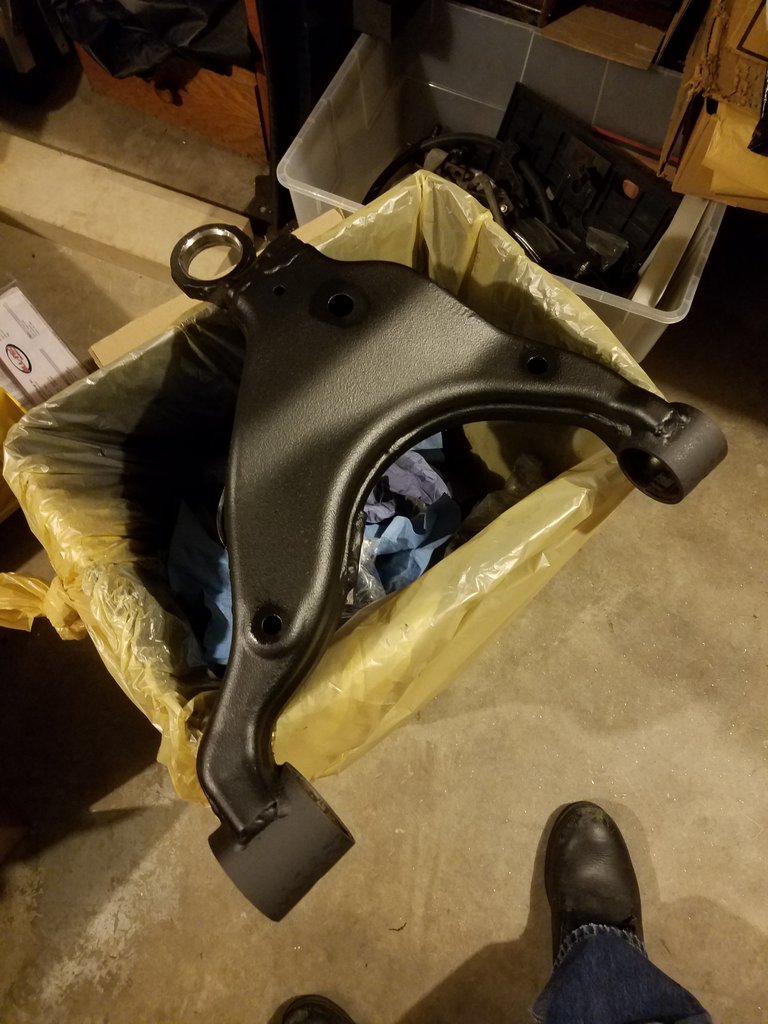

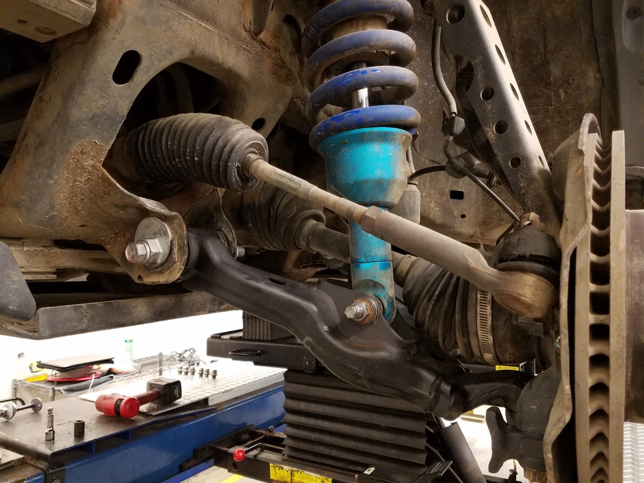

    I just finished rebuilding the stock LCA's with the following (much thanks to Crom for his posts - this thread is like a tacoma bible...)
    Whiteline Front Poly Bushing kit
    ProForged Ball Joints
    Reinforced some of the LCA with added welds
    I sandblasted the LCA's and primered them with self etching paint followed by rustoleum black paint and hit the underside a few times with bed coating
    I had to cut the passengerside sleeves to get the original control arm out and only the rear sleeve on the driverside. I used Dewalt Metal Blades (linked below) and these worked the best out of the three brands I bought. I used cutting oil on them while I cut and it went through eventually.. fought me the whole way but nothing a corded milwalkee and a few beers couldn't fix. Rebuilt them with all new oem hardware from toyota prepped with a dry film lubricant and a LOT of neverseize.

    To those inquiring if you need an alignment after installing these - my truck has 134k on it and I need an alignment even after setting the cams to the exact setting they were before - the bushings I had in my original LCA's were very work and super soft. The new bushings definitely give me a much better feel for the road that's for sure.

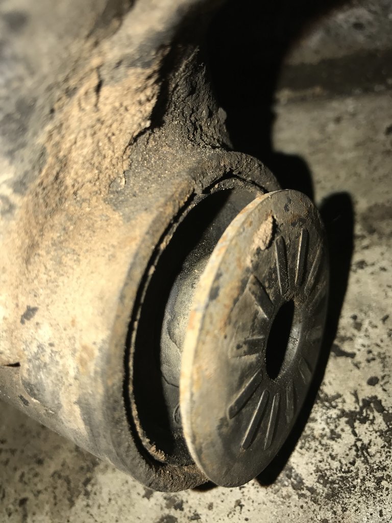

    Were you able to move your bushings by hand? I stick a bar in mine and they hardly moved at all so I "think" they are good IMG_4798.jpgIMG_4800.jpg

    One of mine looked like it was torn after I removed them. I'm going to rebuild the set that came out of the truck except this time spend some more time welding them a bit better and possibly welding skid plates to them as opposed to having bolt-on skids. I would ideally like to make a jig for them and make my own lca's but that's long term.

    Moog greasable joints are working well. I'd buy again in the future.
    Whiteline bushings are working fine. Not a lot of mileage on them yet though.

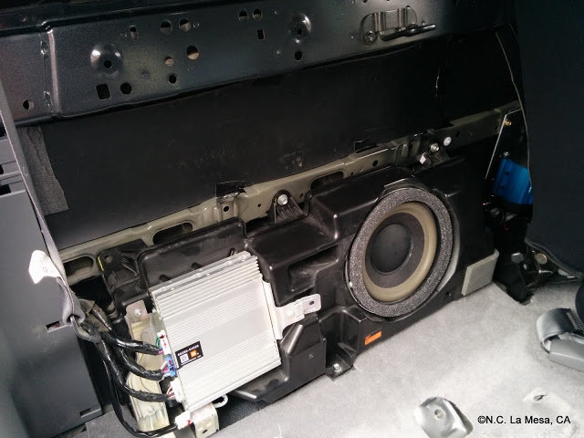

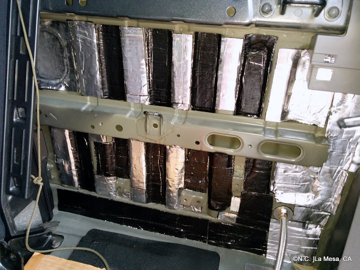

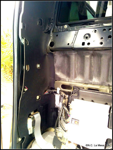

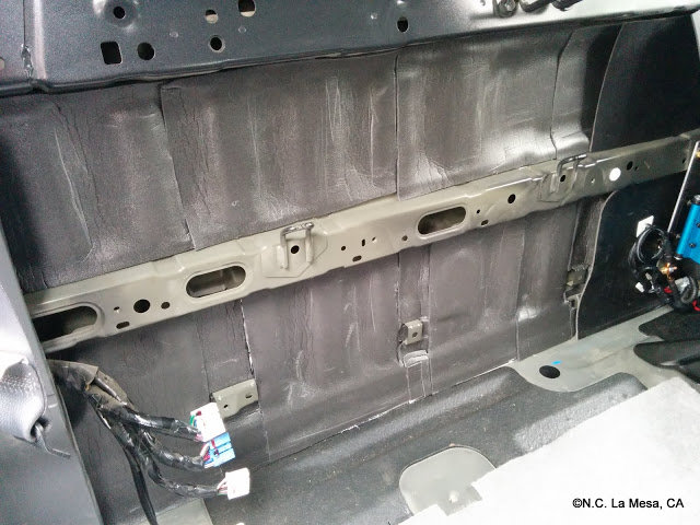

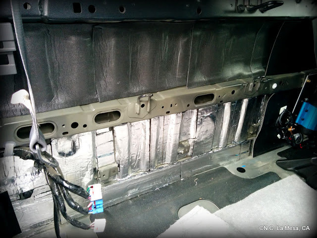

    Hey, I was looking up your links to the sound deadening project, and I didn't see one for the back wall of the cab. Did I just miss it?
    I think that is what I need to attack first, and is obviously going to be the simplest, which also means fastest, which is what I need for any wins these days.
    Blackout14 and ChadsPride like this.

    Here you go @scocar
  13. Jul 13, 2017 at 3:36 PM
    #3793
    GHOST SHIP
    GHOST SHIP hates you.
    Mar 9, 2015
    #150537
    22,402
    GHOST

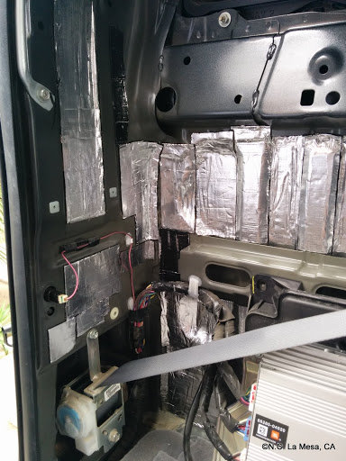

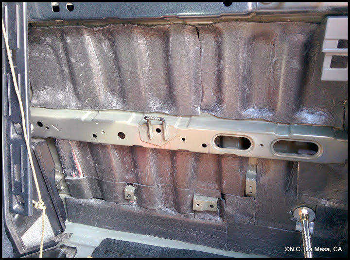

    My advice to @scocar is when you lay down that first layer of foil covered butyl, avoid trying to lay down a large section at once and then work around all the curves. Instead, stick down the center of the section you're laying down first (vertically) and work your way outward from there. That way you can give yourself enough slack for the mat to conform to the ribs in the sheetmetal and you won't tear through the product by stretching it too far. Also, if you get the roller applicator with a wooden handle, the rounded end of the handle is perfect for pressing the material tight into those curves and saves your hands and fingers from being sore as shit the next day. That's how I did mine. To some it may not matter since it'll be covered up anyway, but a neat application saves you from wasting product and time in the long run.
    I talk about that a bit in my roof insulation thread.
  14. Jul 13, 2017 at 3:53 PM
    #3794
    scocar
    scocar hypotenoper
    Nov 11, 2009
    #25814
    39,986
    Nice, that all makes sense. So is that all that was used on the back wall? Foil-covered butyl, or is that only the first layer? I was looking at his product links to trying determine what to get without hours of reading.
    ChadsPride likes this.
  15. Jul 13, 2017 at 3:55 PM
    #3795
    GHOST SHIP
    Mar 9, 2015
    #150537
    22,402
    GHOST

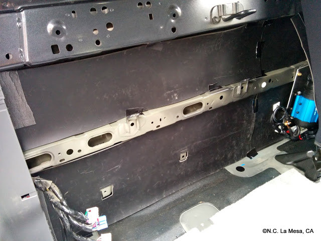

    From what I recall, he used 3 layers:
    Sheet metal
    Butyl foil
    Insulating foam
    MLV
    Storage bins or whatever your final exposed cover is.
    Looks like the "products discussed" window doesn't show link for any of those. He's usually good at providing links.
