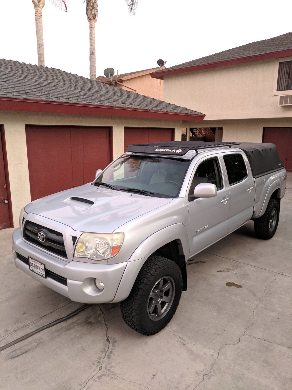

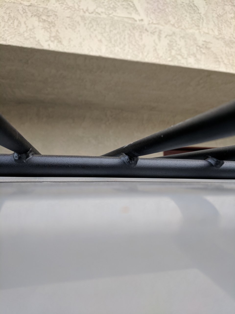

    Got the bajarack installed! Thanks for the tips everything went smoothly. Is it normal for the rack to be this close to the body? When I stand in the middle it's touching. I won't be putting that much weight in the middle often, but it's still alarming.

    If your standing on the rack more or less in the middle you are applying a 'point load'. When you load it with stuff, it should be evenly loaded over the rack surface depending on the individual load densities. Not going to be a problem. You could also contact the manufacture for quantified answers.

    That's what I figured. Just wondering if everyone's is that close. I really do love the low profile design on this rack. Can't wait to put it to use!

    I had this problem in 2012, I submitted photos to bajaRack. They made me taller brackets. In my opinion the rack should clear the roof by 1/2". Because the rack will deflect when loaded and touching the roof is unacceptable, IMO. Good luck!
