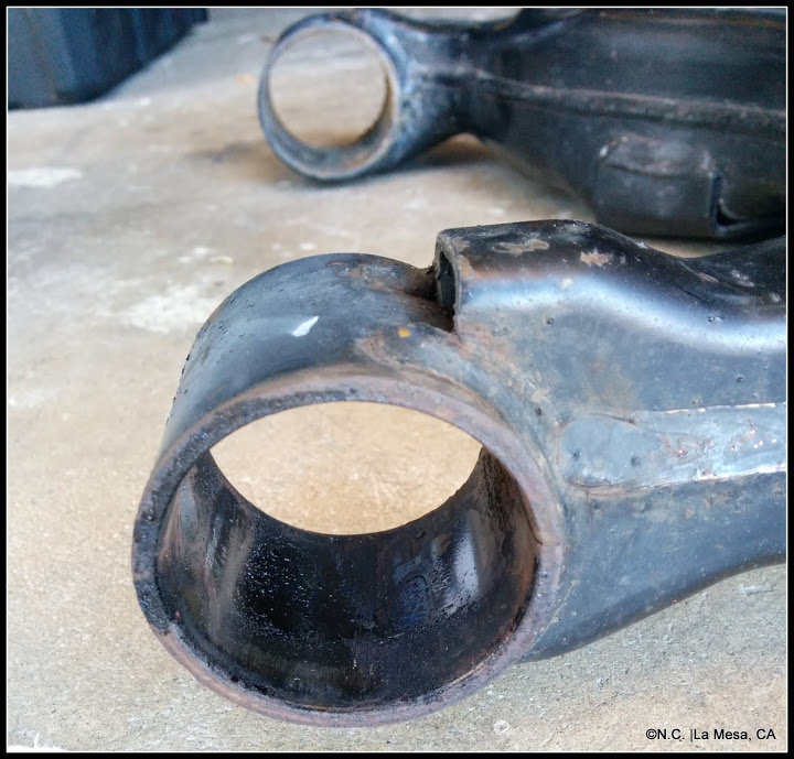

    The i̶n̶n̶e̶r̶ ̶s̶l̶e̶e̶v̶e̶ shells came out with everything else, eh? All of mine are stuck in. :annoyed:
    Hosed them down with a little PBB. Will try to get them tomorrow.
    Think a little more heat will do the trick?

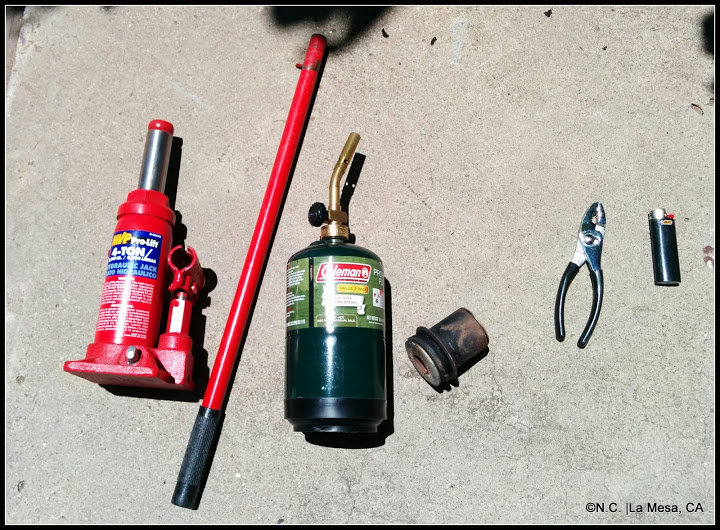

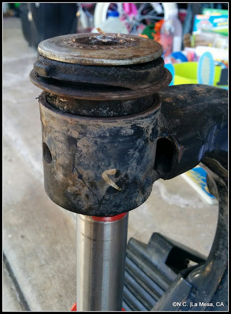

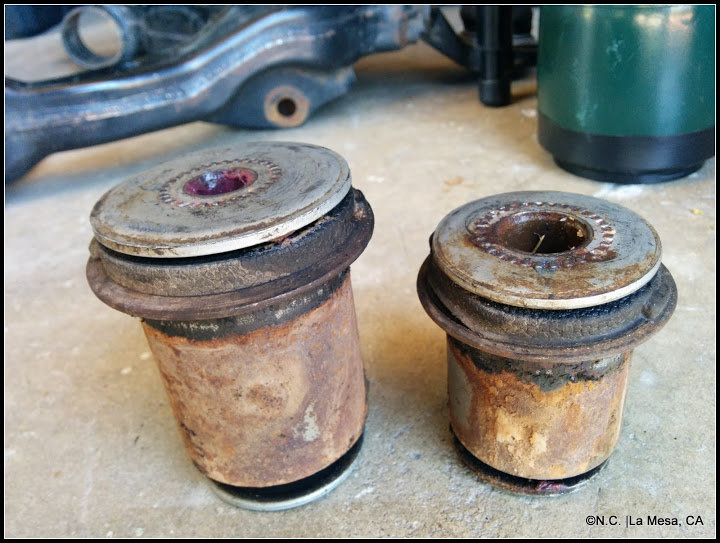

    Not sure I understand what went wrong with yours. Mine happened just like the pics. Heat is key.

    Sounds like the rubber from his separated - when i pressed mine out the metal sleeves came out like Croms' did as well. I'll be doing round two soon for a new set of LCA's I'm rebuilding using a different ball joint.

    Yeah, it did. The i̶n̶n̶e̶r̶ ̶s̶l̶e̶e̶v̶e̶ shell is rusted in there pretty good.

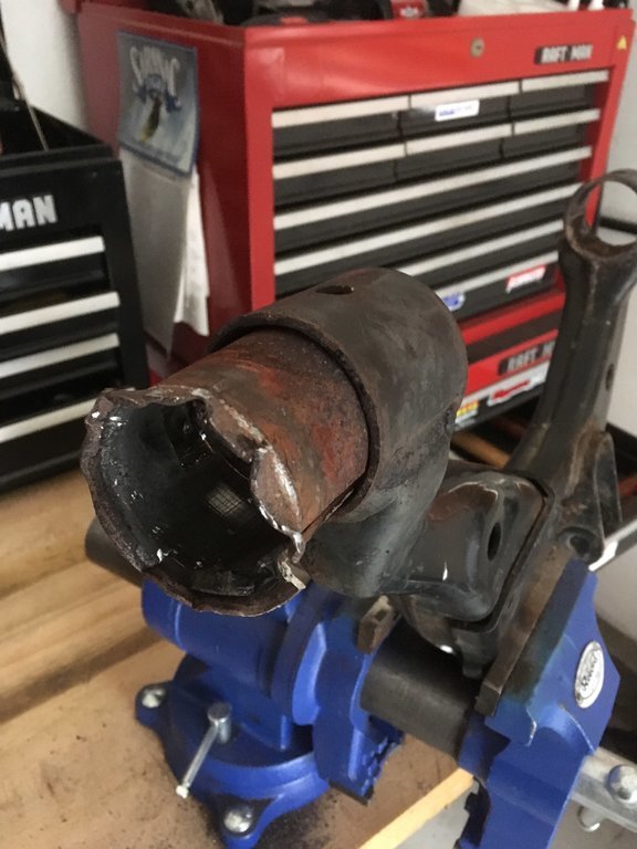

    That’s how mine were. I ended up using a sawzall to get them out.

    I'm sure yours were not rusted as bad as @DrFunker 's though.

    My truck is a 2010 and spent five years on the east coast, spelled salted and calcium brine winter roads. You can see the sawzall cut. Three out of four were that way.

    Thx for pic.
