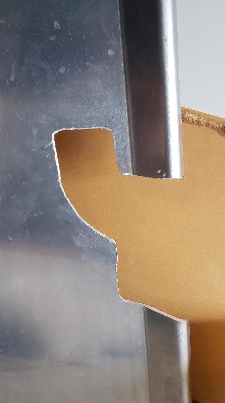

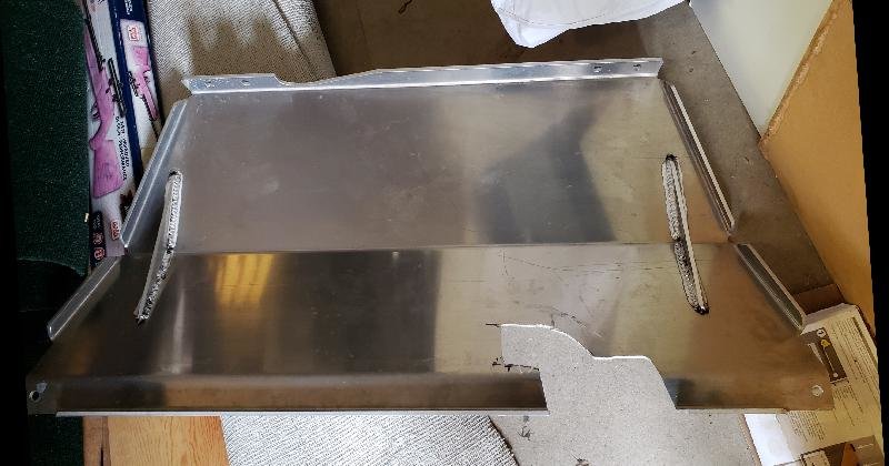

    Pictures of the clearancing I did on the skid. I used a angle grinder and then I use a jig saw with a metal blade which works surprisingly well, but had to finish it with the angle grinder again.

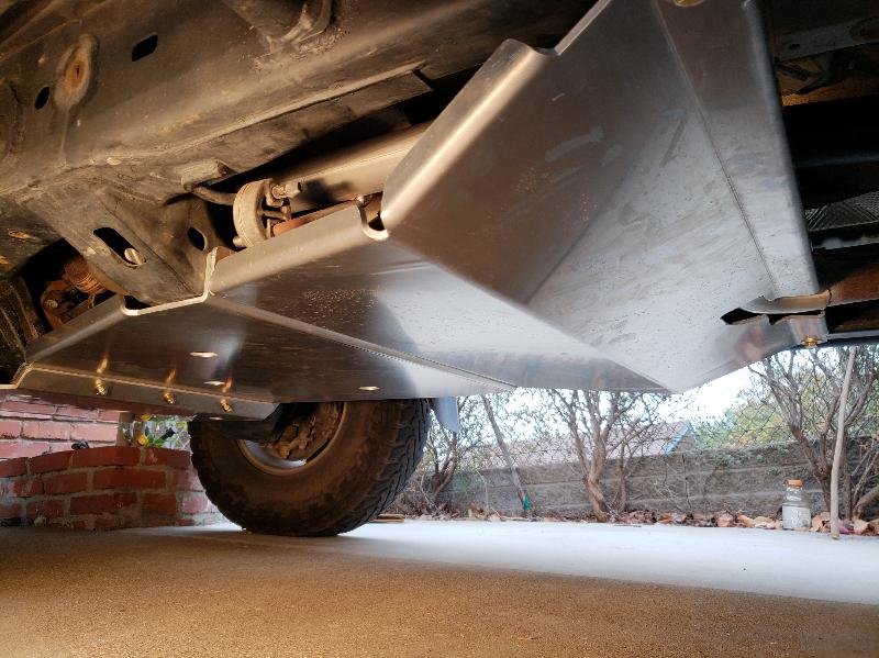

    Got 'er done.
    It's like a truck building miracle. :D
    244 days between taking possession and full install.
    Worked like a champ, fresh bit, plus great tool. Good combo!
    Edit: yeah the handle is awesome!

    Skid install done.
    Since I brought in the skid, they checked for fit doing the reroute. I think same shop as yours. They said all reroutes have been slightly different due to truck to truck differences. Mine is a little close to the transfer case so I threw a heat shield over that part.
    Drilling was easy enough, didn’t bother with a pilot hole. Most difficult part was the truck was on the ground and there was just barely enough space to get the drill under the frame.

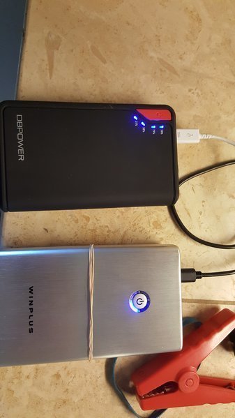

    Though it looks like an improvement on the previous 8k model, be wary of the Costco winplus brands of jumpers. I found mine to self-discharge (they all do, but slowly) at an unacceptably fast pace. This is a pic after just a few weeks storage from 100% charge, compared to an Amazon cheapo. Perhaps this is something they fixed with the new model. Things are evolving very rapidly with Lipo jumper tech it is amazing. Having one (or two, like I do! because of the tiny size) with me inspires confidence in the backcountry. Plus no chance of a full auto-size jumper pack battery flying around the cabin/shell in case of a wreck.
    Anyway something to keep an eye on. It's a good practice, as you know, to top them up once in awhile. It will be interesting to see what it reads on the indicator lights. They likely corrected the problem, if not the costco return policy is generous.

    Thx. I'll keep an eye out for that!
