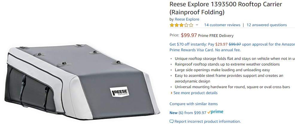

    good points. i'll mostly be traveling in the southwest and maybe up in the sierras during the summer. so hardly any mud. you guys saved me some money and weight on my truck!
    back to my question about Crom's rooftop carrier for sleeping gear... i picked this up for my trip this week. it's soft sided, but also framed and collapse-able. The price isn't bad either. Not very secure, but mainly just using it for sleeping bags anyway. best part is it's easy to store in the garage. it may be a shit purchase, and if so i'll just return it. the reviews are decent and it's the size i want - on the smaller side so i still have room for our doggy cot
    https://amzn.to/2MmDD9v
    Crom[OP] and crazy joker[QUOTED] like this.

    Not bad, worth a shot!!! :thumbsup:
