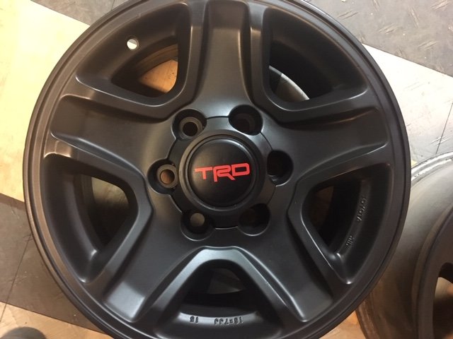

    Thanks for creating such an awesome thread Crom. I went with the early 4runner rims based on your recommendation and they've worked out perfectly for me, with zero rubbing issues with my 285/75/16 tires. You commented at one point in your thread that you were considering spraying them black. I'm a big fan of the stock finish but with my black winch bumper and black rock sliders, I decided to Cerakote mine black to match. I thought I'd share the finished product so you can get an idea of how yours would look if you decided to go black. Thanks again for the awesome thread and write-ups! I've benefited from your contributions on the site on more than one occasion.IMG_4695.jpg IMG_4783.jpg

    They look great in black. How did you do the centercaps?

    Thanks man. On the center-caps, I put plastic bumper filler in the stock logo cutout and sanded it smooth. I used some Rustoleum paint that was recommended for plastic to spray them black. Then I ordered some TRD decals off E-bay in a high-quality vinyl that were 4" in diameter and ordered the option of red lettering on a black background to go with the trucks paint color. The final clear coat of Cerakote is a matte finish which I sprayed on the wheels and center caps so they'd both have an extra coat of protection and the same amount of gloss. I opted for the air-dry Cerakote on the clear coat so I didn't have to worry about the center-caps deforming from the heat. Air-dry Cerakote takes about 5 days to fully cure but for heat-sensitive things, it's the perfect option. The wheels were done in the Cerakote graphite black that I baked at the usual, 250 degrees for 2 hours.
    I started out Cerakoting guns and motorcycle parts but thought it would be fun to try something a little bigger. I'm pleased with how they turned out.

    That looks amazing! Very well done. The colors do compliment your build. Thanks for sharing! I think @scocar would be impressed as well. :)
    Much appreciated!

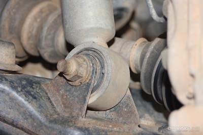

    Truck is down for the moment.
    I went in to grease urethane bushings, which was a good decision as the LCA's really needed it.
    However I found that the driver side shock bushing sleeve has torn itself from the rubber and bush will need to be replaced.
    For my loss Bilstein told me the wrong part no for the replacement bushing which was a waste of my time and money.
    I'd accept a poly replacement if I could find one.
    Also, the zinc washers that Whiteline bushings ship with are almost all bent / warped and I want to replace those as well.
    What a pain.

    ...sorry for your pain there. i'm going back to figure where you placed those washers that are bent previously

    LCA installed in December 2016. Pics here
    Refurbed LCA pics here
    The washers are zinc plated steel, but not hardened. Maybe they are designed to be soft. I don't know. But I think it's very poor form to have suspension components deform on install. The reason for the deformation is that they are bent when LCA cams are torqued to spec.
    I put just a little over 10K on them. Bushings appear fine, just a smidgen of melting on one. haven't pulled pass side apart yet. Waiting on more parts.
    Contemplating just tossing in my old factory take off once I get the shock worked out.

    ..agree, i don't like that washer deform, that is an expensive bushing kit, i'd expect more, but then as you say, maybe 'supposed to deform'??
