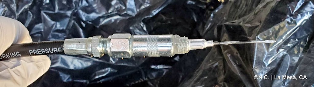

    I greased the UCA's using the loosen bolt and zerk method. Worked.
    I took it a step further, and used my needle attachment to grease between bush and washer. This worked excellent.
    Waiting on more parts 1-2 more days...

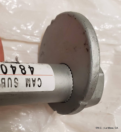

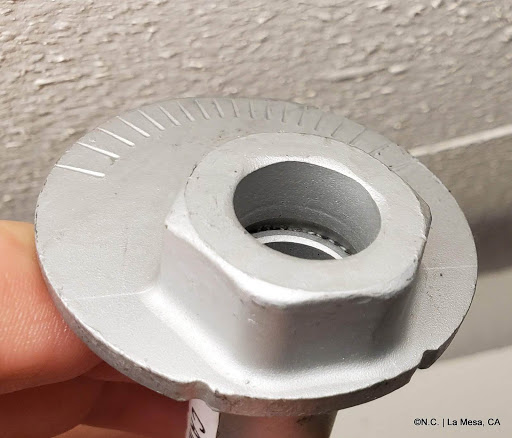

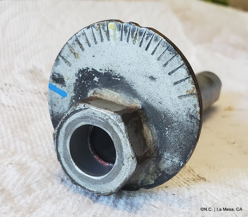

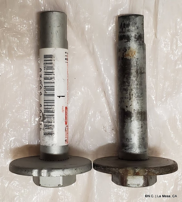

    I tried to repair a concentric that was otherwise okay, but I misunderstood what I was seeing and worked in haste.
    This concentric consists of a cam plate that has a knurled tube pressed into it at the factory, so it's like one piece. It would be a hell of a lot stronger if it was machined as one piece, but it's not, two pressed together.
    But what sucks is that the tube is not pressed all the way into the plate!! There is a deliberate space in there!!
    Having destroyed the passenger side cam 3 years ago due to Mojave-fast driving, I looked at this one and thought it was separating too, so I put it in a bench vice and proceeded to press it. I pressed too far and ultimately ruined it.
    The a replacement factory part is shown for comparison.
    Don't do what I did. :D :D
    Ruined Cam - No space between tube and cam plate (see red grease)
    Shortened Cam next to factory new
    See the space in there? It's supposed to be there.
    The knurling on the tube is visible. This is normal.
