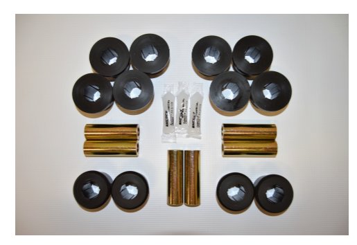

    So, Nick. I'm finally done moving again (Don't even ask. Just do not.) and dusting off my remaining parts-to-buy-list.
    WHEELERS IS HAVING A SALE RIGHT NOW, and there is an important question for you lower down, but here is the leaf saga update:
    After dicking around and dry fitting the 4Xinnovations HD shackles, OME SB108s, and my Dakars with the AAL, I've discovered the following.
    Thing 1: The HD shackles DO NOT WORK with Dakars, let alone Dakars + AAL. The leaf tips are too long, extending into the throat of the shackle very quickly on compression, and then bind up and stop, severely limiting articulation. In fact, after perusing JLee's BAMF HD shackles and his very open R&D discussions with customers, it is clear that the BAMF HD shackles will not accommodate this Dakar setup either. The conclusion is that any leaf pack using a bottom-of-eye wrap (envision __O ) vs. a mid-eye wrap ( ---O ) simply will not work with the beefier gauge shackles.
    So, I concluded my path is clear and got some of the OEM sans-bushing shackles from Camelback. Yay. And thank you.
    Next discovery, the OME SB 108s fit like crap in their OME Dakar eyes. WITAF? Not only are they surprisingly loose in the barrel, but they butt up against each other in the middle of the barrel before the outer bushing flanges contact the outer edge of the Dakar eye/barrel.
    So, I concluded my next path is clear. Fuck those things, and use some other aftermarket bushings.
    You did provide a link to busing options in your post above, but they no longer go directly to a specific product.
    VERY IMPORTANT YET DRAWN-OUT QUESTION FOR YOU
    Yours appear to very clearly have a matte finish and a beveled outer flange:
    The ones I found at Wheeler's are glossier, and have squared off flanges. They appear to be Energy Suspension by the stock number and the grease tube: But, Wheeler's also has these: [​IMG]
    On the Energy website, this is what appears for my spec , and note that they seem to have some beveled, and some square bushing flanges (haven't called them yet to ask, just seems weird).
    https://www.energysuspensionparts.com/8.2116. Are the squared flanges (2 pairs) intended for the leaf eyes, and the beveled one (1 pair) for the shackle-frame mount?
    On the Headstong site, your link 404d, but they have these. The low-res photos aren't super helpful, but it looks as though they may be exactly the same as the ES site kit above.
    https://www.headstrongoffroad.com/store/p513/Full_leaf_pack_bushing_kit.html
    QUESTION SHORT VERSION:
    Are these Wheeler's the ones you referred to in your original post? I'll need for both eyes and both shackles.
    Cheers, happy new year!

    Sorry to hear about the fitment issues.
    I'll go thru your thread soon for the move info.;)
    I took a fantastic new career opportunity late last year and the rewards have been outstanding. We got out between xmas and new years a couple times and if by some miracle I can make it back here I will post a photo or two.
    From what I remember. the shackle and leaf take the same bushing. So it matters not when you order. When I ordered from the suppliers you listed, it was not possible to link them to a manufacturer via manufacturer markings. They poly molds used to make the bushings had 4-digit stamps, but the stamps only identified them internally to the manufacturer as far as I know.
    Bottom line is, what you order for the leaf will fit the shackle. Out of the bunch that I worked with the Wheeler's ones were best at the time, but that was so long ago...
    I hope this helps!
