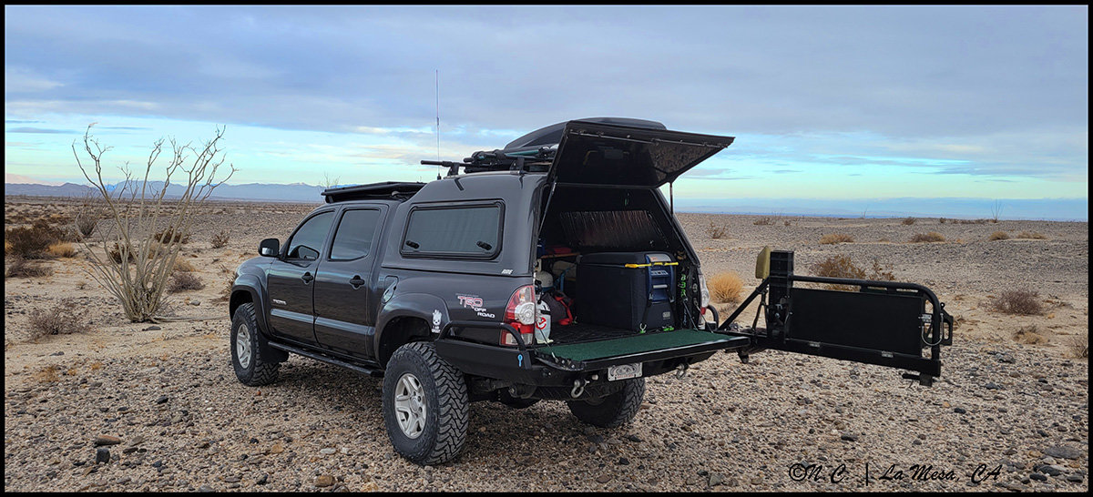

    Solo in the Sonoran desert (2021)​

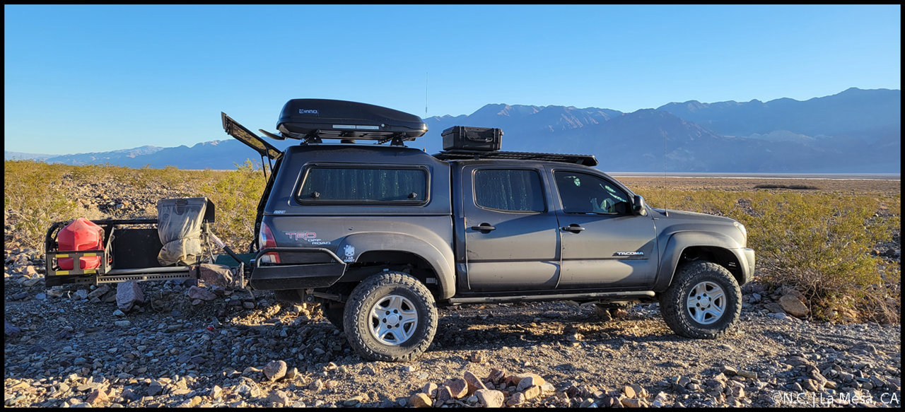

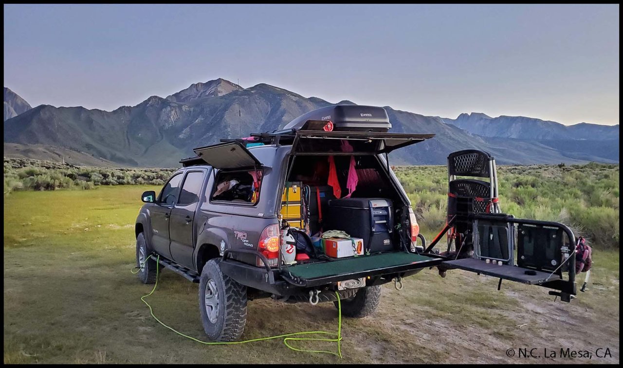

    Death Valley 2022
    North of the Amargosa Chaos, the languages of a dozen nations was heard. The salt of the earth was consumed, and a mortal spilled blood (minor injury). Prayers were said, and meditation followed. This reminded me of a quote, "We come from the earth, we return to the earth, and in between we garden." -Alfred Austin
    Mormon Point Turtleback, The Black Mountains​
    Camping in Death Valley​
    Here endith my trip report

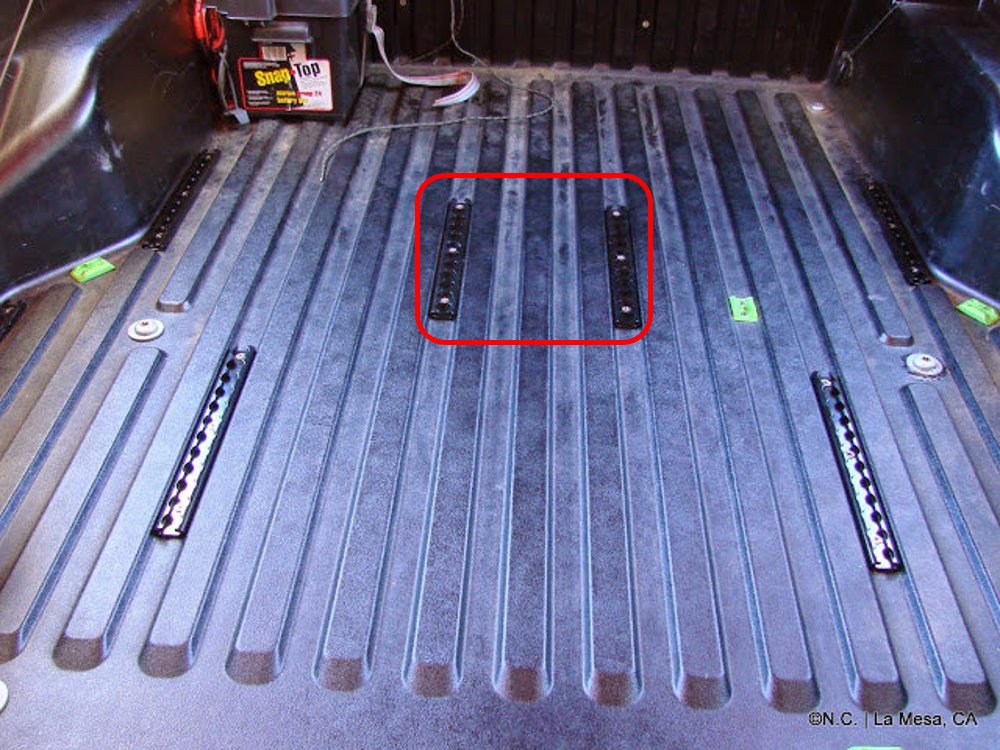

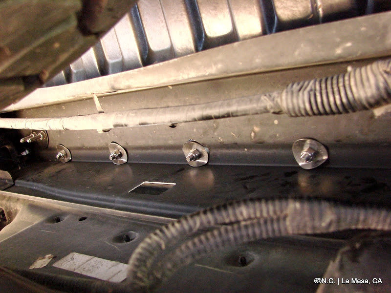

    Hey @Crom, awesome build. I'm going to be installing some L-track in the bed of my 3rd gen, taking inspiration from your setup, but had a few questions about your install of tracks towards the front of the bed. Did you install the pieces towards the front of the bed (not the vertical pieces against the cab) using locknuts+washers or rivnuts? How much clearance did you have between the bed and the gas tank? I'm probably going to mount some l-track closer to the front of the bed than yours and it looks like I'm going to have clearance/access issues on the underside and I'm wondering if I'm better off using rivnuts for those? Did you apply silicone between the l-track and the bed or at the bolt holes to help seal the mounting holes? If you were to do the l-track install again, is there anything you'd change or do differently in terms of layout or mounting?
    Sorry if I've missed the answers to these questions somewhere in this thread.

    I'm curious about your track install too.

    Thank you. The truck is doing very well. The L-Track is a smart move; good luck with your install. Yes its in here, see the quoted post below for full details with pictures. I also included a couple random pics of the hardware.
    Short answer: Stainless locknuts & washers everywhere, if you make a long reach tool. If you remove the spare you'll have plenty of room. For between the gas tank, make a tool to reach and you will be fine, my quoted post explains more. No sealing is necessary between l-track and bed in my opinion, but if you want to go the NASA clean-room route, it would only help. The holes are 1/4" and the machine screws fill the holes well enough.
    I am 100% satisfied with every piece of l-track I've laid and the locations. For my purposes the anchor points are optimized for any configuration, be it a full load out for 1+week of family trip, or a simple overnight / day trip. I can secure the load and I never have to compromise. Nothing ever moves; cam-buckles and ratchet straps hold everything down.
