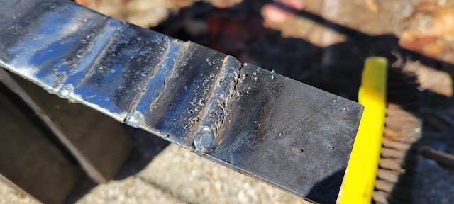

    Hi Curt, Yes. Construction is good, light weight (15lb), very compact, MIG that runs on 120VAC. It is the Easy-Flux 125 Amp Welder at HF. With a coupon it was ~$190.
    I am really happy with it. The setup was easy and straight forward. I spent about 45 minutes setting up my mask, cutting some scrap, and burning it back together. Like painting, surface prep is a critical step in welding and the guide that came with it was pretty thorough about laying out what to do and what not to do. I can recommend it.
    test welds on scrap​

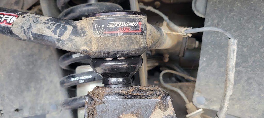

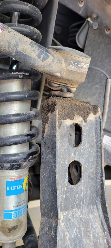

    This weekend I get to be Mr. Mechanic and swap in some new upper ball joint dust covers. I have about 20,200 miles on them. The Camburg UCA's I am running use a Moog joint which is fine, but the ball joint dust covers are trash. They have holes and I have just resorted to greasing them a few times a year as a work around. My boxed spindles will possibly make separating the ball joint stud fun :cookiemonster:
    Posts below are relevant.
    I booked myself some vacation OCT/NOV/DEC for get out time :fingerscrossed: for DV
    jubei, TacoEspecial, turbodb and 7 others like this.
  10. Sep 5, 2023 at 9:16 AM
    #4510
    Crom
    Crom [OP] Super-Deluxe Member
    Jun 22, 2009
    #18782
    9,637
    Nick
    San Diego, CA
    2009 4x4 DCSB Camp Supreme
    Millions
    In about 1 hour, I swapped in the new boot, greased the UCA's, Tie Rod, UBJ, and LBJ, for the drivers side. I still have to do the passenger side.
    It turns out the boxed spindle has an undocumented feature. The upper hole is perfect for placing two stacked pry bars for leverage when separating the UBJ from the boxed spindle. No special BJ tools required. :thumbsup:
    This boot will work, and is extremely durable it came with a Delrin bushing which I used. It should last forever.
    I will probably grease the LCA bushings and the whole front end will be ready for more miles.

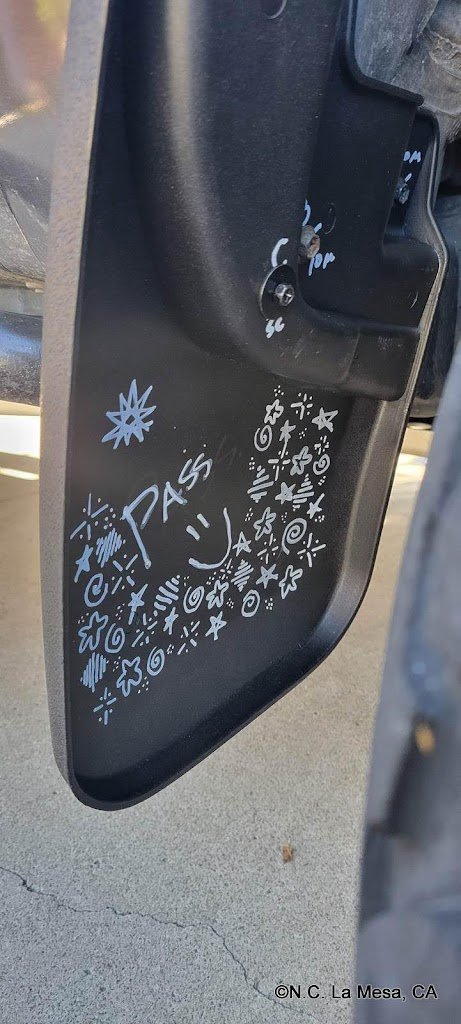

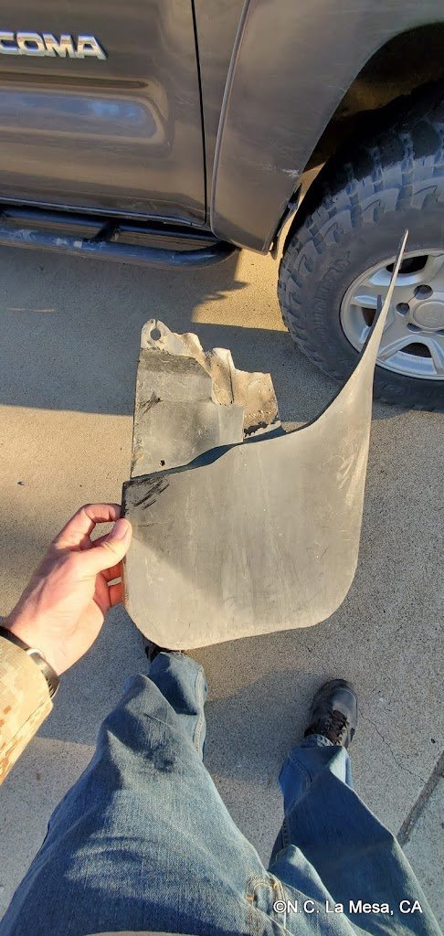

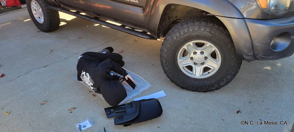

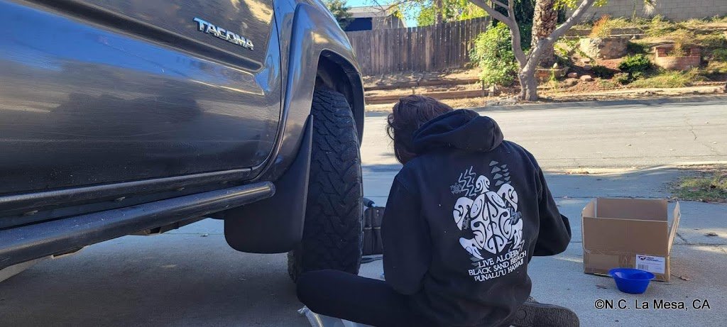

    Passenger Mudflap Replacement 2023-12-17
    1,117 days, 3 years, 22 days
    The mudflaps are a sacrificial barrier and are essential to protect my doors from being rock blasted. Unfortunately I reversed over a boulder in this canyon back in November 2020 and the mudflap was destroyed. The driver mudflap is in poor shape but still in one piece.
    My 13 year old installed the replacement today. She did a great job, I didn't even need to check her work beyond a visual inspection
    LMFAO her using packing material instead of automotive creeper. Being perhaps a typical teenager her schedule is beginning to resemble a vampire. She laid there on her phone until I gave her the paper instructions to complete the work. :laugh:
    All ready for the tire shop tomorrow.

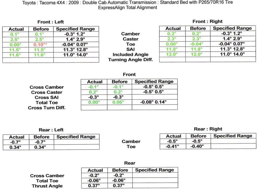

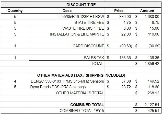

    New Toyo Open Country LT255/858/16 Tires @ 87,820 miles
    I am very happy to have new truck tires. I had the tire shop dismount and install the new tires. They had four techs working simultaneously to get it done fast. They got the job done, but marred one of my wheels pretty badly with the machine that holds the wheel. It was a new tech, and he clearly needed more training. That is the unfortunate side effect of having shops do work, it seems like its always a mixed bag of what level of service is received.
    The tires are great though and I repeated my prior set up with new Denso TPM sensors, and Dyna Beads for balancing. The truck is glass smooth all the way up to 95 Mph.
    I had an alignment done at alignment shop, and the tires saw dirt within 24 of mounting in Panamint Valley, USA
    A full accounting of Tires and parts above.
    I received a 0% Promo APR for the tires. I have the cash in money market earning 5% APY. I will make minimum payments to the bank, and then pay them back with inflated dollars at the end.
