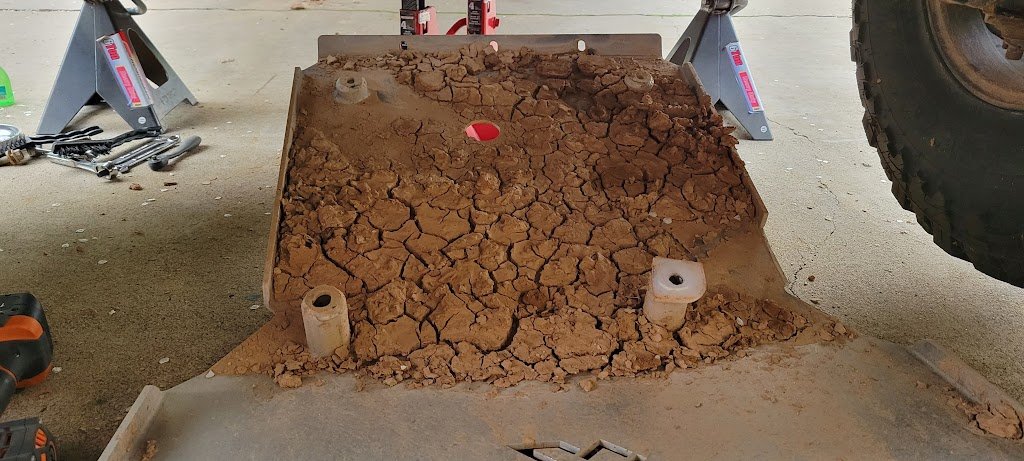

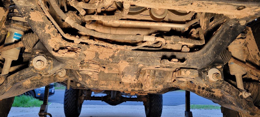

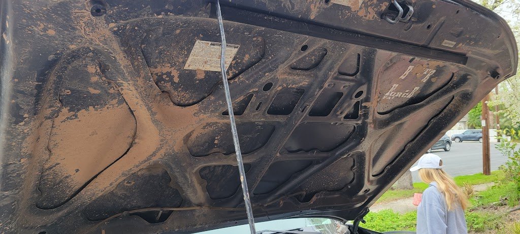

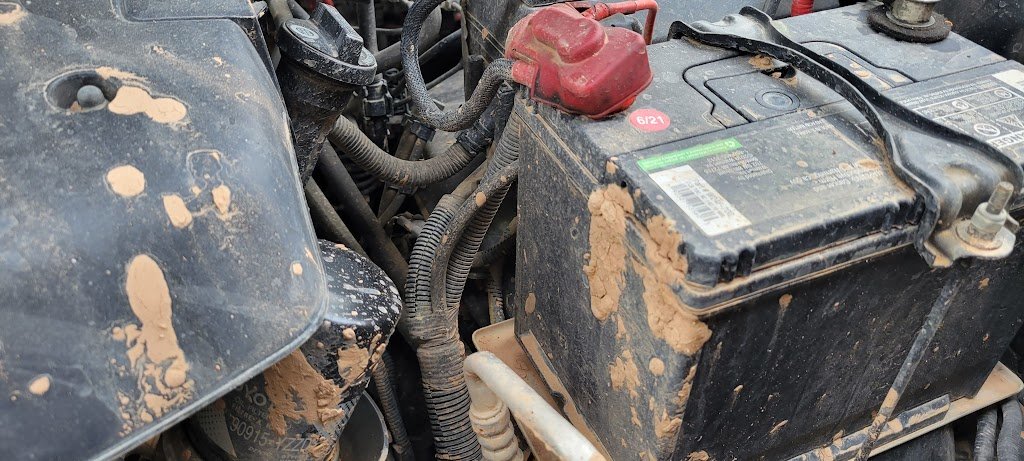

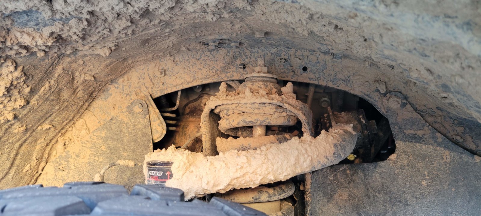

    Thanks guys. Words fail. The Amargosa clay is the gift that keeps on giving. It is in my yard, my street, my sidewalk, my neighbors yard, my driveway, my garage, my clothes, my shoes, in my washing machine. I am pretty sure it is in my blood stream because it went into my eyes and lungs. Haha.
    I have a combined seven hours cleaning the undercarriage, engine bay, bumpers, frame rails, cross members, body cavities, exhaust manifolds, skids, gas tank. This does not include the 2 hours of pressure washing the exterior and wheel wheels, axles and suspension from three weeks ago. I am convinced the truck may never be the same again. lol
    It is baked onto the exhaust manifold and even with 2000 PSI pressure washer with laser attachment, it is difficult if not impossible to remove some bits. Unreal!
    I still have some more cleaning to do but I believe that the worst of it may be done. I have a new serp belt to go on, and I may need new bearings for some pullies.

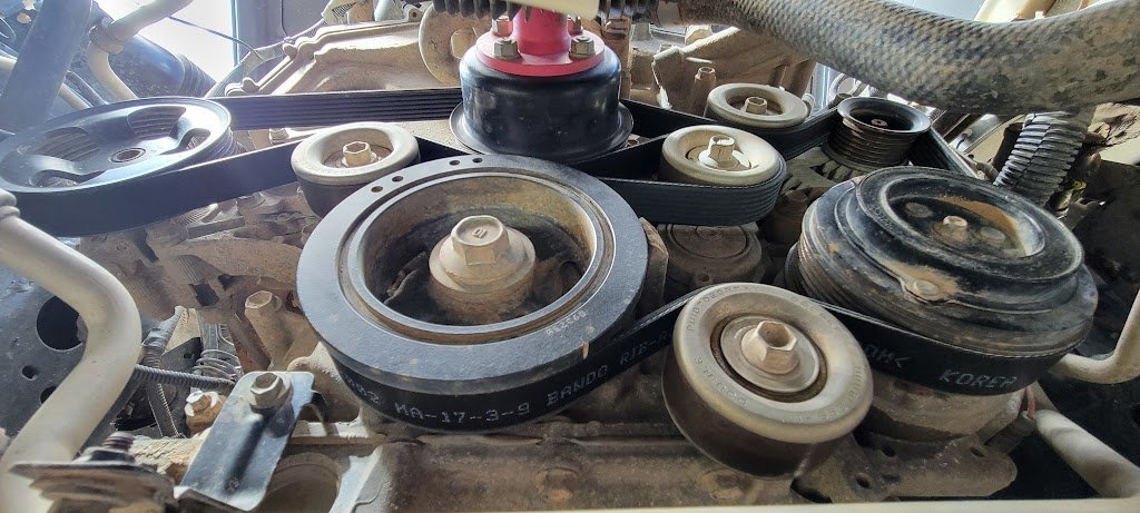

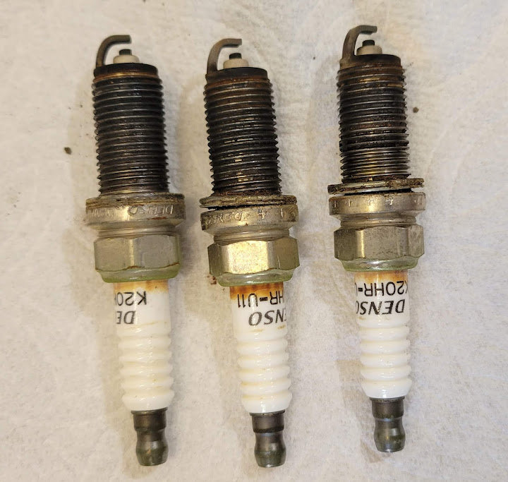

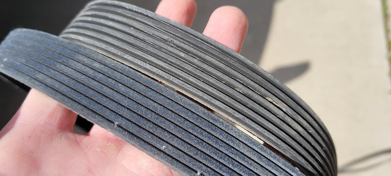

    The 90,000 mile maintenance has begun
    My youngest 11 year old helped me swap out the spark plugs on the passenger side and I did the drivers side a week later. All plugs were in fanatic shape.
    6 x Chinese made Denso went in, gapped at .43 (no pic)
    New Bando Serpentine Belt model 7PK2120 went in, just like last time.
    It took me two more hours of cleaning before I put the belt in. Still mud in some places but the belt and pullies are good. There a oil weep appearing by the AC pully not sure what it is, so I will keep an eye on that.
    Old belt / New Belt - about 50K miles
    Also, I found several pounds more mud between the cab and transmission which was my favorite. So much fun!
