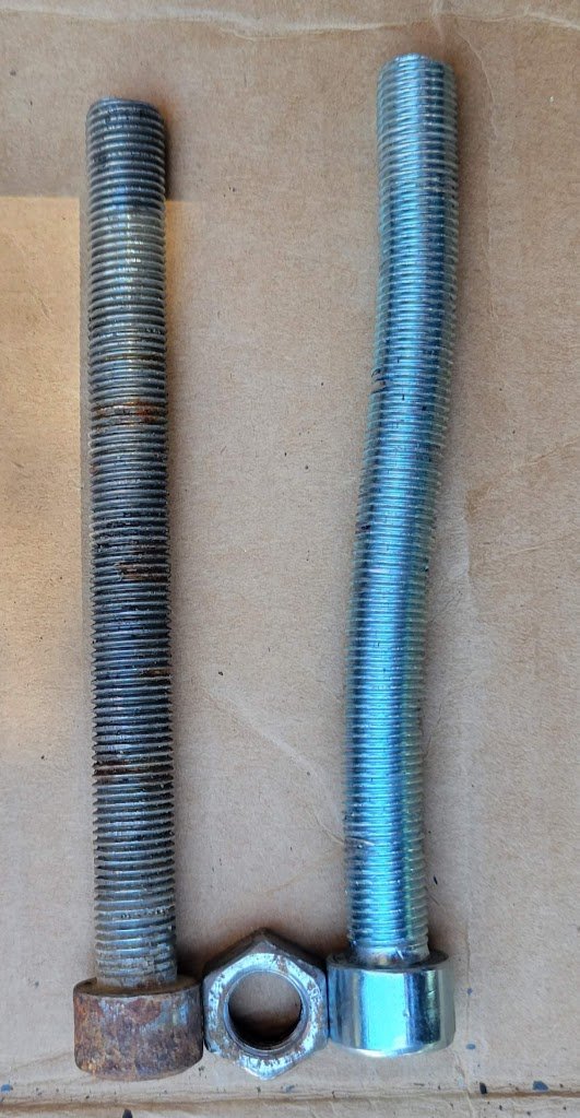

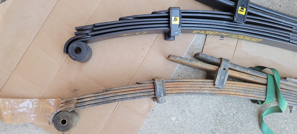

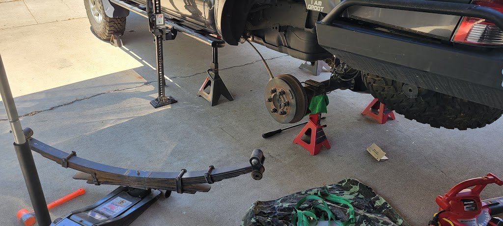

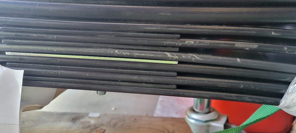

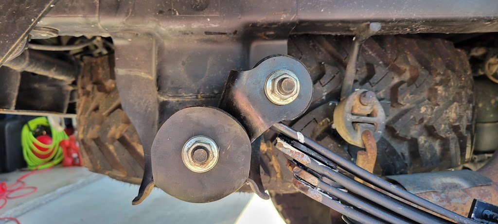

    I started refreshing the rear suspension
    Pulled out the driver side leaf pack and shock.
    When comparing the replacement leaf pack to the old, its clear that ARB / OME made some improvements to the design. However, I don't get why they added a bunch of leaf spring spacers between the leaf's, that just added unnecessary thickness to the pack. I took them out. And I am glad that I did, the leaf pack center pin was all deformed! I am guessing it was abused when it shipped from place to place before arriving at mah house. I resued my old center pin, and recovered the 3* axle shim from my old leaf pack and rebuilt the replacement pack. I also used an angle grinder to taper the rear leaves because I believed they would bind in the shackle. OME made the supporting leafs longer for some reason and they just wouldn't fit into the tapered part of the shackle, I so nipped off some material with the grinder and seems to be okay.
    Finally, I picked up some naked shackles and drilled and tapped them for a grease fitting. Thanks @EDDO for your post on ordering the part 04005-65104. Actually my oldest kid did the drilling with a drill press, and I tapped them for 1/4" x 28 thread. The tap and die set I used was probably as old as I am, it was made in Japan, and was quality tools that were my Dads.
    I expect to finish the leaf packs this week and get an alignment shortly after.

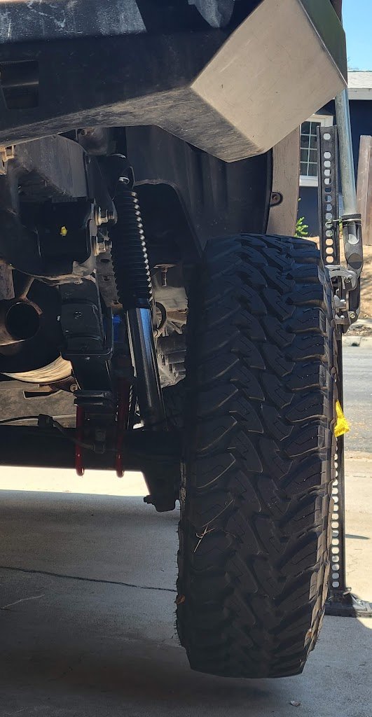

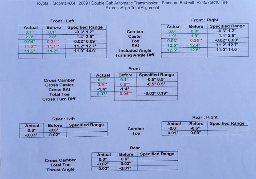

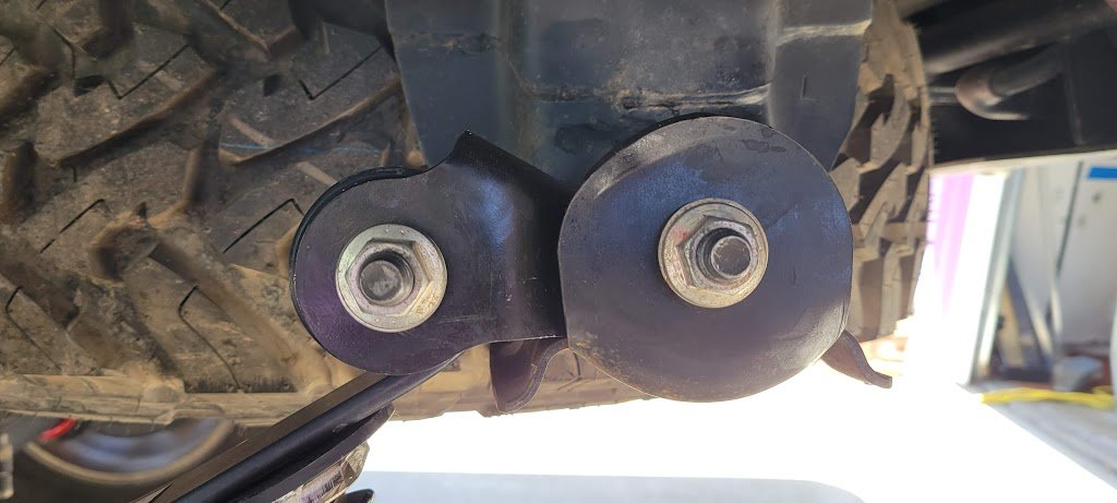

    I finished replacing the rear suspension. Both my daughters took turns helping on different days and our time spent together was great.

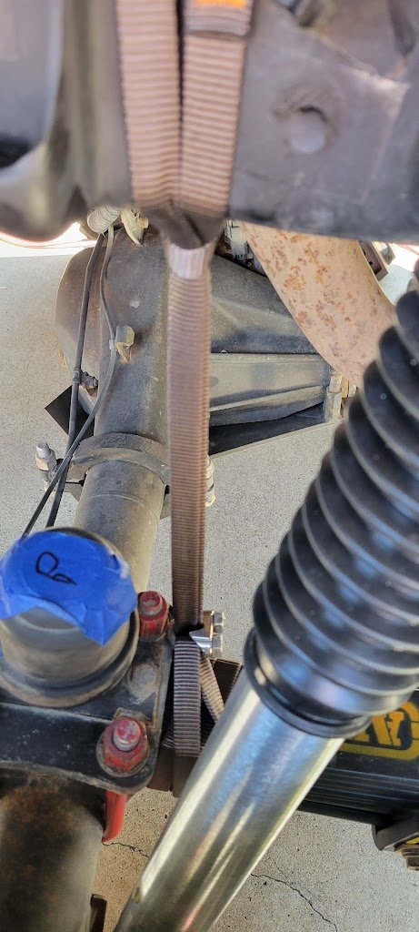

    The greaseable shackle enabled the spring pack to travel down more, which became my new issue to solve. The shock bottoms out before the spring pack does. :mad: So I made some limit straps to protect the shock.
    ^additional travel gained by greaseable shackle; shackle rotates all the way until making contact with frame
    Test fitting limit straps to control shackle angle.
    ^Custom limit straps
    ^limit strap engaged with shock near full extension. :)
    ^Leaf pack measurements while working
    ^Post install

    Nice. Shop time with the kiddos is always a pleasure. At least for me, it's become rarer as she's grown and has her own interests; glad yours are still involved!
    You're surely aware of this, but actual limit straps are going to be a necessity. While ratchet straps will work for a short period of time, they will quickly stretch out and simply won't be up to the task in an environment like that. Even with "real" straps, I've gone through a few since I installed them 5 years ago. I picked mine up from Kartek, but I'm sure you can get them elsewhere as well.
    ...or longer shocks, if you want to take advantage of that extra travel!
    :bikewhoops::bikewhoops::bikewhoops:

    Yep. Thanks. In my case I was outta time, so I used a rated endless climbing sling in a choker configuration. We'll see how it holds up.
