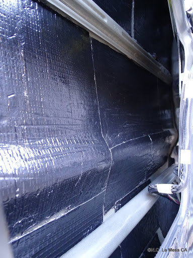

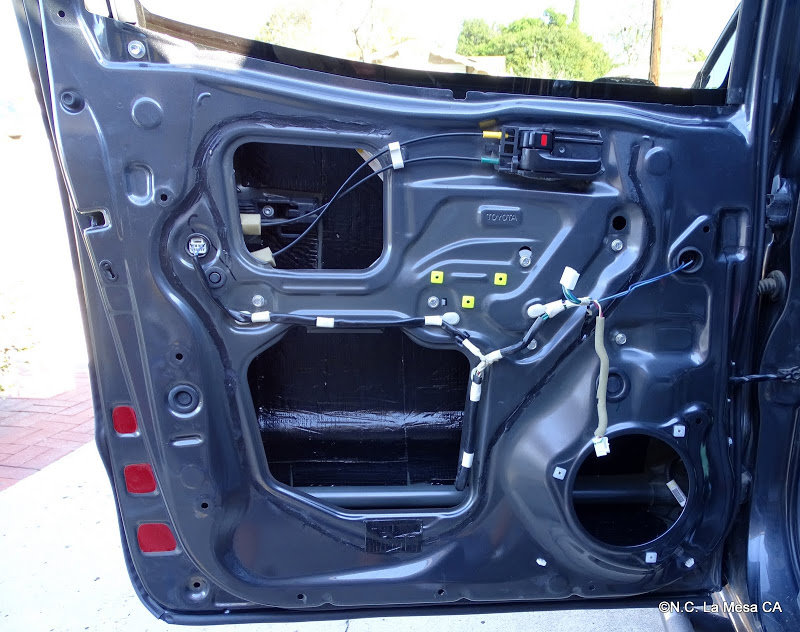

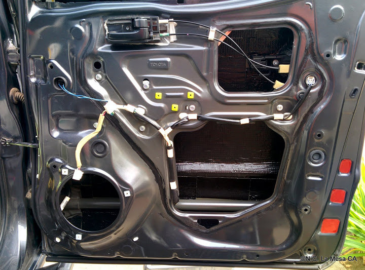

    Quick update. I got one of the doors mostly done today. Words can not aptly describe how amazing my door sounds when I close it. The "thud" of the closing door screams luxury!
    -Lots of prep work cleaning dust out.
    -I installed the Noico sound deadner stuff (automotive butyl and foil), I'll call it mat. It's 0.65 lbs / 1 sq ft.
    -I covered all the inside of the outer door skin with mat.
    -I covered most of the backside of the inner skin with mat.
    To finish this door, I need a filler material to fill the holes, rigid plastic, sheet metal, etc., then a little more mat, some foam, and then the mass loaded vinyl (MLV). I have everything but the filler material.

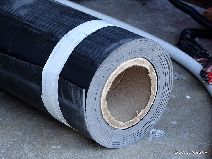

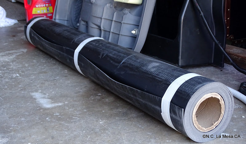

    Here is a shot of MLV. I got a 4'x10' roll. Shit is dense, 40lbs total.
    Best sound barrier there is for the application! It's 1/8" thick and 1lb /sq. ft.!

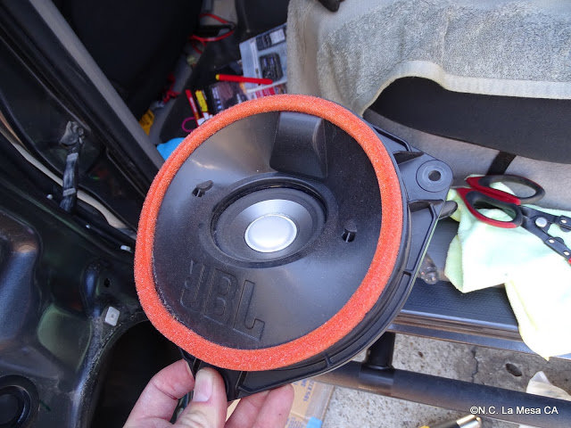

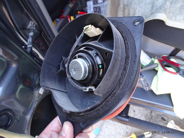

    Also, the JBL speaker is a real disappointment to see up close. It super light weight and small. :(
    It's still going back in, but maybe one day I'll upgrade.

    $60 Noico Black 80 Mil X 36 Sq Ft Self-adhesive Foil & Butyl Sound Deadening
    $119 Mass Loaded Vinyl 4' X 10' 40 Square Feet 1 Lb MLV Acoustic Barrier
    Those two things above make the most difference.
    I also bought some foam. The function of the foam is to isolate, separate, or "decouple" the layers in the door.
    $55 Noico Liner 37.5 Sqft Heat & Cool Automotive Insulation Pad, Foam Self-adhesive.
    The foam is expensive for what it is... For what it's worth, I'm going to go ahead with it and follow the path.

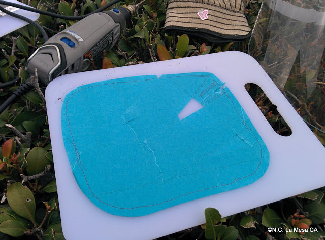

    I'm not saying, I'm anything close to Bruce Lee, but that's how I feel about finishing deadening another door!

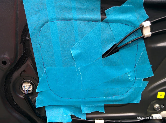

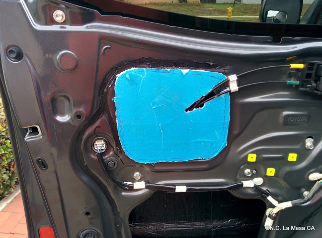

    Wally world supplied me with some HDPE plastic in the form of some $0.88 cutting boards, about 1/8" thick. Perfect!
    Used tape for a template. Trace.
    Transfer to material.
    Pretty simple.
    Got to do the big lower hole, and then it's MLV time!
