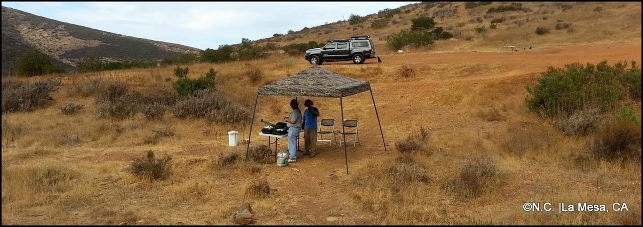

    In addition to a boat load of camping and exploring I love to target shoot. And the Tacoma is great for reaching far away places for shooting. Pics from earlier this year.
    My friend
    IMG_20150221_083905%2525252520-%25252525_d970392fae416b7a78a94d5ad20705e96ad76f6e.jpg
