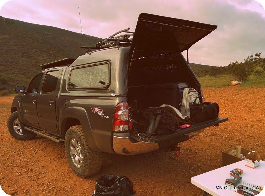

    Crom: what is the reflective material you have in your shell Windows? How did you affix it?
  11. Nov 20, 2015 at 5:56 PM
    #611
    Crom
    Crom [OP] Super-Deluxe Member
    Jun 22, 2009
    #18782
    9,642
    Nick
    San Diego, CA
    2009 4x4 DCSB Camp Supreme
    Millions
    Reflectix insulation. It's just pressed into the recessed portion of window frame.

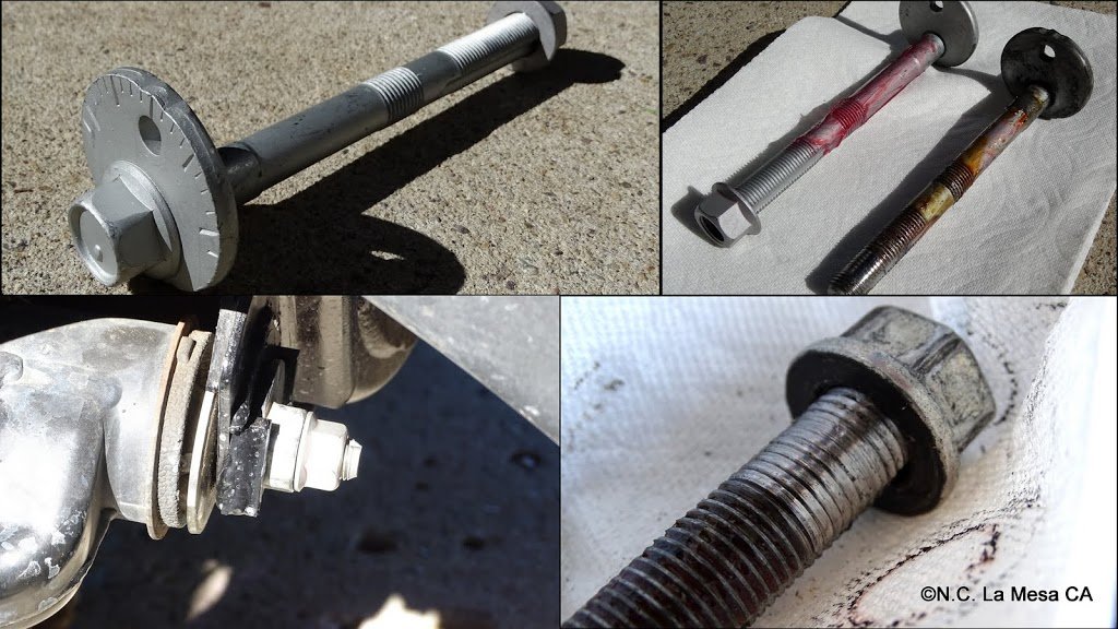

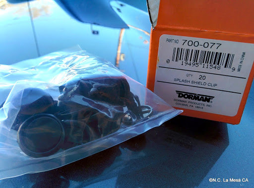

    Truck update.
    • El Nino, bring it, I got new wiper blade inserts! :p
    • Lubed all exterior locks
    • Used a heat gun to push back fender liner, make room for tires.
    • Added some more weather stripping to complete my auxiliary weather seal project.
    • Painted some stuff.
    • Found and eliminated a new vibration on the truck, was factory mid skid vibrating into front diff at low RPMs. Removed and beat the living daylights out of skid with 4lb hammer. All good now.
    • Installed new camber bolt on drivers side LCA. The original bolt gave up the ghost and is stripped to shit. $17 dollars at stealer. I tried the BGR method of removing the bolt but was unsuccessful. Had to pull the tire off, but that was all. Loving the impact gun, zip! zip! Bonus! The stealer did not have the camber nut in stock, but I had two brand new UCA nuts, and they are better than the LCA, so used that, so lucky!!! :amen:

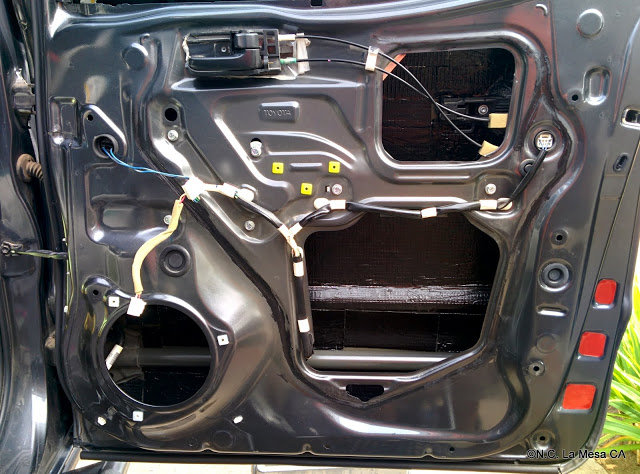

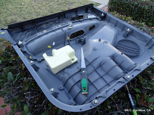

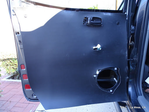

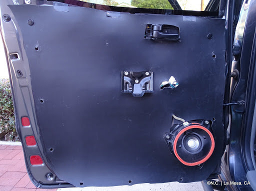

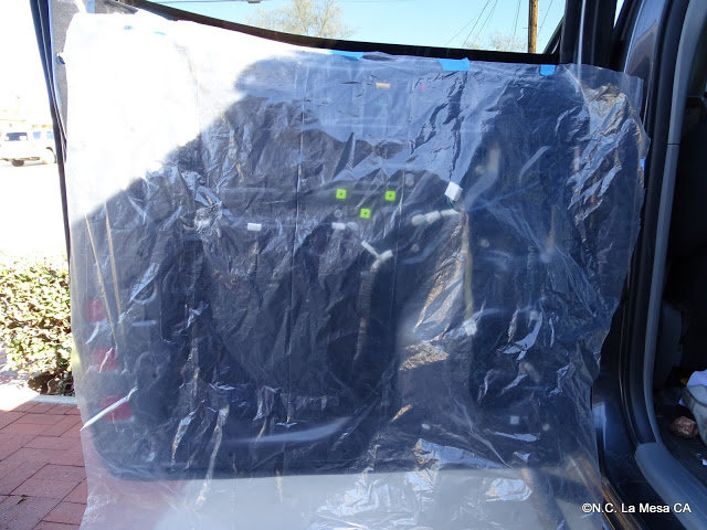

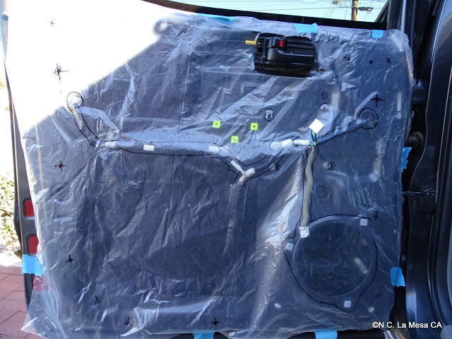

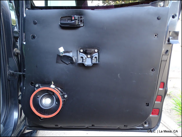

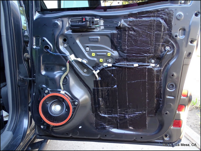

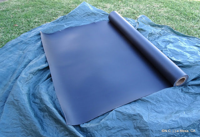

    Here is a quick explanation of how I'm doing my doors.
    Deaden the outter skin with Noico Mat (damper / sound deadner), then cover that with Frost King duct insulation. (not pictured).
    Then I greased the square nuts for the window track with grease. I also greased the window lift motor gear, and the scissors lift joint. Those things haven't seen maintenance in 6.5 years so hopefully the grease will prolong the window lift motor life.
    I deadened the outter side of the inner skin which you can't see unless I put the camera in the door.
    Then I sealed the holes.

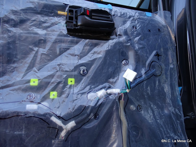

    Do whatcha can with whatcha got. I found some plastic in my garage.
    Not knowing what I am doing, I started drawing on the plastic.
    Made some random marks all over.
    Rolled out the 40lb roll of MLV, (Oh, my back!)
    Transferred the plastic to the vinyl and cut out shape. (no pic)

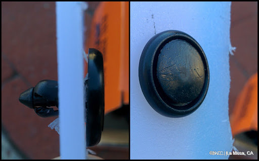

    Then moved the cut out to the door, to test fit. I drilled two holes in the door 1/4" in size, and then painted the holes. The holes for some plastic pop rivets which hold the vinyl to the door. I used some Dorman 700-077 plastic clips.
    I tested them on some 1/8" plastic first.
    Test fit good so used them.
    Then I went about making new holes and trimming.
    Starting poking more holes.
    When I was happy with it, I took it down and traced the pattern out on a fresh cut of vinyl saving precious time. The reverse of the pattern fits the other side of the truck. :thumbsup:
    I was a dumb ass and tried to force it together, didn't break anything, but it turns out that I had too much vinyl around the clip holes. They have to be trimmed like in this photo. This was my final product the the passenger side.
    The last step was to use a drywall knife to rake the Styrofoam in the door panel. I had to shave it down about 3/8"
    Two doors done!
