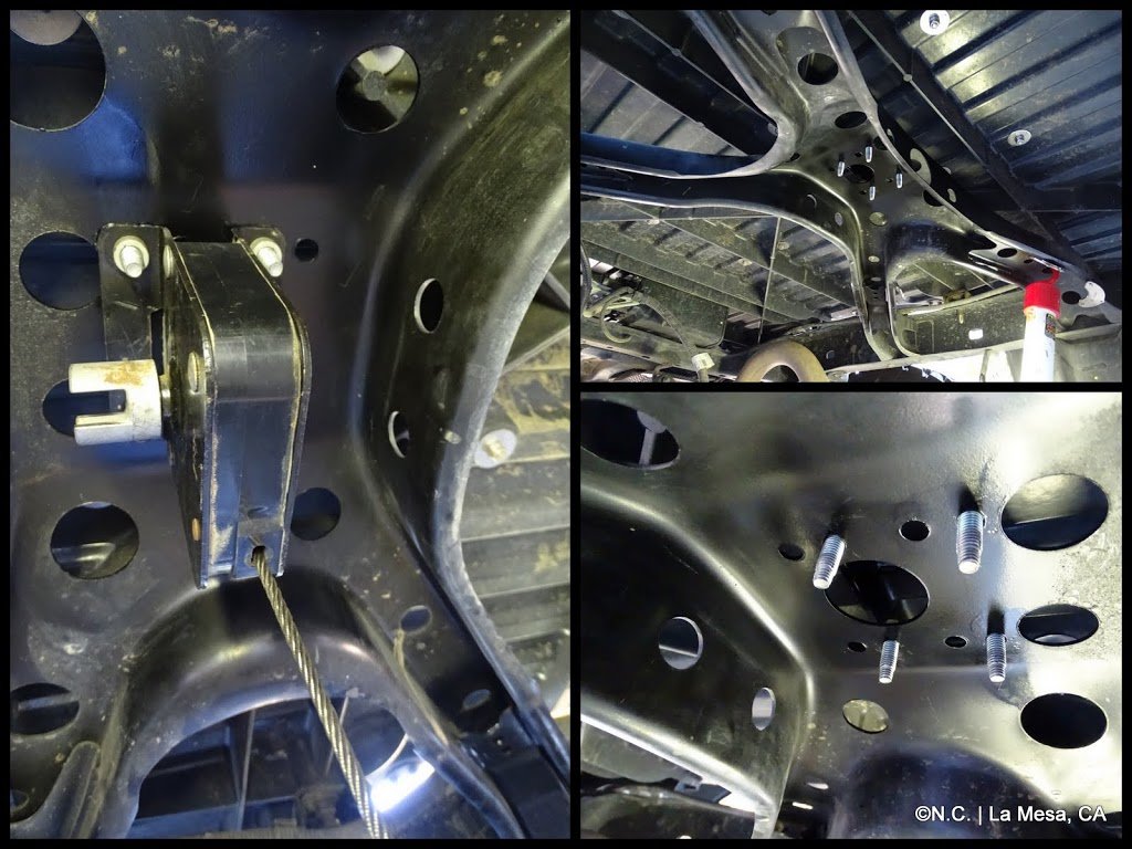

    The stripped bolt was my fault.
    When I greased the bolts for the very first time in 2013 I failed to clean the threads with a wire brush and it got all fubared up :facepalm: This weekend I backed the nut off and upon tightening, it let go on me. Easy fix though, and I'm glad it was in my driveway and not BFE. :)
    I am long overdue for some proper skids. One of the first things I'll do after gears is skids.

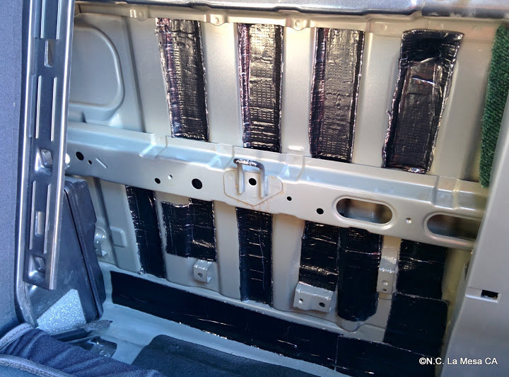

    Hey @Crom ,did you ever figure out a mounting solution to the rear cargo area (behind the rear seats)? I've read through your current soundproofing project and you decided not to replace the plastic bins, but was wondering if you came up with anything. I really wanted to get in on the aluminum Molle panel, but it looks like that product is on a hiatus at the moment. Then I got to thinking about your l-track solution for the bed. I figure it's modular and can be reconfigured quickly for each trip with specific gear if need be. My only concern (I've never worked with l-track) is do the mounting rings and brackets rattle at all? Perhaps when they wear? That would get old really fast... Thoughts?

    What you saw in that pic is Mass Loaded Vinyl. It is the very best way to block noise.
    Four lines of attacking noise are:
    1. Dampen, which changes resonance by adding density.
    2. Decouple, by adding foam which separates layers and helps stop vibrations from being transmitted.
    3. Absorb, special foam.
    4. Block.
    Of the four attack methods, blocking is the most effective at stopping noise; and absorbing is the least effective in an automobile.
    Best site for a solid education on the subject is http://www.sounddeadenershowdown.com/ Everything is based on scientific research and experience. Absolutely solid, free education.

    I thought about laying some track down there, holes can be drilled through the floor and washers and nuts applied from below. A couple 2" or 6" pieces could be really effective.
    Also, by looking at the pic below, you might be able to attach something to that support bar and use it for tie downs, like eye bolts. That would be pretty easy I would thing.
    My plan for back there won't be storage though. The kids car seats prevent me from getting back in there for any length of time. I will eventually put the air compressor back there, just like mr grimm did his.
    Strangely enough I got back there today and put some strips of damper product in there.
    Child cut them strips faster than I could install them! She did great helping me. Made her feel really good about her work.

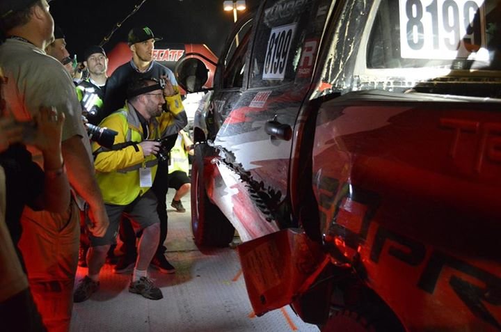

    Paul, Thanks so much! With two posts you have single handedly increased the awesomeness factor in here by 10,000%. So much win in you pics and experiences. I'm going to share your pics with my family today... :D
    And just wow at the pics! The truck at the finish line, is that a sheet metal rip down the side?

    The rip was from a pass in a silt bed. The chaos that ensued afterwards would take a 30 page thread to share so I get will have to wait for a campfire.
