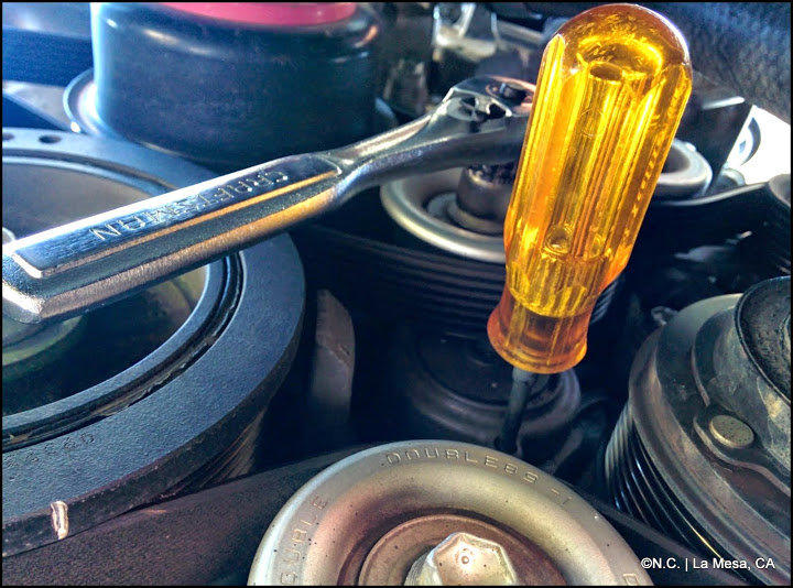

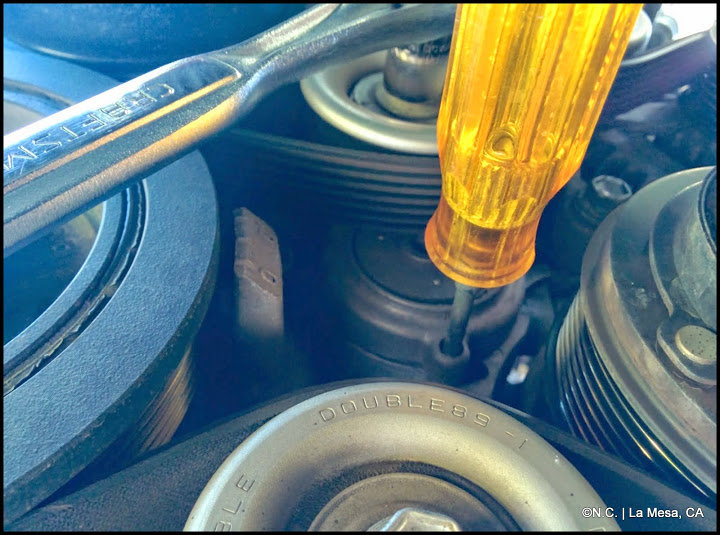

    An August 2014 at about 50K miles I replaced my OEM serpentine belt with a brand new Bando 7PK2120 OEM Quality Serpentine Belt.
    There is no provision from Toyota to change it, but I wanted a new one anyways. I was always worried that the desert dust was doing something bad to the belt.
    I got a number of things from the experience. Mainly a trail spare, and a serpentine belt diagram, something that is not documented in our owners manual or under the hood! It would be stupid to get stranded because of a bad belt and not have a $20 part to self rescue.
    Now I have the part, experience, and the diagram. :)
    The Bando product is legit.
    I've got 18K miles on it now (July 2016), zero issues. :thumbsup:
    Routing diagram for 2nd Gen Tacoma
    2005_Tayota_Tacoma_4.0_Serpentine_Belt_0_3e2669bc055b020503b40262e0f94e46fcaf28b2.gif
    Used a ratchet on the belt tensioner to align the hole to place a screwdriver in. Then take the belt off and replace.
    Install is very straight forward after reading Derk's instructions.
    A closer view of the screwdriver locking up the tensioner.

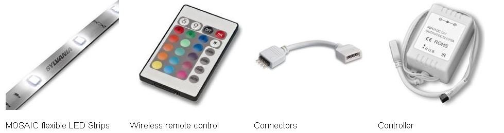

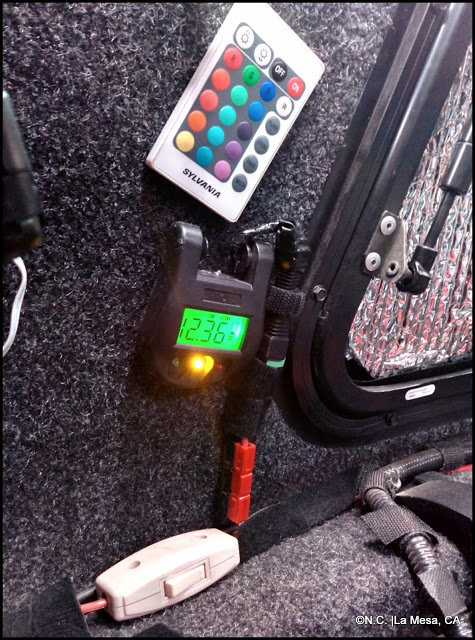

    In Jan 2013 I wanted to do something fun with shell lighting in the back. It was around Christmas time in 2012 and my local Costco was carrying some Sylvania LED strips. I looked at the package carefully and I could see on the rectifier that it's output was +12V to the controller. I seized on that immediately and bought two packs. One was for in the house and the other was going into the truck.
    I believe that this is modern equivalent of what I bought Sylvania 72344 Mosaic Flexible Light Kit for $31
    These are the parts it came with:
    Here is what it looks like in the back of the truck.

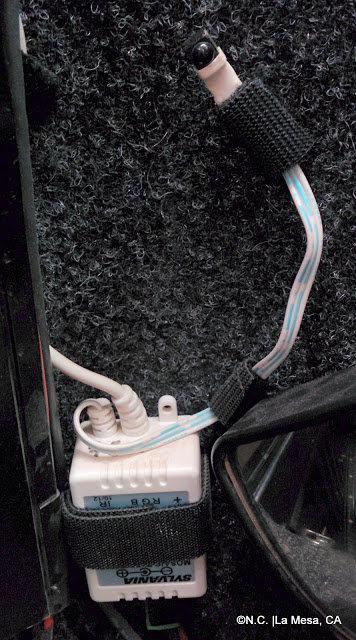

    The controller takes a barrel connector style power fitting that I picked up from Amazon and wired the circuit through a normal lamp switch and then to the Blue Sea fuse block.

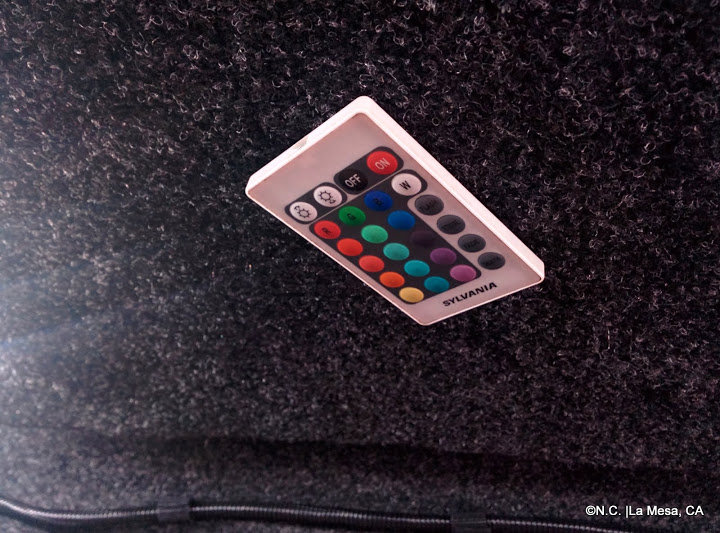

    Switch and remote pictured below.
    What is really neat about the controller is that it will remember the last color it was programmed to display. So when the switch is activated you get what you had last. This is really great!
    Here is a pic of the controller stuffed into the corner of the shell. I use velcro to secure everything and it does a good job.
    Welp, because I have small kids and the remote is wireless, often times the remote winds up in really weird places like the roof.
    I have very strict instructions for the kids, that after they are done playing with the lights, they have to return them to white color, put the remote on the wall where the switch is, and turn off the lights with the switch.

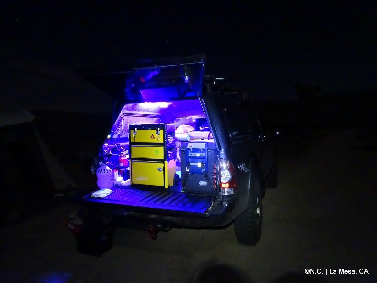

    It has taken a lot of time, but they are pretty good about it now. I used to not let them out of the back until they found the missing remote and put it back. :D
    And here are a couple live action shots from one of our last camping trips. Purple is a favorite color of the youngest kid and somehow she was winning against her older sister for battle of the lights. lol
