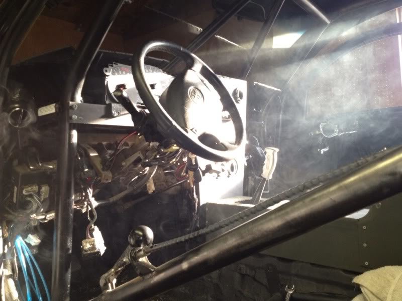

    Tell me more on this manual shifter? Can you bypass the electronics and put in a stick? It do you have to swap in a whole new tcase?
    I really need to dig through your thread man. I had the ABS kill on my 08 sport but didn't do it on my 15. So many buttons to turn off/ on shit and I didn't want to start modifications to that stuff yet. I haven't noticed the issue with the brakes off road like my 0i. My 08s ABS was a noisy bastard off road in sand.

    I edited the post above to include a picture, under the picture is a quote by "username" that's Logan. Follow the quote to his build thread. He is very talented at creative problem solving. He calls it Hillbilly Engineering. :D. His build is a fun read, read it twice now.

    Some random food for thought:
    I was very disappointed that my Tacoma came with an electronic t-case shifter. And I was jealous my buddy's 4Runner has a manual t-case shifter. Six years later I can report I have had ZERO issues with the electronic shifter. Yet I have had friends with different vehicles have their manual shifters fail on them. In one case we were able to eventually get the vehicle out o 4wd. In another, the vehicle had to be towed home once we got to pavement.
    Crom[OP] likes this.

    Very interesting indeed. There is a writeup around here on how to disassemble the electronic 4WD actuator and solder the contacts.
    For whatever reason Toyota didn't use any solder the electrical contacts are merely pressed into place and held in place by friction which is a problem over time.

    Maybe, maybe not. There might be some value in having flexible connections for automotive (read high vibration) applications. Kind of like how you don't want to use sold wire for automotive applications.

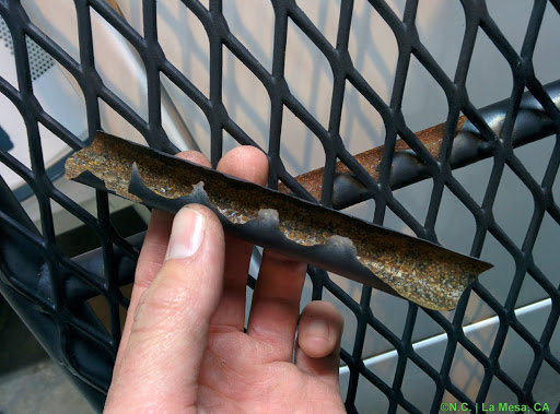

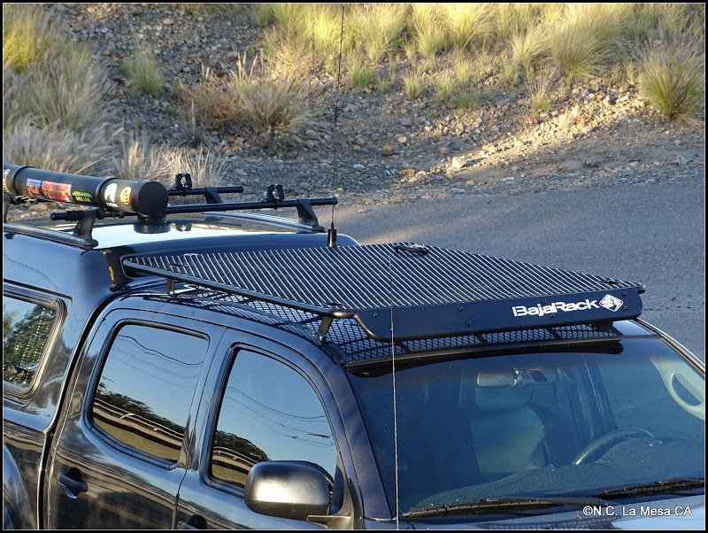

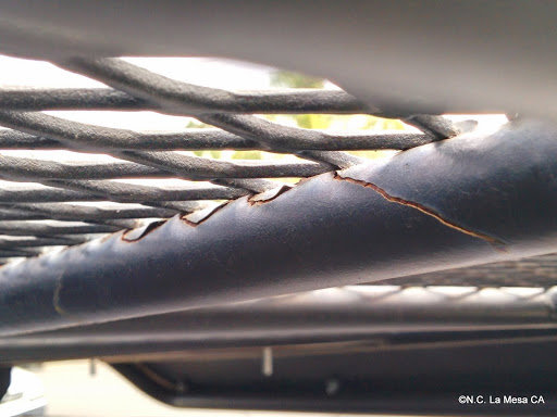

    Short version. I filed a warranty claim with BajaRack over rust and they opted to build a new rack for me.
    I'm going to tell a short story about my joy and pain. It started in 2012. I ordered a custom roof rack from BajaRack. The only thing custom was the floor. When I got the rack, I installed and for my loss, the roof brackets were too short. They acknowledged the error and made new taller roof brackets which I had to grind down and make more narrow, they were too fat, and then I had to paint them. Then I installed them. It was then I noticed the rack was shaped like a banana. They took it back and made it straight. Then after getting the rack wet, I noticed rust on it. After some dialog, I agreed I'd hit it with spray paint and they'd honor any future issues.
    I have always loved my B
    ajaRack and it has performed really well for (3) years.
    Now 2015 and I see this:
    This sucks.

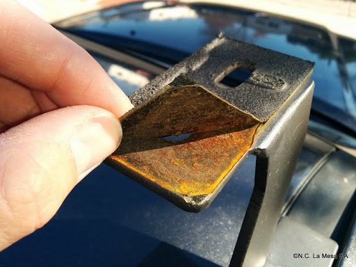

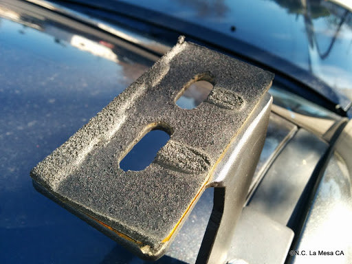

    Once the above happened, I took a real good look at my roof brackets.
    Look closely.
    Do you see it?
    Three out of four brackets were like the one pictured below.
    My guess is they didn't clean the metal properly prior to powder coating. Isn't that like Fabrication / paint prep 101?

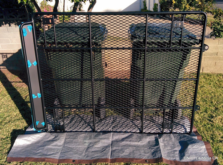

    Anyways, after a few weeks I pick up my rack from their distribution center. The rack was new. I didn't really expect a new one, but they made it new. And I get home and unpack and guess what? I put a level on it and this one too was also shaped like a banana. :( It had to go back to get straightened. Once I got it back I got it wet and noticed rust.
    Powder coating something like expanded steel mesh welded to tube is difficult. Lots of nooks, tight spaces and voids. I can accept that. As long as the god damned metal is prepped properly before powder coating.
    I picked up two cans of this.
    Sprayed 1.5 cans in all the nooks and crannies.

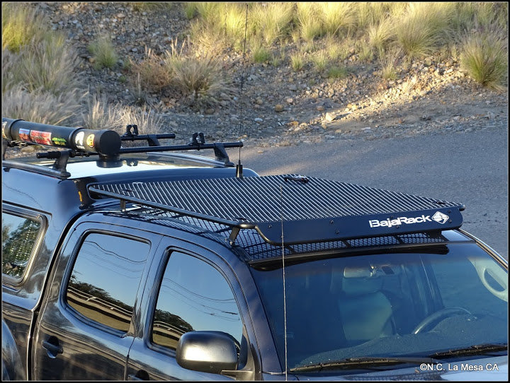

    I replaced all the roof mounting brackets with new ones. My neighbor helped me lift the rack back onto the truck.
    I'm happy to have my rack back, but what a pain!
    BajaRack's customer service is very honorable and good. I wish their attention to detail, and control over product manufacturing was at least as good. Nobody should take what I write as a jab at BajaRack. That's not what this is about... I'm just sharing my experience having been a customer since 2012. I am grateful for the solid customer support.
    I hope this rack lasts as long as the truck does! If I have to do again, the next version will be aluminum!

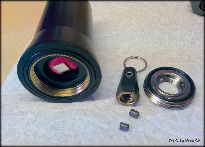

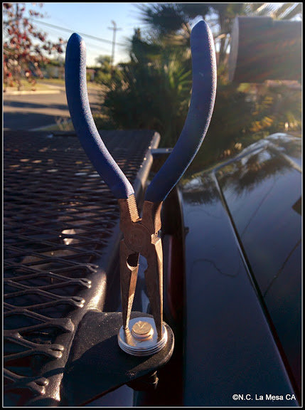

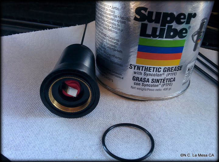

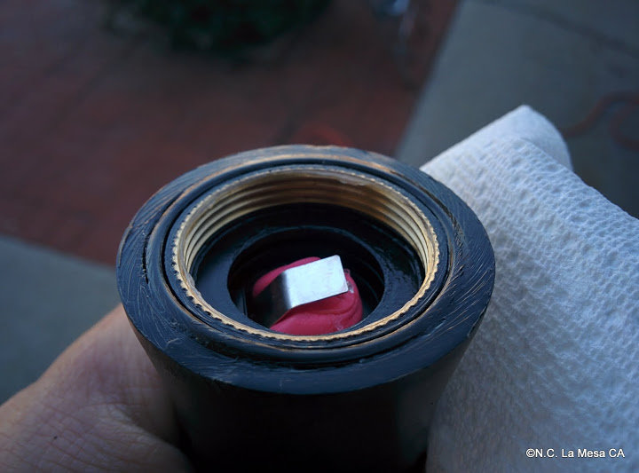

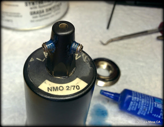

    When the BajaRack came off, so did my solar panels and my Larsen dual band antenna. My antenna was in worse shape than I had realized. This gave me an opportunity to rehabilitate it.
    The whip part of the antenna is held in place inside a brass cone nut by two steel set screws. They would come loose over time, presumably from off road vibrations. I've never lost a whip, but it's not good having it flop around in there either.
    I thoroughly cleaned and inspected everything.
    Applied some thread locker to the screws and torqued everything proper.
    I really like this grease when I need a non-petroleum lubricant. Food grade safe!
    One day I'll get a spanner wrench.
    Back on the truck!
