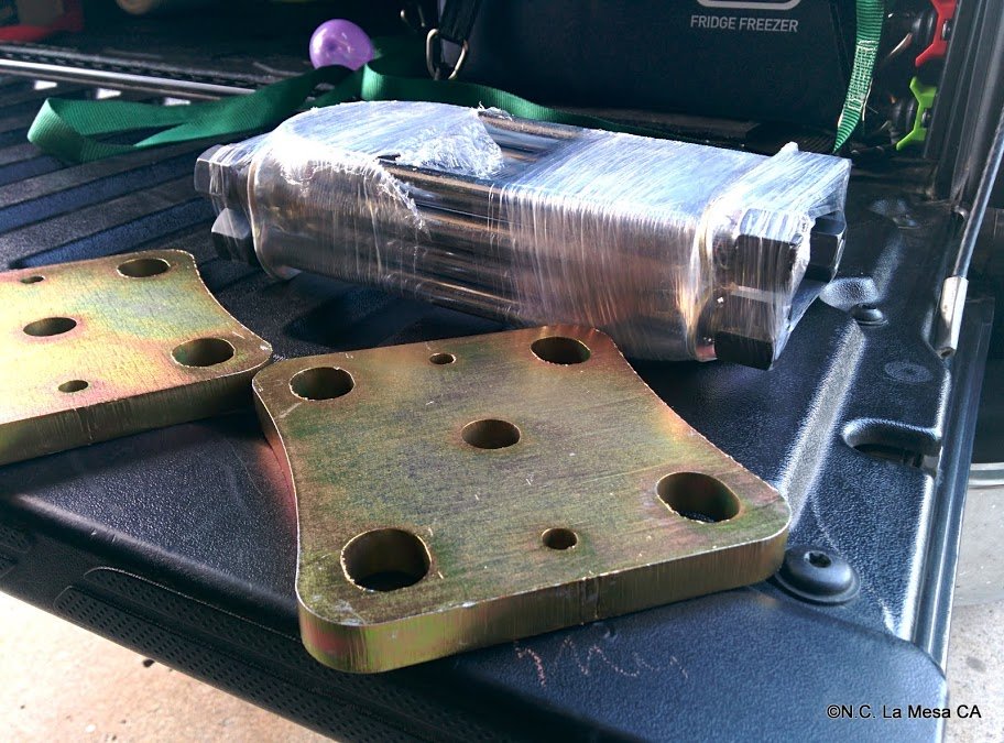

    I also have been working hard to 'prefurbish' the OME Dakar leaf pack.
    • I've taken them apart,
    • cleaned them,
    • repainted them,
    • lubed them with Dry Moly Lube.
    • I discarded the extra overload,
    • added the D29XL AAL,
    • added a 3° axle shim
    • I reassembled the leaf pack,
    • cut the bolt short.
    • I also added "OZ-T's EPDM" pond liner patch between the leafs that had no silencer pads. Thank's OZ!
    In hind sight, cutting the bolt is unnecessary, and the pond liner stuff didn't last long at all. I'm currently using zip ties to separate the leafs to make them quiet.
    The reason I ditched the extra overload, was because I didn't want the extra "lift" in the rear. I added the AAL for extra load carrying capability. The axle shim plus AAL height made up for the missing overload height, so my leaf pack yielded about the same as a normal Dakar pack would have.

    So I took out the extra overload leaf which is about 1/2" thick, I added a 3* steel shim, and also added the OME AAL. I think my 'custom' arranged leaf pack will provide about the same 'lift' that one would expect from a normal Dakar leaf pack. I wanted the stronger-stiffer leaf pack, hence the AAL. My hope is that the truck has a bit of rake when I'm not loaded--just like a factory setup, but with more load capacity.
    So I may have been too quick to shorten the bolt, but I don't think it will matter. Yes it's for the U-bolt flip kit, and fitment of the bump stop. I cut the leaf pack bolt so that it will sit flush with the center hole pictured below. What I didn't realize before I shortened the bolt is that the bump stop I got (Wheelers) has a little hollow tower for the bolt to go into, so protrusion of about 1/2" or more above the flip plate may be okay.
    Side note on the flip kit, I screwed up when I ordered them and I should have ordered with the holes tapped, these are the little 5/16 holes at top and bottom of plate pictured below. It's an option to order them from All-pro tapped for $10.
    I tried to tap them 3/8-16, new-sharp-quality-made tapered tap and everything, but hand tapping these holes is proving to be an exercise in frustration, I even tried a hand drill, that sucked too, so I found a machine shop that will do it for me tomorrow for an economical price. That's the last hurdle I need to clear to put the rear suspension in.

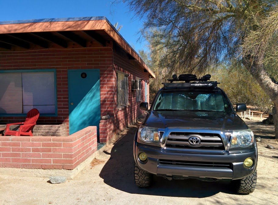

    I drove into downtown Borrego Springs, and the owner of Hacienda Del Sol took pity on me and put in a suite right away. I took a hot shower and settled in and slept for 6 straight hours.
