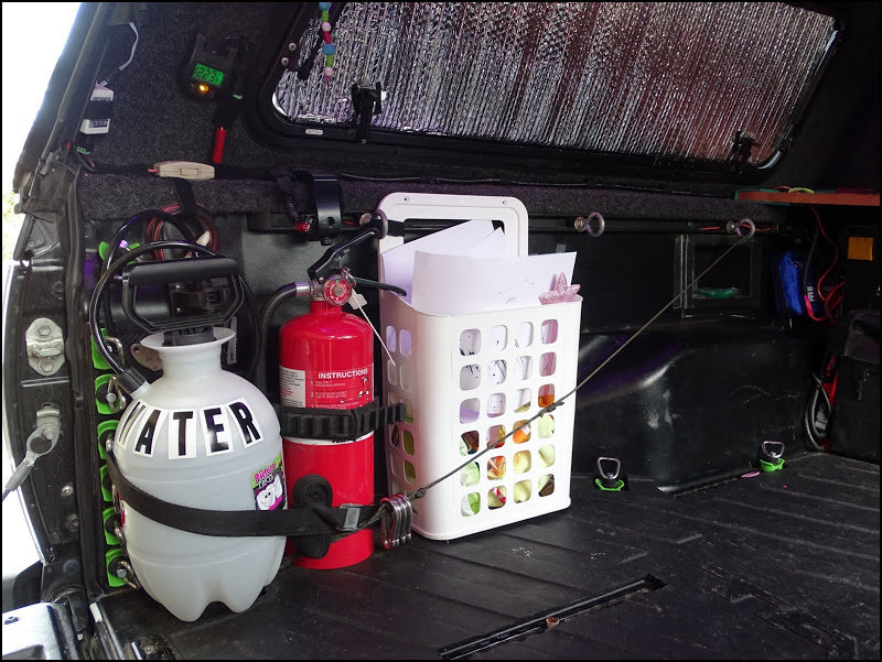

    Sometimes a little organization goes a long way.
    Today I found this white plastic bin in my garage and tried it in the truck bed and it fit right in. I'm going to see if I like it there for daily driver duties. It sits flush with the wheel well and can serve as a catch all for loose crap that I throw in the back of the truck and don't want rolling around. My 3-year old helper liked it and promptly filled it right up. It's secured with a bit of Velcro at the top and the paracord which has been there for truck eons.
    I also put back my spare tire, reinstalled fridge, fire extinguisher and water sprayer.
    Finally getting back to normal.

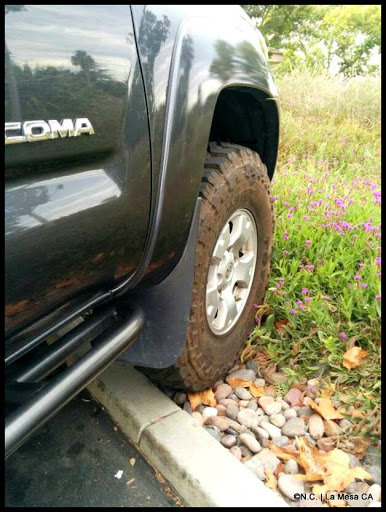

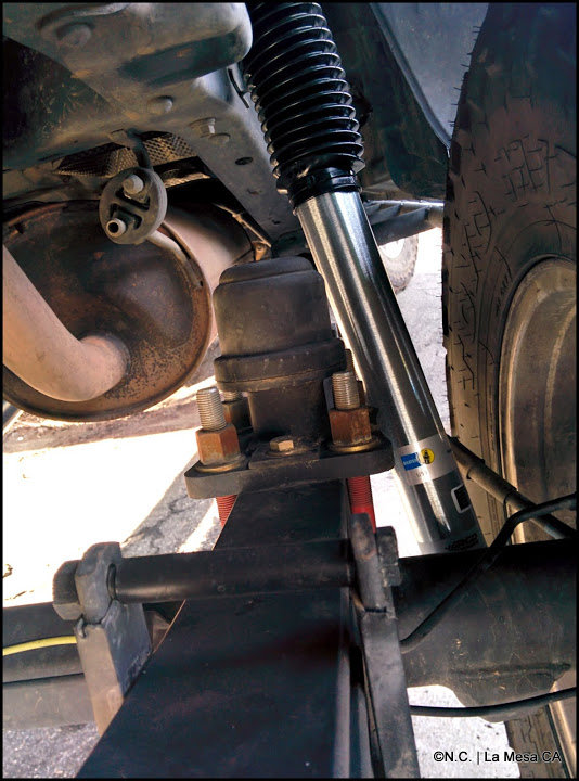

    Yesterday I took the truck to the speed bump proving grounds. It's a 1.5 mile track of speed bumps. The bumps are the wide variety. I can take them at a max speed of 15 MPH and still keep the front tires on the ground. Any faster and the front shock will top out.
    The good news is the extended length 5100 B110 work extremely well. They kept the tires on the ground every single time and out performed the front by a long shot. Big improvement over the OME.
    :thumbsup:

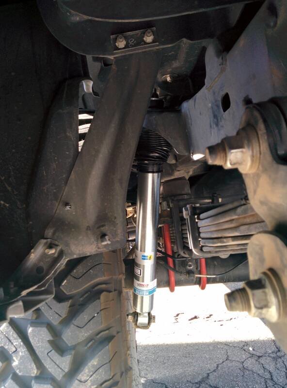

    Sounds good.

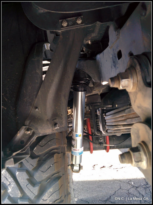

    Out of curiosity, is the shock bottomed out in this pic?

    You can find a speed bump proving grounds in your area at the following general locations:
    • Military / Government installations
    • Large State agency complexes
    • Large business complexes
    I usually bail after the second lap, so I don't attract unwanted attention. :anonymous: And only do it when not busy, evenings, holidays, etc.
    Thanks Willis! I think you will be fine with 2" extra length and your Dakar leaf pack. You have a nice 2014 build, I traced your build back in September. I still want to add some lights to the shell door like you did.
    I used to take the truck to the Mall every weekend like clockwork because of my kids. I loved seeing other expo rigs there. lol I'd always try to look at their paint to see if they really wheel the truck.
    And whenever possible, park like this. :cool::rolleyes::D
    No. But it's close. I think I will add a spacer. here is a closer view.
    Yellow line yields .41" of downtravel left. Red line is shock destruction. :bananadead:

    HOCKEY PUCK - or slice one in half at least. :)
