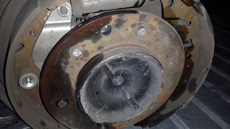

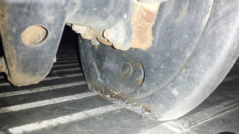

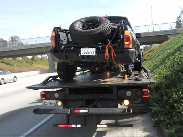

    Let me add this:
    Keep those rims as long as you can
    1. They are easy to find if you need a new one
    2. They are OEM quality
    3. They have a decent bead retention
    4. They were designed for the suspension
    5. And the best reason, IIRC, they have the mag lug seat type lug nuts that are more appropriate for a hub centric wheel - the conical seat lug nuts are, to my knowledge (and I could be full of crap), the conical style are more appropriate for lug centric wheels.
    My most recent experience related to this is my wheel busting off my axle on the 57 fwy at 65 MPH...
    I know a number of peeps that have had this rite of passage happen to them but, to my knowledge, none with the Off Road mag lug seat type of lug nut/wheel.
    Crom[OP] and DoorDing like this.

    Sheared may be a bit strong a word. I'd say it was more an issue of fatigue. Remember by nature there's a stress riser right there. I have put the suspension through it's paces - a very rare but occasional 4 wheel sailing as well. I am sure they progressed over time.
    My current wheels are aftermarket wheels that have been made into beadlocks by OMF. I am going to check how close the hub opening is on this wheel compared to the OEM rims. I am seriously considering going back to my TRD fake beadlocks. Plus I'll get my sonic air down method back. :)
    This happened two nights ago. A little bump and then a thump and I was throwing sparks. Not too much differnt than running on a flat - just lower.
    Yes Toyota original studs (~100k miles). IIRC I thought Tom lost a wheel under this scenario as well. I've already ordered new ARP studs (Lexus app). I think I will do the rear bearings and reseal the ARB while I'm at it.
    The ARP studs should be fine for another 90,000 :)
    Crom[QUOTED][OP] likes this.

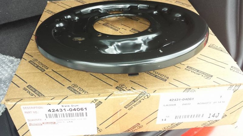

    And to ensure my arm is properly calibrated, I picked up a HF click type torque wrench to keep in the truck. With coupon $11 :)

    I like these studs...

    Been there done that..that was us on the 210 heading for a run.
    Just about 600 bucks to get it back on the road. I didn't have ABS for over 2 years because a machine shop failed to properly press on the wheel bearing, total pain in the ass..
    Crom[OP] likes this.
