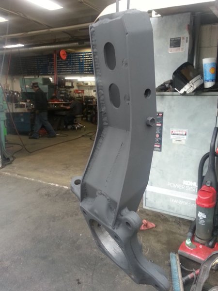

    Also another gusset to look at....

    Wow! That was Matt's from 2013? Hadn't seen that before. Impressive.
    That's serious beef, maybe a second to your allmighty Maxtrac spindles. :D

    SD Truck shop did those.... Seen a couple sets on the LT trucks and never tweaked as far as I know....

    I have bent gusseted spindles. I think I will have MUCH BIGGER PROBLEMS if this style ever bends. I can explain the strength over a fire. :)
