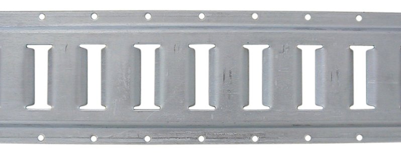

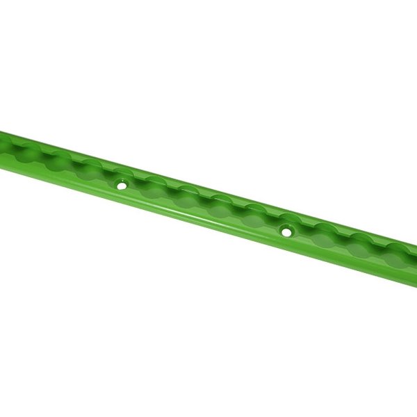

    @Crom is there a reason you went with L-tracks instead of E-tracks? E-Track.jpg L-Track.jpg

    Short answer: Yes. In short, I want to secure cargo to the floor and not to the sides of the bed.
    Long answer: In another career, and what seems like a lifetime ago, I used the E-track stuff in commercial cargo applications. It works. But I always used it for securing cargo to a wall or finishing off loaded tiers.
    The main issue I have with that, is that securing cargo to a wall, does not stop cargo from moving up and down, and more or less relies on gravity to hold it down.
    What I wanted for the Tacoma after my Death Valley 2014 adventure, was to secure stuff directly to the floor. And that's when I set out on my "no more shit rolling around the bed" project ® @rngr :D
    I had used little bits of l-track before to secure my fridge and what I liked best about it, is that is fits between the ribbed section of the bed. However, it does protrude up above the raised section of the bed. But this issues is completely solved by laying down a Tacoma bed mat and cutting holes for the track. So the track is recessed and out of the way. The Tacoma bed mat is extremely valuable because it's soft, durable, and helps stuff stop slipping around itself. I think it's made from vulcanized rubber like a tire.
    It's a great combination.

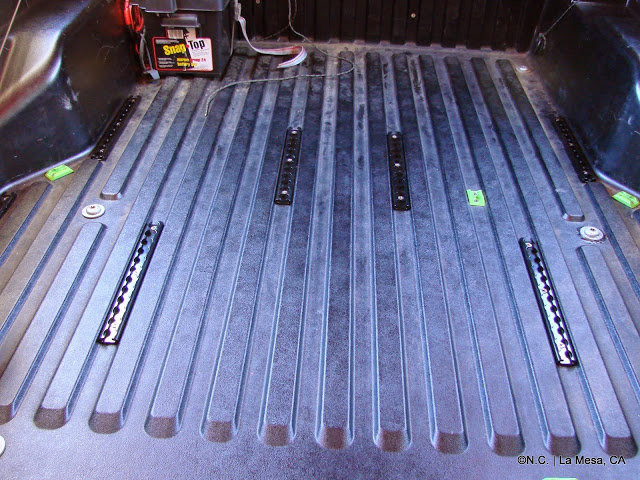

    A picture from the first round of l-track install, no bed mat on top.
    Bed mat installed and hole cut.
    l-track is recessed, and out of the way.
    Cargo fitting installed.
    @GHOST SHIP Sergio, you once asked in my thread how these things age over time, or if they wear out, make noise, etc. I didn't properly answer your question when I quoted your post, and been meaning to follow up. So here is what I can tell you about these things. They seem to work fine in the last year, my only gripe with them is that black rubberized boot, (after about a year), they started to leave a back residue when touched by hand. I don't know what kind of synthetic fabric its made from, but I don't like it. I have used a scissors to cut the boot, so I don't have to touch it with my hand and get the black shit on me. :D
    Other than that they are bomber tough.
    How it is today.
