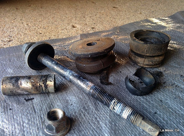

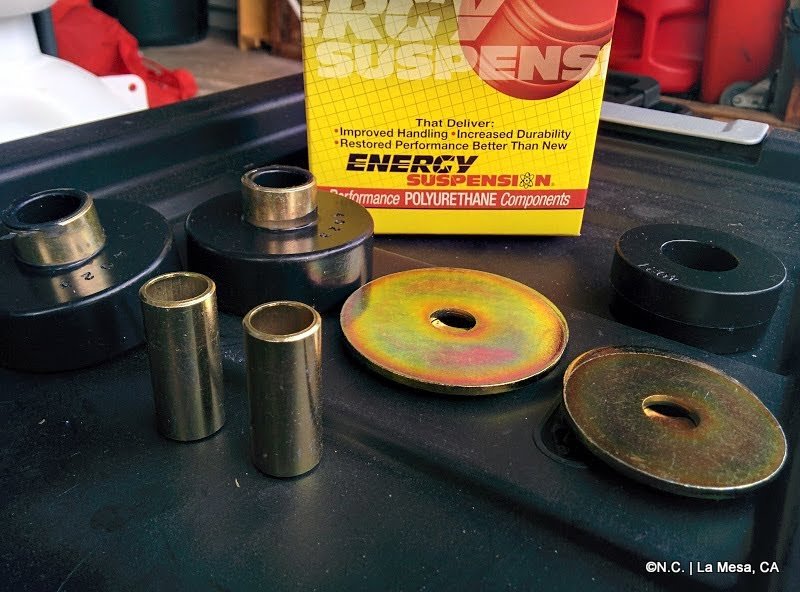

    As it turns out, the Death Valley trip loosened the passenger core support / radiator bushing bolt. I also missed these bolts prior to my departure, so they never got retorqued or the paint pen treatment. Fawk!
    Symptoms were dull thuds and pops while chassis flexing while turning in and out of sloped driveways, some speed bumps, etc.
    I tightened it good and tight and my truck drives like a million bucks again!
    These are the radiator support bushings I put in last August. I love these things so much, that if I could only recommend one mod for under $30, this would be it.
    These are the tore up factory ones that came out.

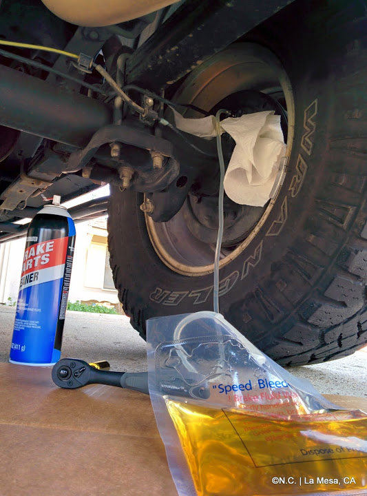

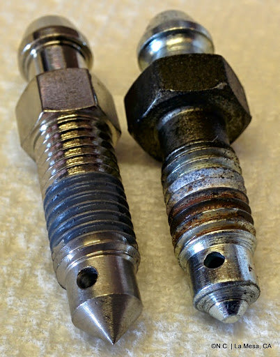

    So after seeing this post I decided to order some speed bleeders but the pictures are misleading. I ordered the brass ones and they only come one to a box not 2 per package like shown lol

    I've ran the ES universal bushings both ways. My advice is to run it with the bigger bushing on top, with the bigger washer on top.
    I skipped the big washer on my install, and nothing bad has happened to my truck and I've really pushed the truck off road. Because of the debate/discussion about the universal bushings I talked to ES support over the phone and I asked them why the washer on top, they said something to the effect that it was there to protect the urethane. When I pressed them further for details, the rep didn't really have any more answers.
    I always encourage everyone to do their own research, I can tell you that I have spoke to Energy Suspension and Prothane tech support about body bushings, and both DO NOT recommend applying lube to the bushings where they touch the washer. However, you can grease the internal metal sleeves if you desire.
    Now let's take a bit of time to look at why my bolt self loosened. Years ago I absorbed a bit of knowledge from a site called boltscience.com They've published a fantastic article on why threaded fasteners self loosen. I highly recommend it.
    Here is a relevant quote:
    This is exactly the type of joint where the objects being clamped together, will vibrate and try to move parallel to the bolt / nut face.
    Anyways, the bushings are a huge upgrade over stock.

    :( I'd give them a phone call and see what's up. Those pics were from the packs I got when I did mine, so maybe they changed something. :notsure:

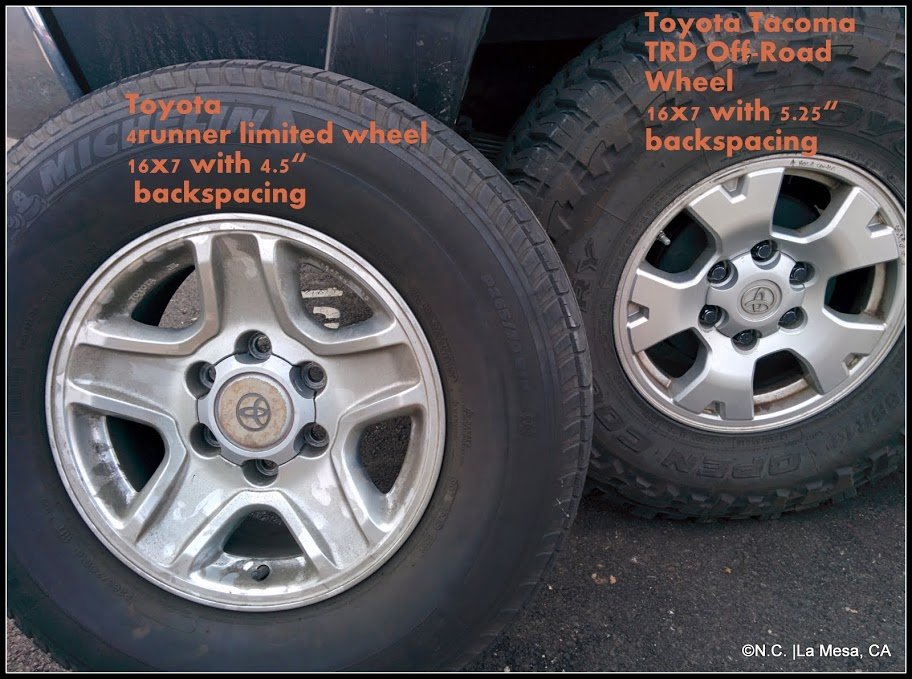

    I'm half that distance away from them and have stock wheels available. Are you trying to test fit the stock wheel or the 4R wheel you just got?

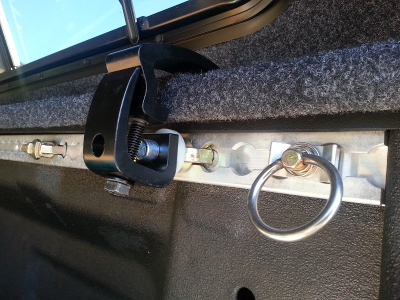

    It will probably will never happen for me, but if you can manage the time (lol :D ) , do what ModoDave did on his Tundra: MotoDave on ExPo, in his Tundra - Bed Rail Alternative thread.

    Thanks. It's the 4runner wheels.

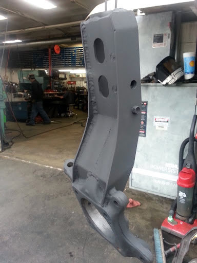

    In other news.... I talked to James at the SD Truck Shop and got a quote ($250) for the mighty SD Truck shop spindle reinforcement. Surprisingly, if I brought the spindles in, my cost isn't that much more compared to the TC + welding cost.
    They might be overkill for my rig... But sometimes, that's not a bad thing.
