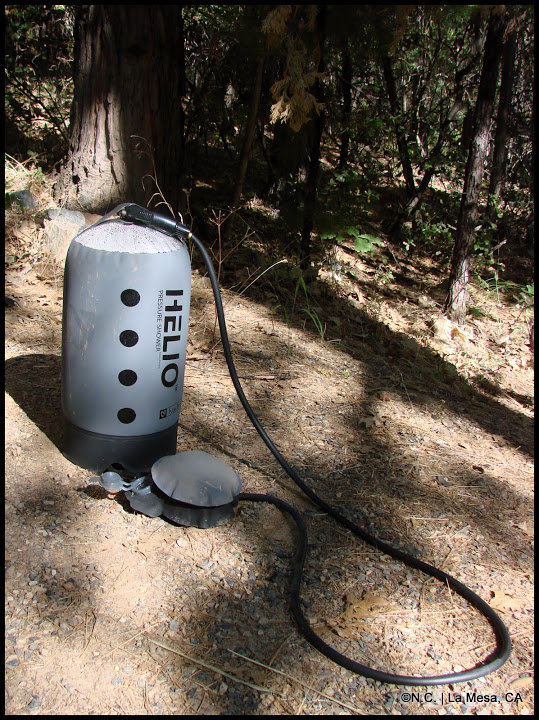

    Helio pressure shower
    • 3-gallons,
    • heat with sun,
    • or heat with stove water,
    • collapses down small,
    • portable,
    • has a foot pump to pressurize!
    • Pouring in stove water, you need a funnel, is slow and cumbersome,
    • If solar heating you must shower not too long after sunset.

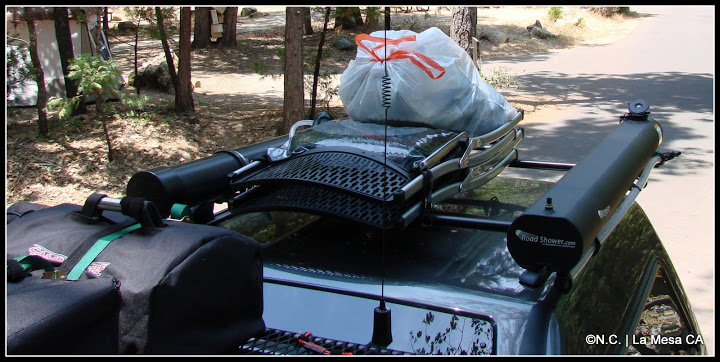

    Road Shower
    • I think it's 4-gallons,
    • aluminum tube,
    • truck mounted,
    • not portable,
    • heated by sun,
    • All the caveats of a solar shower.
    • extremely convenient for cleaning gear, and kids.
    • About 35lbs when full.
    • Makes your rig look a little bit like Ghostbusters. lol

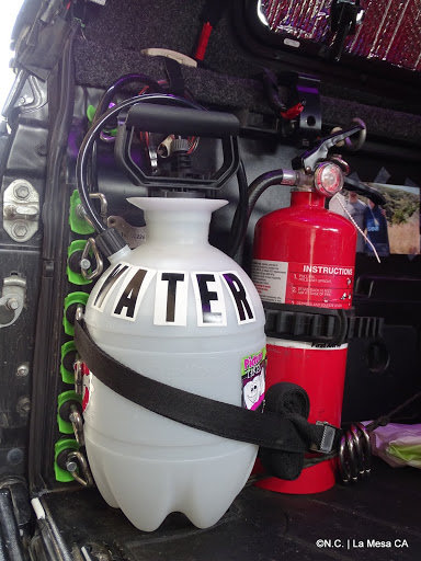

    Lawn and Garden sprayer (1-gal)
    • 1-Gallon,
    • Pressurized,
    • Low flow,
    • not usually heated,
    • vehicle mounted,
    • and portable,

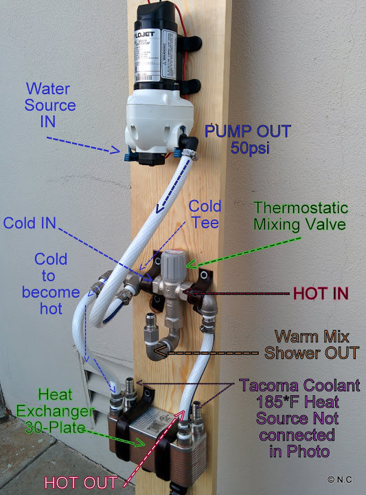

    Vehicle mounted Heat Exchanger
    • Complicated
    • Must run truck to get heat.
    • Main components are: plate heat exchanger to take heat from 185°F vehicle coolant system.
    • Thermotstatic mixing valve (so you don't scald yourself),
    • Mixing manifold,
    • 12v pump,
    • Shower hose with quick detach fitting.

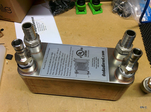

    Built heat exchanger

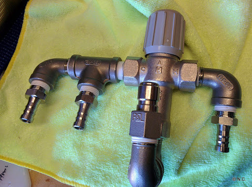

    Built manifold
    Mounting bracket for mainfold
    Mounted in engine bay
    dd912641e8e71609bd75c01e5b0edf9e%25255B1_229d86f62978ec03ed86b8a038152bc3aeb0a855.jpg

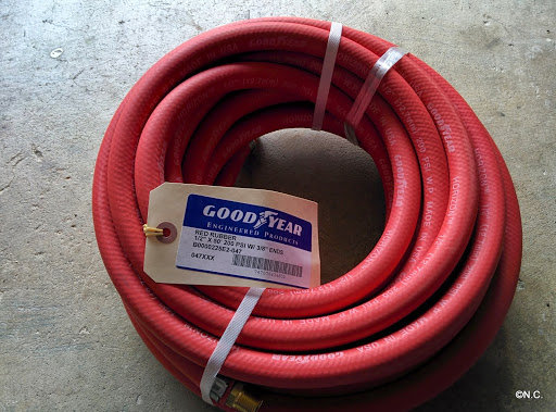

    Rubber hose to plumb everything.
    Here is the system all diagrammed out, and mounted to the test board.
    Sadly, I never finished the heat exchanger project. I may finish it one day, but I've suspended it indefinitely, pending 10,000 other projects. :p

    Heat Exchanger in the engine bay??? Where did you come up with this idea? Dang... great idea!

    DFW
    She gone
    There is another member on here that has it finished and works. @Spencer

    Not my original idea. I faithfully reproduced @tweeek 's design, he finished his in October 2013. He was very helpful in the forum and I'm grateful for it. His original thread can be found here.
    Yeah Spencer did an awesome job. I think he finished his in Jan 2015 over in the On Board Water thread, which is now locked... o_O

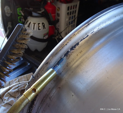

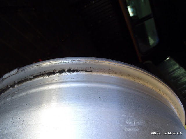

    I've cleaned one aluminum wheel once in my life prior to these 4runner wheels and it sucked ass.
    I wish I knew what it was... i think it's the tire bead sealant that shops use when they mount tires. I think when it dries it's like a glue.
    It resisted all forms of automotive chemicals I tried on it.
    The only thing I found that worked was a propane torch and a brass brush.
    Neither one worked without the other.
    Wheel is looking like new again! Takes about 30 minutes per wheel and they look amazing. Old on the left, and cleaned on the right.
