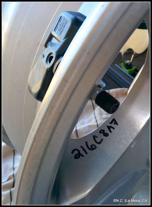

    if the tire shop cant program the new tpms sensors in for you, I can do it for you with the toyota techstream software

    Much appreciated! Thanks for offering. :)

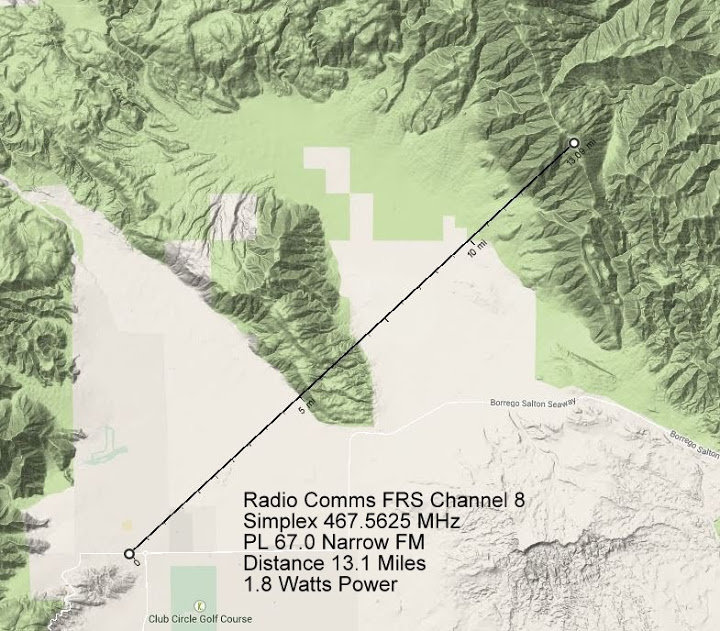

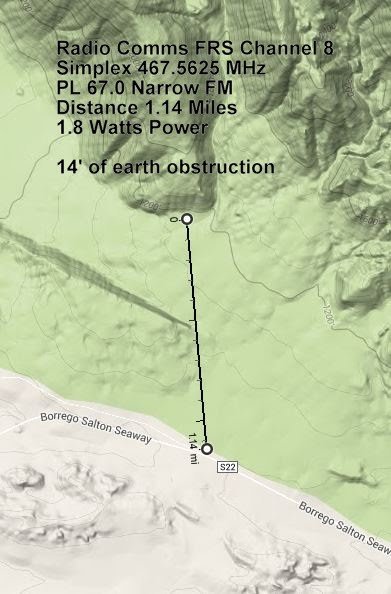

    Handheld Radio Comms
    Our family makes use of radios whenever we separate for any reason while on trips. It's very convenient.

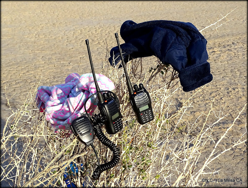

    Pictured below are two handheld radios that I use on the VHF/UHF ham bands.
    They are Chinese made, by a company called Baofeng.
    Baofeng model UV-B5. Spectrum Analyzer results.
    I have a hard time recommending anything by this company since quality is not a priority, but they're not junk either. It's hit or miss it seems.
    For $27 each at the time of purchase, I wasn't expecting too much. Since owning them over two years they have been really good. Only once did one malfunction, in which case power cycling fixed it.
    • Dual VHF UHF UV B5
    • Freq range:136-174 & 400-470MHz
    • 99 memory channels
    • Li-ion battery pack with 1800mAh high capacity
    • FM radio function
    There is a little bit of a learning curve with them, but not too bad. I programmed mine with a USB cable and a free program called Chirp.
    In theory it would be possible to do something like this:
    In theory this might be possible as well.
    Some accessories that have augmented their usefulness
    1. Tram 1185 Amateur Dual-Band Magnet Antenna
    2. SMA Female to UHF SO-239 Female Connectors
    3. Battery eliminator (for plugging into 12v outlet)
    4. Speaker Mic.
    5. FTDI Authentic Genuine USB Programming Cable

    FRS radios use narrow-band frequency modulation (NBFM) with a maximum deviation of 2.5 kilohertz

    Good to hear. VHF radios are great. Good clear audio. In a nutshell the Baofengs don't conform to the FCC's rules for the radio services I listed above, mainly the detachable antenna and extra power. However, they are A-OKAY for HAM use.
    For persons who don't have an FCC license, the MURS frequencies are probably the best to use. When I'm out in the wilderness, I scan stored memory channels for FRS, GMRS, MURS, and 2-Meter simplex (VHF HAM). I always find people, and sometimes it's fun to talk to them. On my last DV trip, I found a small group near Lippincott mine. I was 10 miles away and spoke to them to find out some basic trail intel.
    In the past, lot of public safety agencies operated analog VHF radios. In my urban area, almost all are digital now. In rural areas, there are probably lots of fire / public safety agencies still VHF analog. For example, BLM, National Forest Service, CA State Parks, and CalFIRE are still analog VHF. You can listen in to their transmissions with the Baofeng, perfectly okay to monitor, but don't transmit on them! :) And that's where one has to be careful with these radios.
