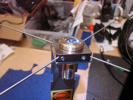

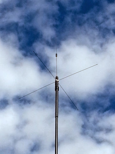

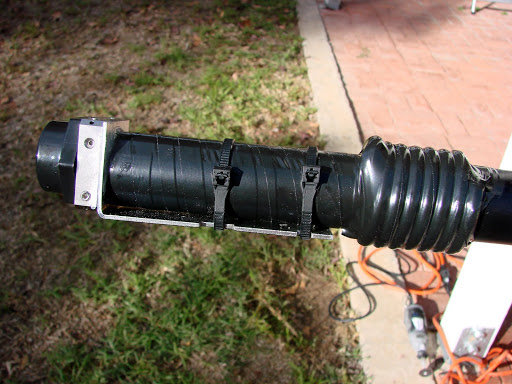

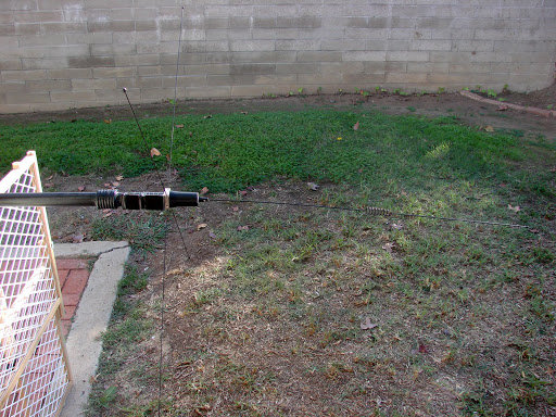

    At my home I setup an antenna (same one on my truck), mounted to a 20' pole, ran some coax (feed-line), and a bulkhead pass thru in the wall to get into the house. The pole was free, everything else ran me about $150.
    I hooked the coax up to my cheap ass Baofeng Radio. I can hit linked repeaters 39 miles away. I can talk to guys driving around in Phoenix from my couch, lol.
    My wife can also use the radio to talk to me at work. I'm only 3 miles from home. Works pretty well, but there is one caveat to doing this way though.
    Handheld radio receivers are easily overwhelmed in heavy RF corridors, such as urban environments. The tech term is "desentized" or "desense" In a nutshell, the radio receiver can't effectively distinguish between the signal it should be tuned to, and a strong signal it should ignore.
    Mobile Radios have a lot more filtering installed in the circuitry, and thus will perform much, much better across the board and generally not subject to that problem.
    My recommendation for mobile radio choose is the big 3. Yaesu, Kenwood, ICOM. Those suppliers make quality goods. The Chinese vendors are copying the big 3, and they have radios on the market for about half the cost. However, quality is substandard, and the menuing systems can be a torturous hell.
    Here are a few pics of my home antenna
    NMO Mobile antenna base station adapter kit. (Ground plane radial)
    PVC pipe attached to aluminm pole, RF choke, and base station kit attached.
    Radials attached and antenna mounted.
    Here it is in the air
    I had it up for a long time, but it's down now. I can put it up in an hour if I need to though. :)

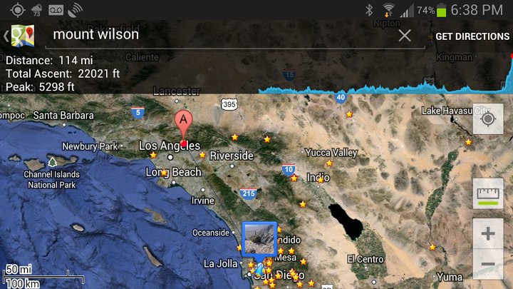

    On a really good day, I can park the truck in a few good spots and hit a UHF repeater on Mount Wilson and talk into Los Angles. Power level was either 10W or 50W... Pretty amazing if you ask me.

    Nice home setup Nick. That is awesome that you can talk to your wife at home from your truck.
