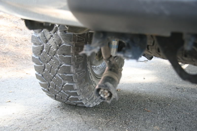

    I scraped my OEM hitch many times and FUBAR's my trailer plug when I had the trailer out! :eek: Duct taped a few wires and the plugs together when it was time to hook up the trailer and go home.

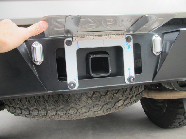

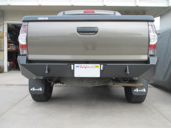

    The All Pro aluminum rear bumper has an optional receiver hitch which weighs as much as the bumper. Bumper is 30 lbs, receiver hitch is 32 lbs. It is hidden behind the license plate so as to not reduce clearance. So if you want to forgo towing (like I do) the All Pro is quite light weight (but add 7 lbs if you want the extra panels for the side - it would appear from Crom's last trip that he may want those).
    Near as I can tell the OEM tow package receiver hitch and chrome bumper combined are about 80 pounds together. The chrome bumper by itself seems to be estimated by folks on TW and places shipping parts to come in around 20 lbs. Aftermarket class III hitches for the Tacoma are around 45-50 lbs and the OEM one is a class IV so probably a few pounds more than that.
    So I'm estimating by going with an aluminum rear without any receiver hitch will actually knock about 40 lbs off of my curb weight.
    The aluminum skids (IFS, mid, trans, LCA, fuel) added up to 100 lbs and I'm guessing the stock stuff removed was maybe 15 to 20 lbs (need to weigh that stuff).
    So I'm estimating full aluminum skids and aluminum rear bumper with no receiver is net only about 40 lbs total over stock. Steel is a whole different story!

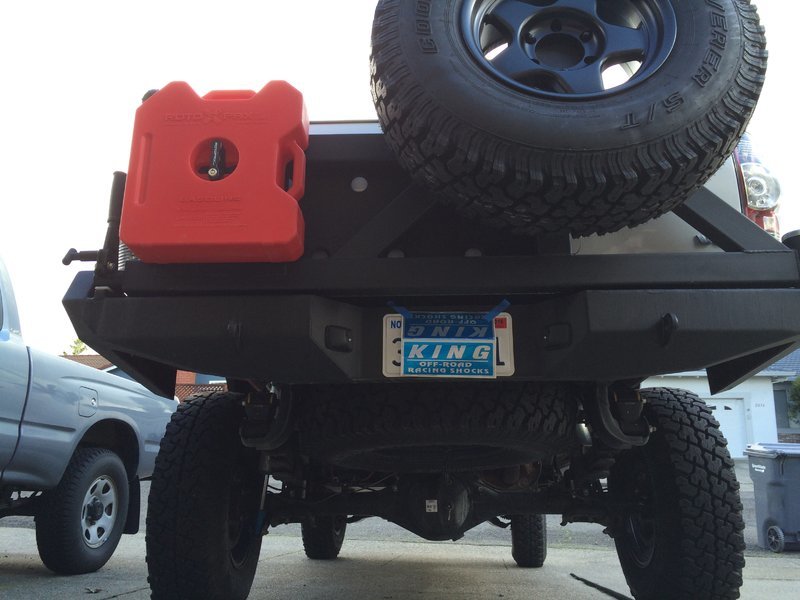

    fully zip tied
    steel high clearance with swing-gate. 33inch spare is shoe horned in. 4 aluminum skids and front bumper. glad i went all aluminum, and glad the rear bumper is steel.

    One thing to note though with the AP hitch in you can only fit the stock spare underneath. It looks to me that even a 32" wouldn't fit. You can see how much clearance is gained by how much of the spare is showing. The biggest improvement in clearance is gained with the HC rear bumper - not counting lift of course. I've only just brushed it a couple of times where I was scraping big time before. In fact the pics below is where I blew out the trailer plug.

    That's a good one!!! 7-pin connector destruction! :D New bumper looks great!

    Looks real good. You carry two spares?
    Thanks. That's a very important note to consider for me. I've got a 33" spare tucked under there, and it's tight. Anything aftermarket would have to be compatible with that size spare under there. I'm not willing to relocate the spare.

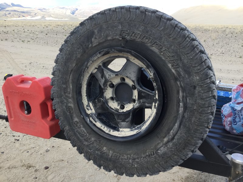

    So your tent got hammered too! Excellent! :) That's one trail repair I'm not set up to do. Rip sidewall = swap to spare time, at least for me.
    Glad you got it covered.

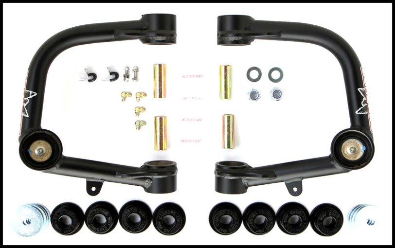

    I finally had enough of the tires rubbing the plastic fender liner crap. Sunday was the last straw. It was wheeling on the hard trail. The suspension got a serious workout, and the tires rubbed the plastic fender liners in places where they haven't before and I am really tired of that. This is probably because the new 4Runner wheels moved the tire out 3/4" and I was carrying weight, so suspension compressed a lot more.
    I ordered me up some Camburg ball joint UCA's to fix my alignment.
    This is exactly what I wanted in a UCA design. Ball joint, with greasable poly arm bushings.
    Now the hard part is finding time to install...

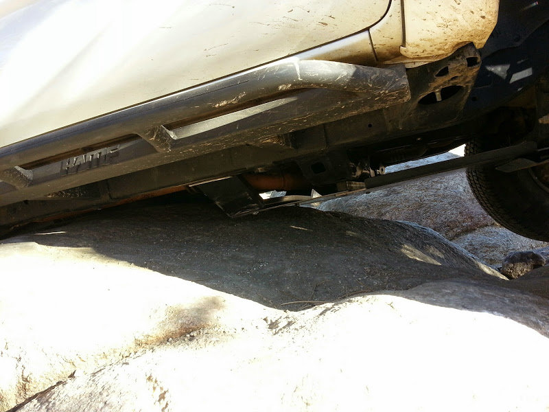

    I would never consider aluminum for any of my armor but that's because I intend to, and have, used it.
    In fact, I pretty much murdered that crossmember for the tcase skid. I got a beefed up revision of it now from RCI.

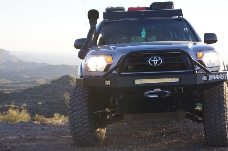

    I've put the front corner of my Pelfreybuilt bumper hard into the rocks at Moab. In fact, we used the winch on a couple of other trucks to pull it back out as it bent in an inch or two.

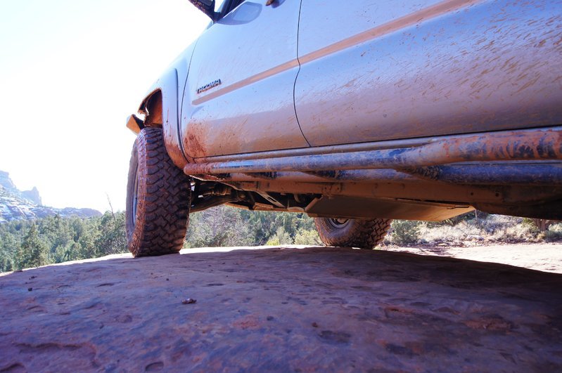

    I've put the high clearance BruteForce Fab bumper through some abuse as well.
    Everything I've put the truck through and the zero body damage I have to show for it makes it all well worth it to me.
    I realize not everyone will use their trucks the same way but if you go for aluminum, just know it's limitations. If those limitations fall within your intentions, then go for it. If not... you might consider steel.

    Unless you were rubbing in the front of the wheel well, the UCAs are going to increase your rubbing issues rather than decrease them.
    Caster added at the LCAs moves the wheel forward in the wheel well. Caster added with UCAs moves the wheel back.
    I'm not saying "don't get the UCAs" but I am saying "don't expect them to stop the rubbing issues." Gotta get out the dremel for that
