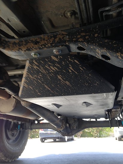

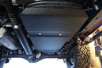

    Good. The topic has turned to skids. I can jump in now.
    I've already decided on aluminum skids. Mainly to keep the weight down and that I don't do crazy ass rock busting stuff.
    I got into the RCI GB and already received my front three (IFS, Tranny, T-Case.) Decision was mainly based on price, since all other things seemed relatively equal compared to other manufacturers.
    I'm still deciding on the fuel tank and rear diff.
    Rear diff, not likely. Fuel tank, yes.
    I think I want to go with Pelfreybilt (PB) Aluminum skids, because they are thicker than the RCI equivalent (1/4" vs 3/16") AND the design of the PB skid seems to be more "skid-like"
    Below are photos from their websites.
    Pelfreybilt: Note how the front part of skid is bolted to a frame cross-member (I think) and there is bolt head "protection" welded on (the triangle thingy's)
    RCI: Note how bolt attachment points are only on the OEM Toyota Fuel tank straps. Nothing bolted to frame.
    I am hoping Crom and his loyal, relatively sane followers can weigh-in. Bonus points if input is based on experience or ownership of skids up for discussion.
    For additional consideration, PB skid is cheaper by 40 bucks
    Crom[OP] likes this.

    I have a Pelfreybilt aluminum skid (actually 4 of them) under my gas tank. Definitely a great product.
    I have never seen the RCI in person, but I could not be happier with the PB skid.
    EDIT: Yes, the "triangle thingys" protect the nuts/studs of the gas tank straps.

    I have the Pelfreybilt aluminum gas tank skid, I would buy it again without considering other options. Disclaimer: I like aluminum, and I'm a PB fan.
    tacoma16 and Crom[OP] like this.

    Just looking at the pictures and specs I'd choose the PB one. It's only 12 lbs.
    Back in January we were discussing the 8 lbs UHMW gas tank skid, unfortunately no longer available. I really liked that option.
    My TRD OR has an inexpensive factory plastic gas tank skid that is has taken a few scrapes and is otherwise holding up well.
    Thanks. Lots of positive reports from others in the forum so I'm expecting lots of goodness from them. These will be the first non-binding poly bushing UCA I've run. Glad I got the ball joint too since I don't like vehicle noises, and I don't think I could handle squeaky uni ball.
