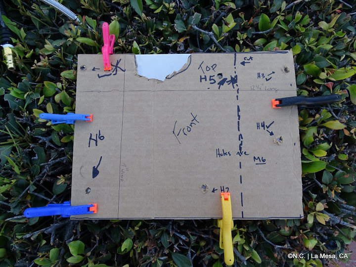

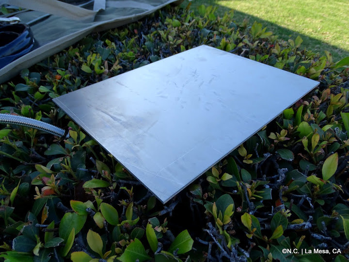

    Back in October, my daughter and I started a cardboard template for the ARB compressor to mount to. Picking this project back up, we grabbed the cardboard and finished it.
    1/8" aluminum plate.

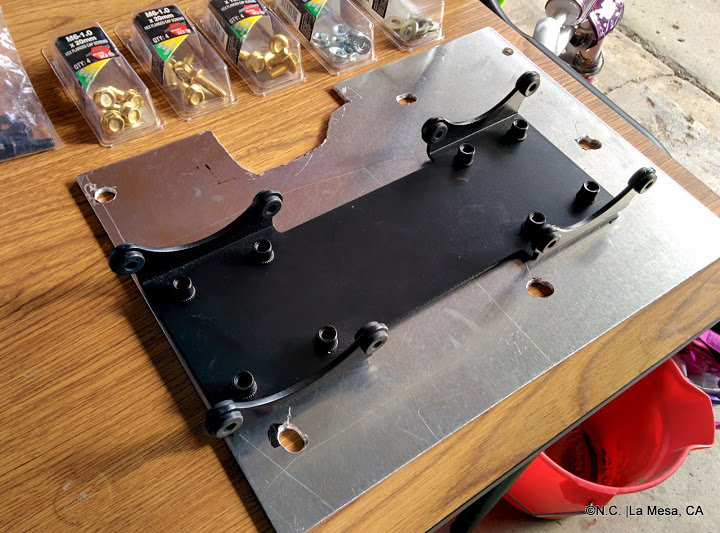

    Transferred hole pattern
    I also transferred over the hole pattern for the ARB mounting bracket.
    Test fit good.

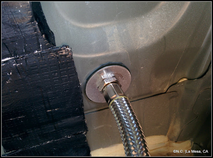

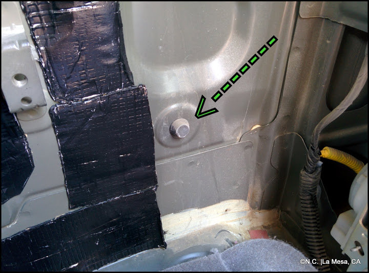

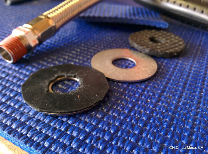

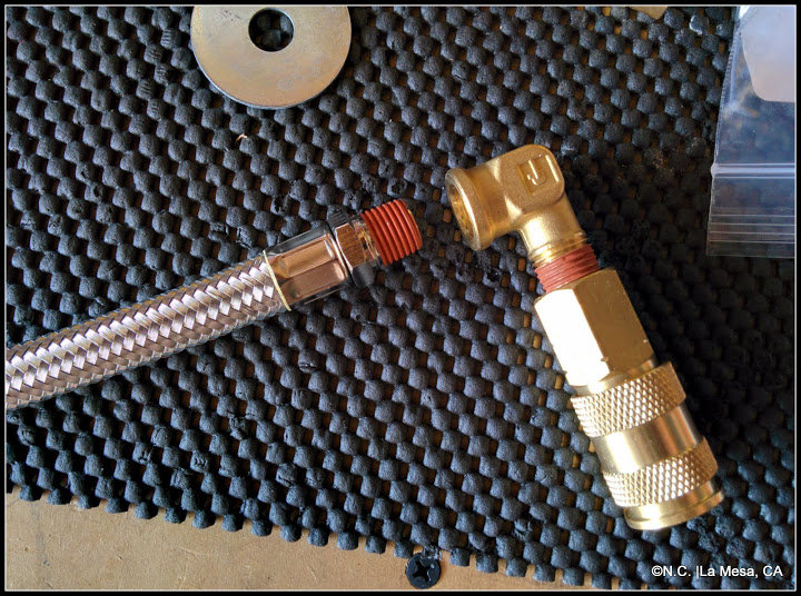

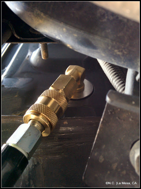

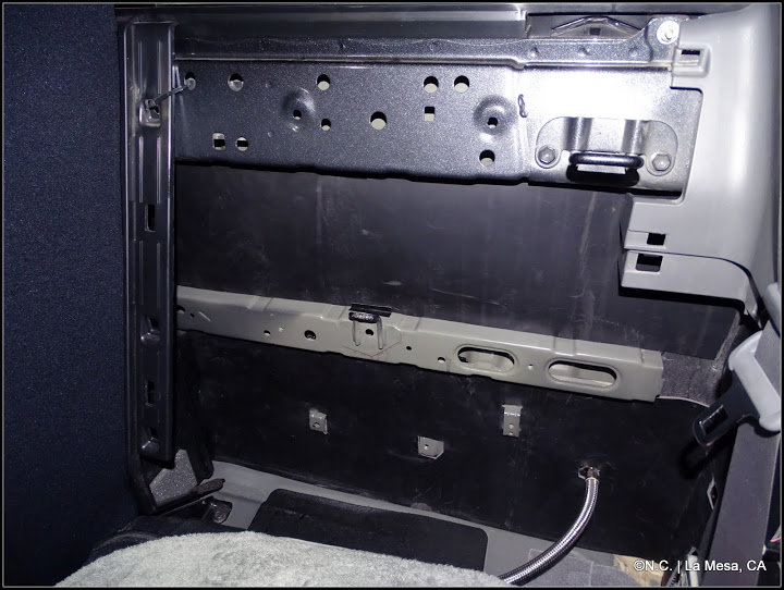

    I needed to pass the air line through the cab. I bought a couple bulkhead fittings, but in the end I decided to adapt to the holes already in the truck.
    I found a hole. Remove rubber grommet and go to work.
    I used 1/2" stainless washers with EPDM material I cut to fit for a makeshift gasket and to protect the sheet metal.
    Basic configuration I settled on, minus washers.

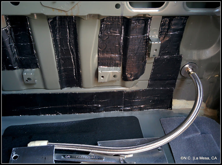

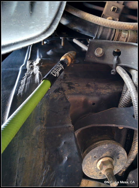

    I simply fed the 18" Viair leader hose though the hole with my washer attached.
    Here is the backside of the cab.
    The air hose will be ran along frame and come to the rear of the truck. This is just a proof-of-concept test in the picture, not final install.

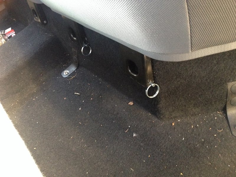

    One of the best most practical mods I've ever seen for pulling seats was @crazy joker 's seat hing pin mod. This has been on my list of mods to do for almost 1.5 years now...
    Click picture, to go to his build...
    Because of the kids car seat pain issue, and benefit of more room, I only store things back there that I think I'll only need in a dire emergency. Like this 3-gallons of water.

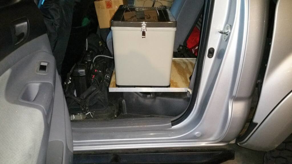

    Your pic reminded me that one day last May, I wanted to build something for cheap so I made a primitive shelf for my ARB fridge for like $10. Only used it for one trip... worked great!

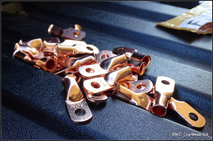

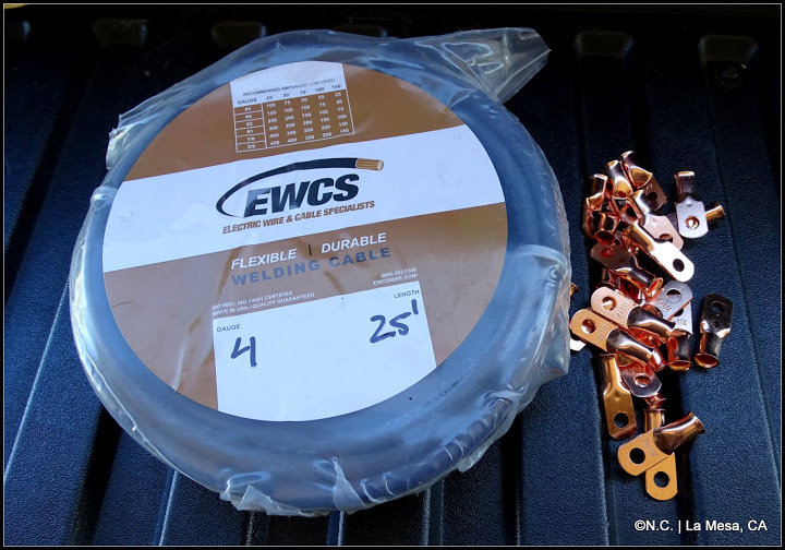

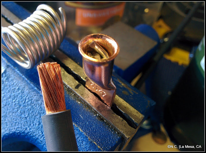

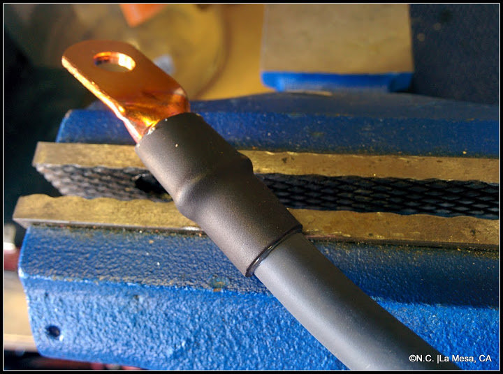

    Moved my OBA project forward a tad yesterday. Soldered and crimped one lug!
    I found some made in the U.S.A. quality 4-AWG welding cable for about $1.08 per foot. It weighed 3.71 lbs. Very happy with the quality.
    Copper #4 x 1/4" ring terminals / lugs.
    This is a cheap effective way to solder the lugs. What I do is cut up some solder and put in the lug, and put the lug in the bench vice. Heat the lug for about 10 seconds with propane torch, to melt solder. Insert stripped wire. Once cooled, I crimp the end of the lug with a punch. Lug then gets a 15-20 lb. pull test to make sure it's secure. Never had one fail this way.
    Finally, a 1" bit of marine grade heat shrink makes it all waterproof. I have red and black heat shrink and use the colors to identify polarity.

    :thumbsup: Good trick on the soldering of the battery cables. Another one I use when soldering in tight spaces where you can't have things on the workbench is to wrap the wire or joint with a small piece of solder. As you heat the wire it will flow into place and you don't have to be an octopus to finish your project.

    I was wondering why you were using such large wire then I looked up the stats on the ARB Twin Compressor and it draws 56 amps at maximum airflow. What a pig!!

    The plumber part of me wants you to heat the wire too before putting it in the end so the solder will properly bond to the wire and not just solidify around it.
    Probably not critical though
