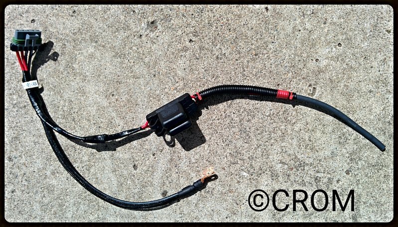

    Nice unit. It's been five months here. I initially built mine into a portable to delay OBA.
    ARB Twin Air Compressor portable, and here.
    What forced my hand to hard mount oba was lugging the 20 pound compressor in and out of the truck so many times, plus the space it consumed in the back. Got old.
