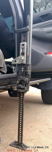

    My Hi-Lift gets used a lot. I use it in regular vehicle maintenance on the truck. One day I'll have a suitable floor jack, but post lift, it hasn't happened yet.

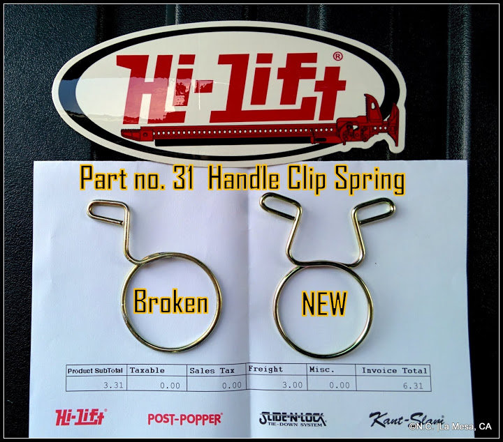

    Anyways, I broke the spring on my Hi-Lift and ordered a new one from Hi-Lift. I was lucky and they sent me two for the price of one! lol What a come up! :D

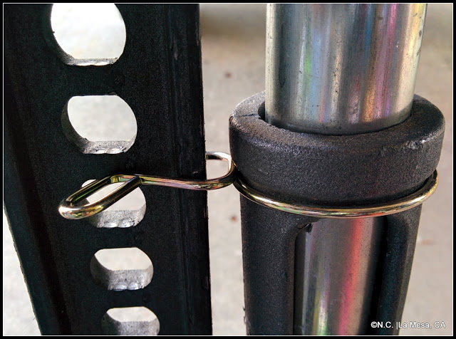

    Here it is, installed on the jack. Yay.
    It's hard to get excited about a stupid spring, but the spring is actually an important part for safe practice of hi-lift operation.

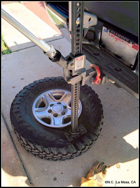

    Pictured below is the incorrect method for the jack handle, but since it was low pressure operation, safety concern was decreased.
    You can see the bit of velcro I was using when the spring broke. And in the picture, I'm not even using it.
    This is the right way. Jack handle is secured to beam by spring clip, when not jacking, and jack is in lifting position.
