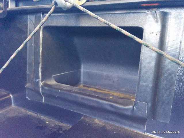

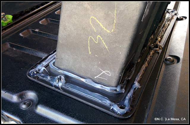

    I have 2 tiny holes (water drain holes I'm guessing) towards the cab. Did you plug these? Was looking for a method. Might just silicone a penny or something

    Yes they are drain holes. There are actually three, there is one in the middle too. I used medium strength duck tape over them. Still holding great.

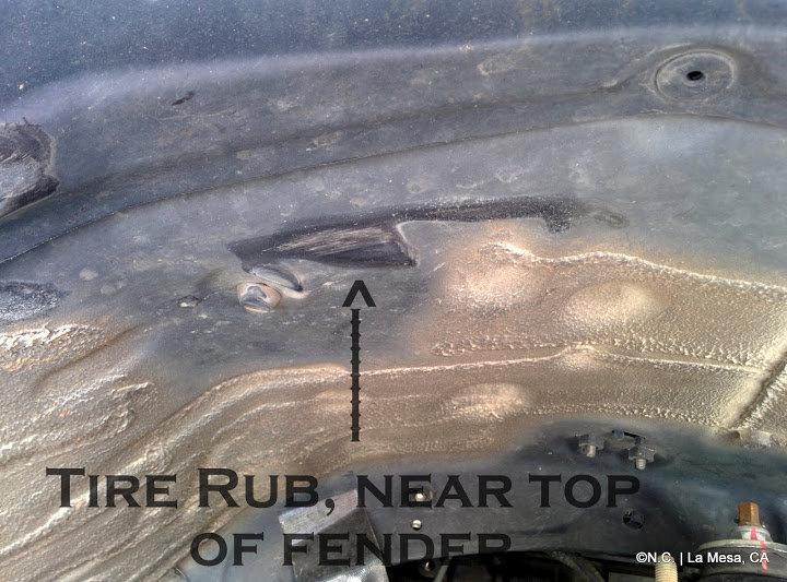

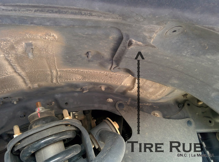

    After performing a post-trip inspection on my rig, none of my bolts or alignment cam tabs moved. All good.
    One thing is clear though. I am going to have to beat the pinch weld flat. :(
    I started this thread: "Beating your pinch weld flat with a sledge hammer. --Let's discuss!" and got some really good feedback. I am not sure when I am going to do it, but it will be the next thing I do as well as adding a shim the front bumps.
    My tires rub the pinch weld pretty bad under compression (no pic) and even the tops of the wheel well! :eek:
    The 255/85/R16 Toyos by my account, have been as much work to fit as the 285 version of 33" tires, with the exception of the cab mount. That has stayed out of the way.
