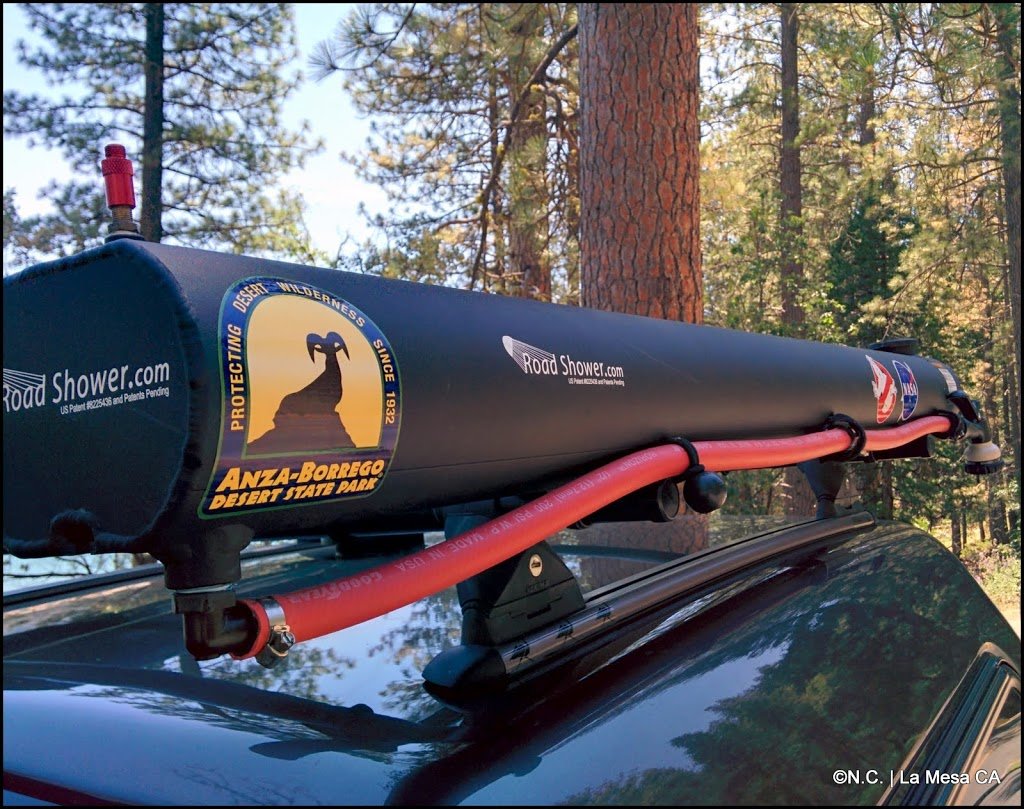

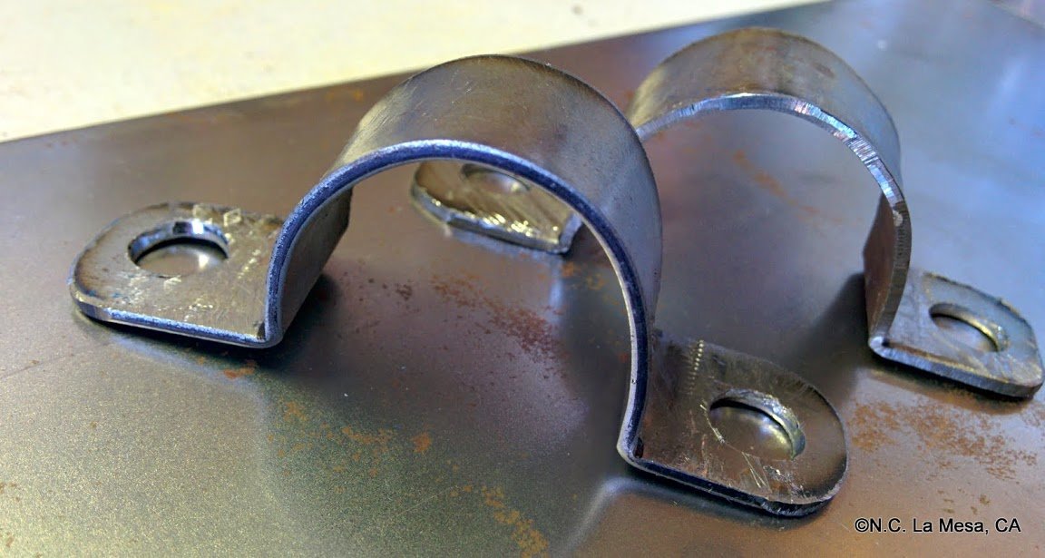

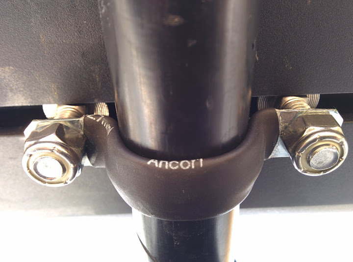

    In May 2013, I bought a road shower from Joel Cotton. It was one of the first aluminum models available and I got it at reduced cost because I was an early adopter. It was probably the easiest way to add on-board water to the truck. It gets plenty hot in the sun and works great during warm weather. Obviously if it's not sunny it will not be warm. It has a schrader valve for pressurization and utilizes a standard radiator cap for filling. It also has a pressure release vent if too much pressure is added.
    In practice I use the schrader valve with a tire deflator to admit air into the system and it works just great as a gravity shower. Many times, the system will build up pressure by heat expanding the air in the tube, so often I don't need to use the schrader valve for short bursts of water like washing feet, etc.
    I bolt on the shower before trips and usually keep it mounted during June, July since we do so much outdoor activities during those months.
    Out of the box it works great but for my needs I needed to modify a few things.
    1. I ditched the vinyl hose it shipped with after (2) years and went with some Goodyear rubber hose instead and size 4 worm clamps to hold it on. Great upgrade IMO, much more flexible, and will not let algae build up in clear hose.
    2. The Yakima Snap Round mounting system was not suitable for off road use, so I had to change out those for some custom made clamps that I made from 16 gauge sheet metal.
    The underside of the extruded aluminum tube has "t-track" that runs the entire length, which are made to fit 5/16" carriage bolts. I bought some stainless 1" long 5/16" bolts and nylock nuts and they work really well. It looks really clean too.
    Before I made my custom clamps, I tried using 3/4" EMT clamps, but that turned out to be a mistake. They are too thin of metal and could not get enough clamping force and were only suitable for on-road use.
    Pics of the EMT clamp with heat shrink tubing that I tried. (I don't recommend these clamps!)
    My Custom made clamps from zinc plated 16-guage sheet metal. Much stronger clamping force.

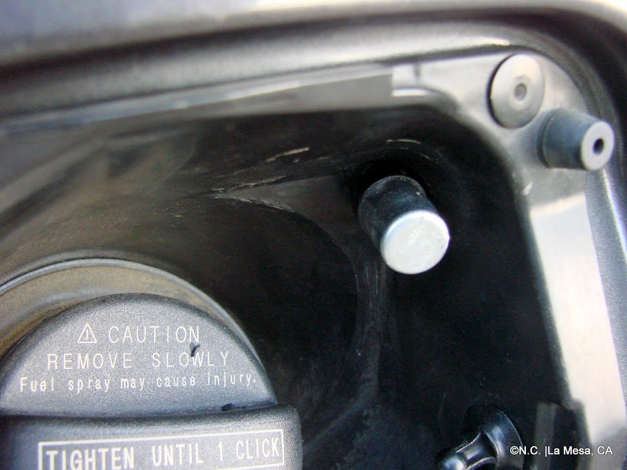

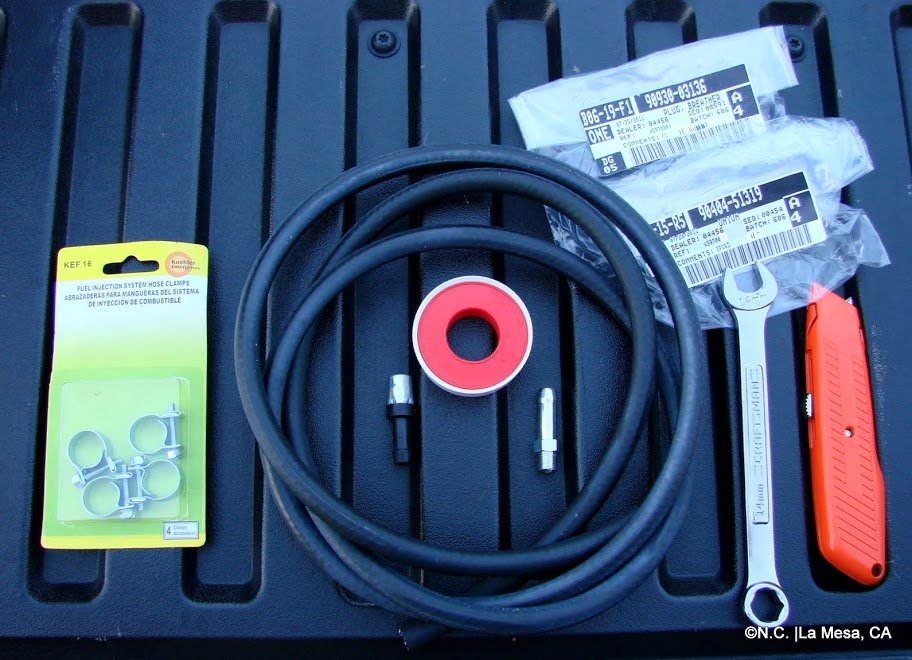

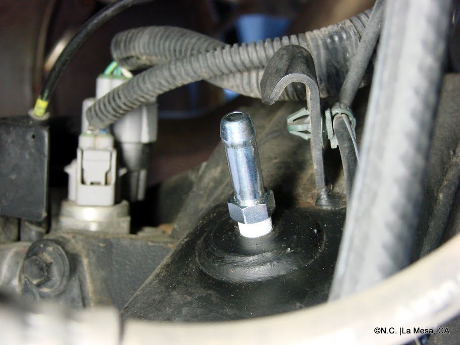

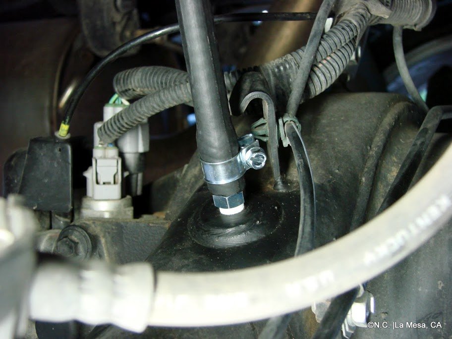

    In July 2011, I installed a rear diff breather mod. A real easy-low-cost mod to protect the rear diff from water intrusion. It's been 100% maintenance free from the day I installed it.
    Parts:
    Installed a fitting in the rear diff housing:
    hose installed:
    New vent installed by gas cap. Done.

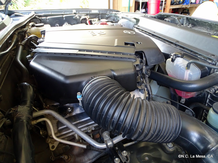

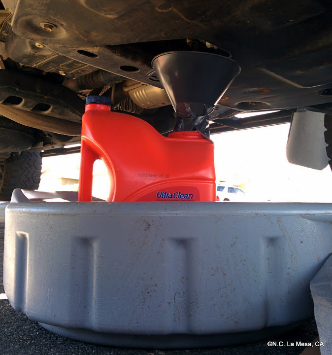

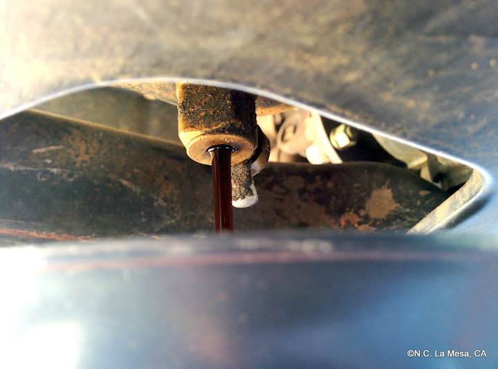

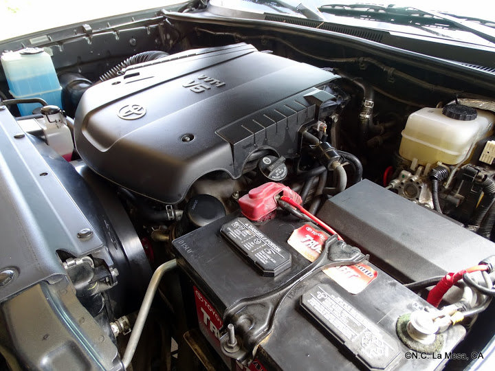

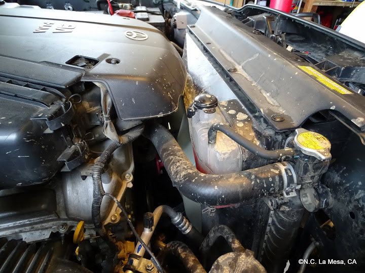

    I decided to do part of the 60K mile maintenance a little early.
    • Cleaned engine bay
    • Cleaned Throttle body
    • Cleaned mass air flow sensor
    • Swapped in new Denso plugs
    • Parked on my front lawn and removed 10lbs of mud from frame with garden hose jet sprayer. :D
    • Changed oil and filter
    Fumoto Oil drain valve in action
    Did not spill one drop!
    Mud mess, everywhere!
    All clean!
    All clean

    How's that Fumoto valve? I was considering one, but it got mixed reviews (granted from people that aren't too familiar with doing their own maintenance)...
